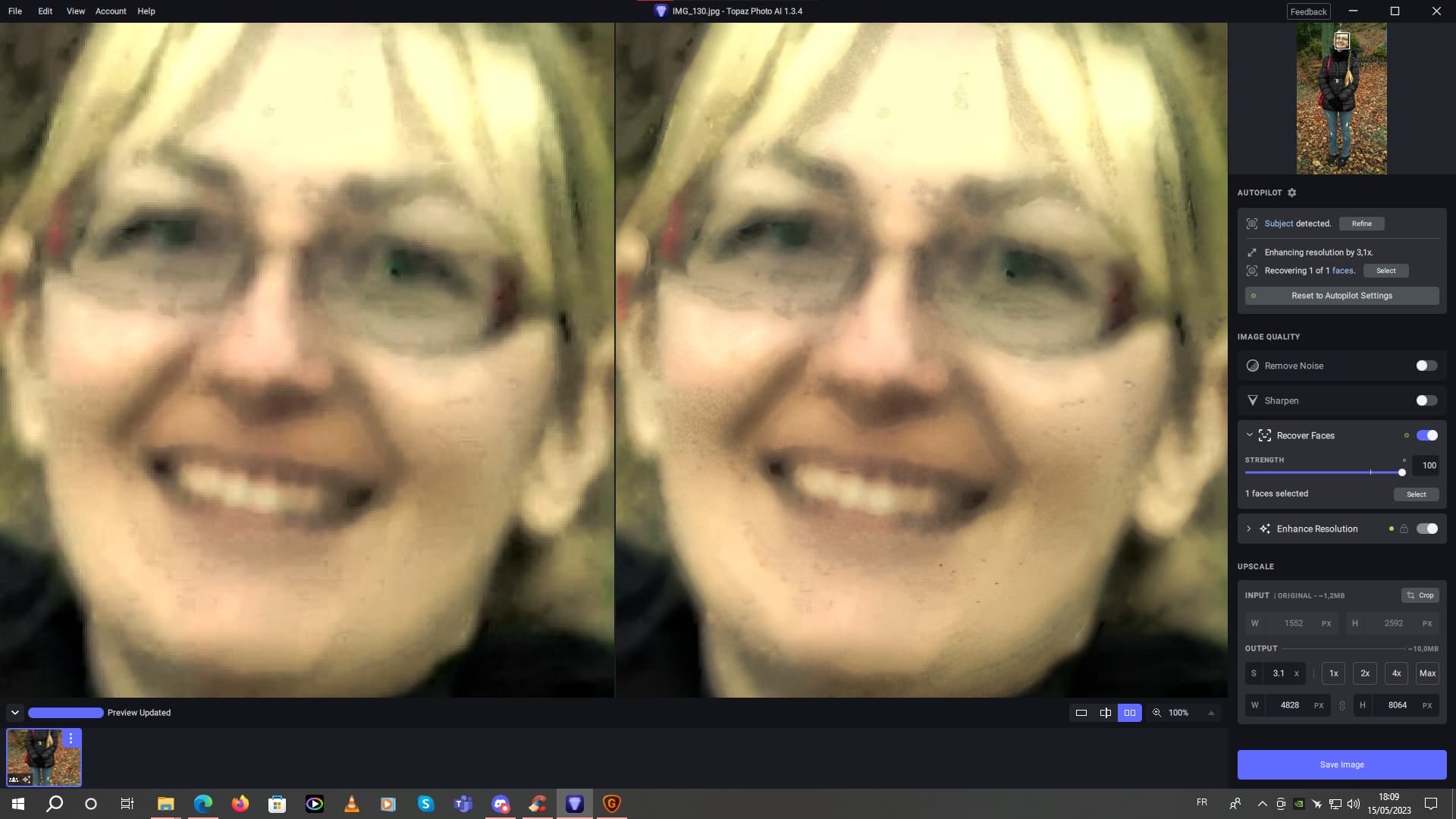

FWIW to get face recovery to work under Win10 on this image I had to switch off Recover Faces then back on. Without that only the remove noise worked.
Seems like it was released a bit too fast, maybe we get the fix today.
That’s a good idea. I tried switching it on/off too. Unfortunately, it didn’t fix the problem for me. I also tried turning on/off noise removal and sharpen. I tried changing CPU/GPU settings too.

After restarting PAI on my system the face recovery would not work again (I usually hibernate the system so PAI is rarely restarted). No amount of switching on/off face recovery would make it work. Changing the enhance resolution from 4x to 2x made it work this time. There appears to be some issue with the size of the PAI window, resolution and face recovery. With higher resolution settings and a smaller PAI window the preview is not getting updated. Changing the preview size to less than 100% also helps.
My system is Win10, Xeon W2123, 32GB with Quadro P2000 at 2560x1440.

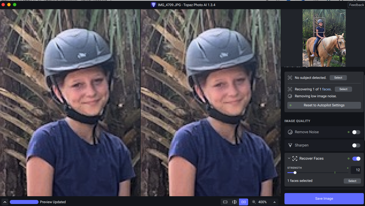

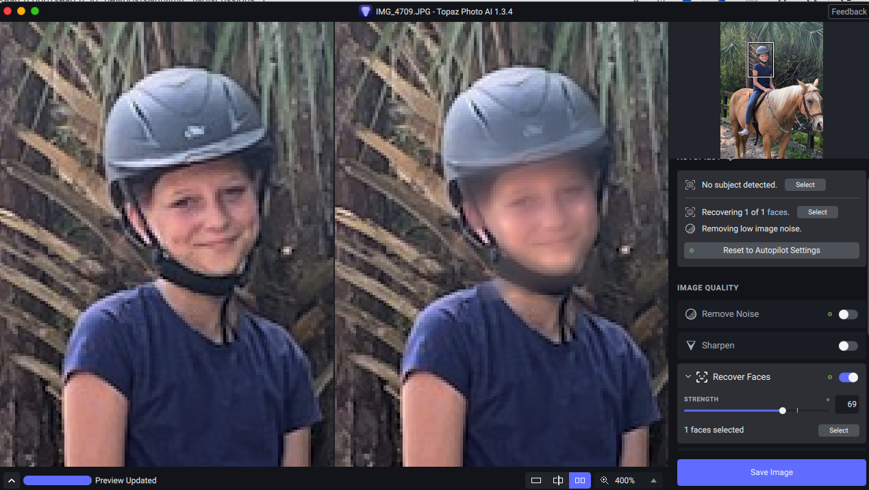

I tried your image on my Macmini M1 w/latest Ventura and it initially didn’t work… I switched off Subject detection and it worked… then I switched Subject detection back ON and it continued to work… at that point, regardless of settings, it continued to work… there appears to be something hinky in the way it refreshes…
I backed out without saving anything and started over again, and now it won’t enhance the two faces regardless of what is turned on or off…
In fact, now, after testing… Face Recovery is borked…
I turned everything off, and Face recovery is actually degrading the Face…
This is on an M1 Mac Mini w/Latest Ventura
Additionally, this occurs in both Stand-alone mode, and from the LR plug-in Edit In mode…

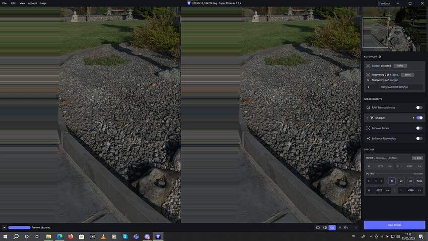

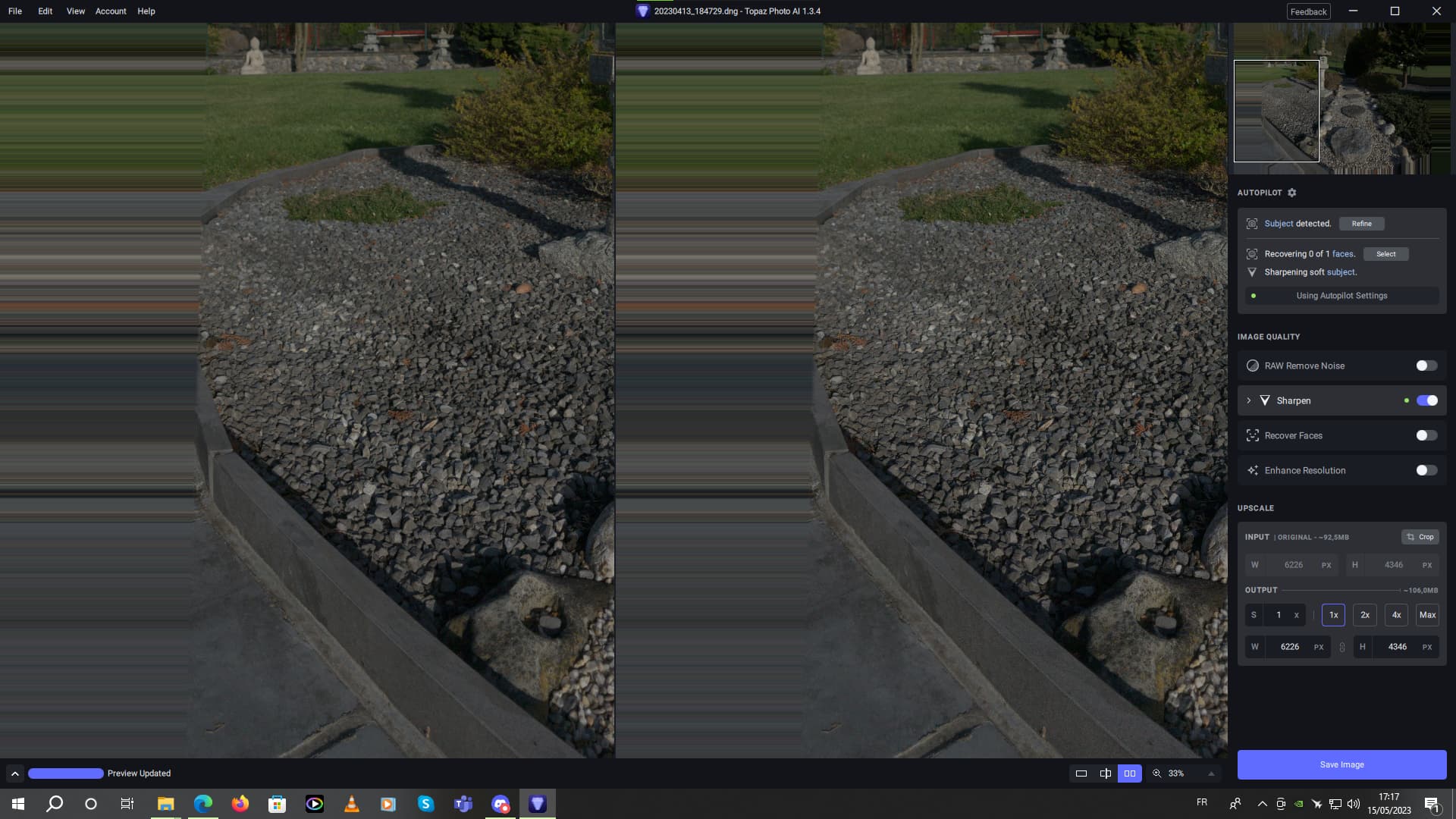

Well, I installed the latest version anyway. The good thing is that I can save DNG files again. The negative point is that I don’t have the new denoise Beta models on the DNG. See screenshot and that the quality is not great with the current models.
Also, the colors are not those of the thumbnail or the Tiff generated by Lightroom if I go into Photo AI without retouching the image.
the 2 images are in DNG. The one on the left is the original and the other one is the output in preserved format
Another black point, the DNG photos of type HDR always have this defect of stretching on the edges.
See screenshot on the right

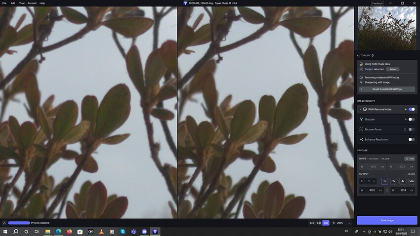

On a jpeg, I can see the new denoise models.
On the Raw ORF files I don’t have access to the new denoise models either. So, it looks like it’s only on non-Raw files. On Tiffs, it works.
Conclusion, since Lightroom, it is always preferable to make open by sending as a tiff file in order to have more possibility. I hope that in the future versions of the software all its inconveniences will be corrected.

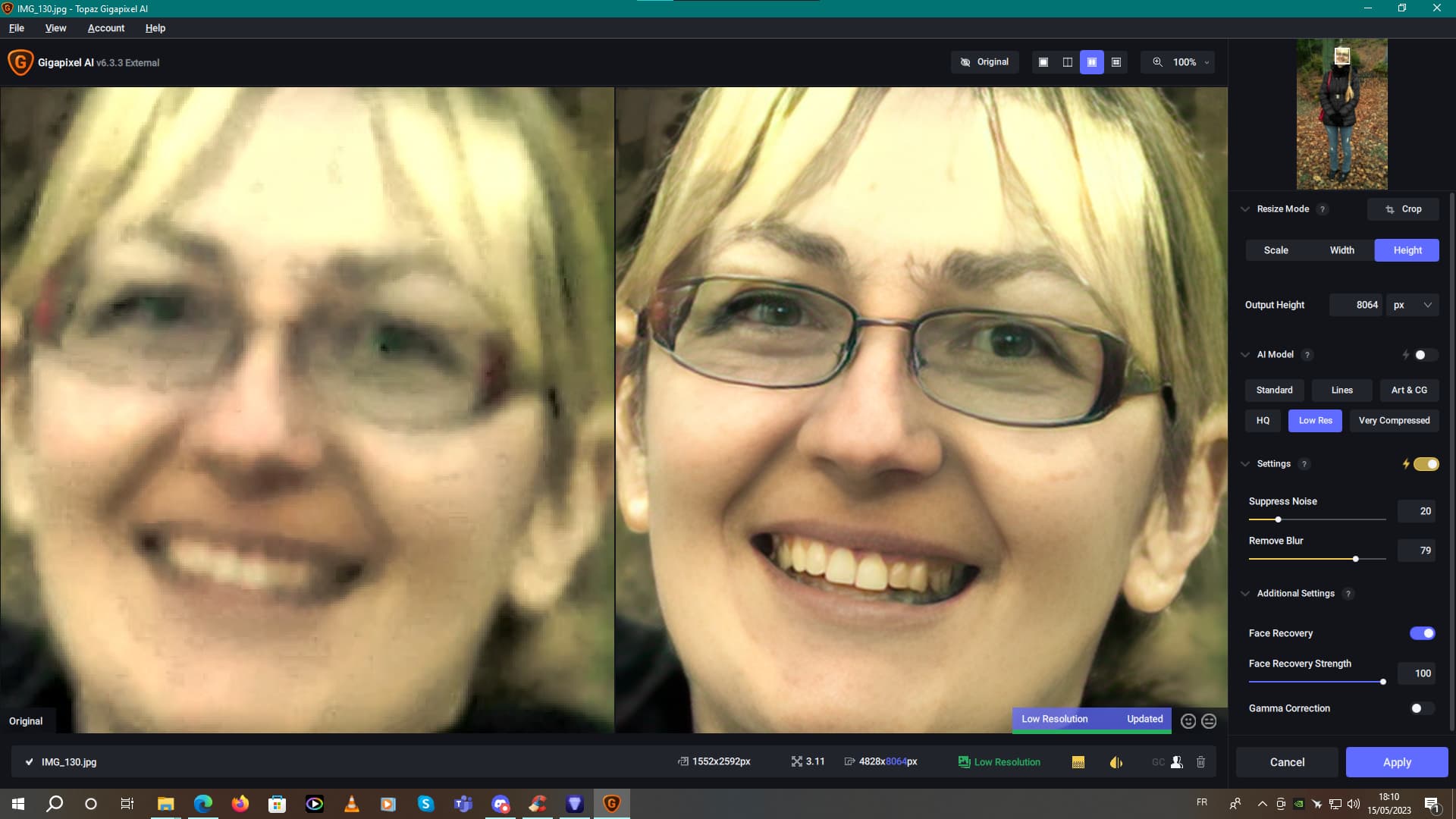

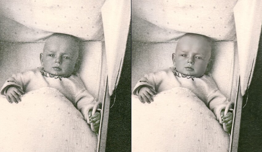

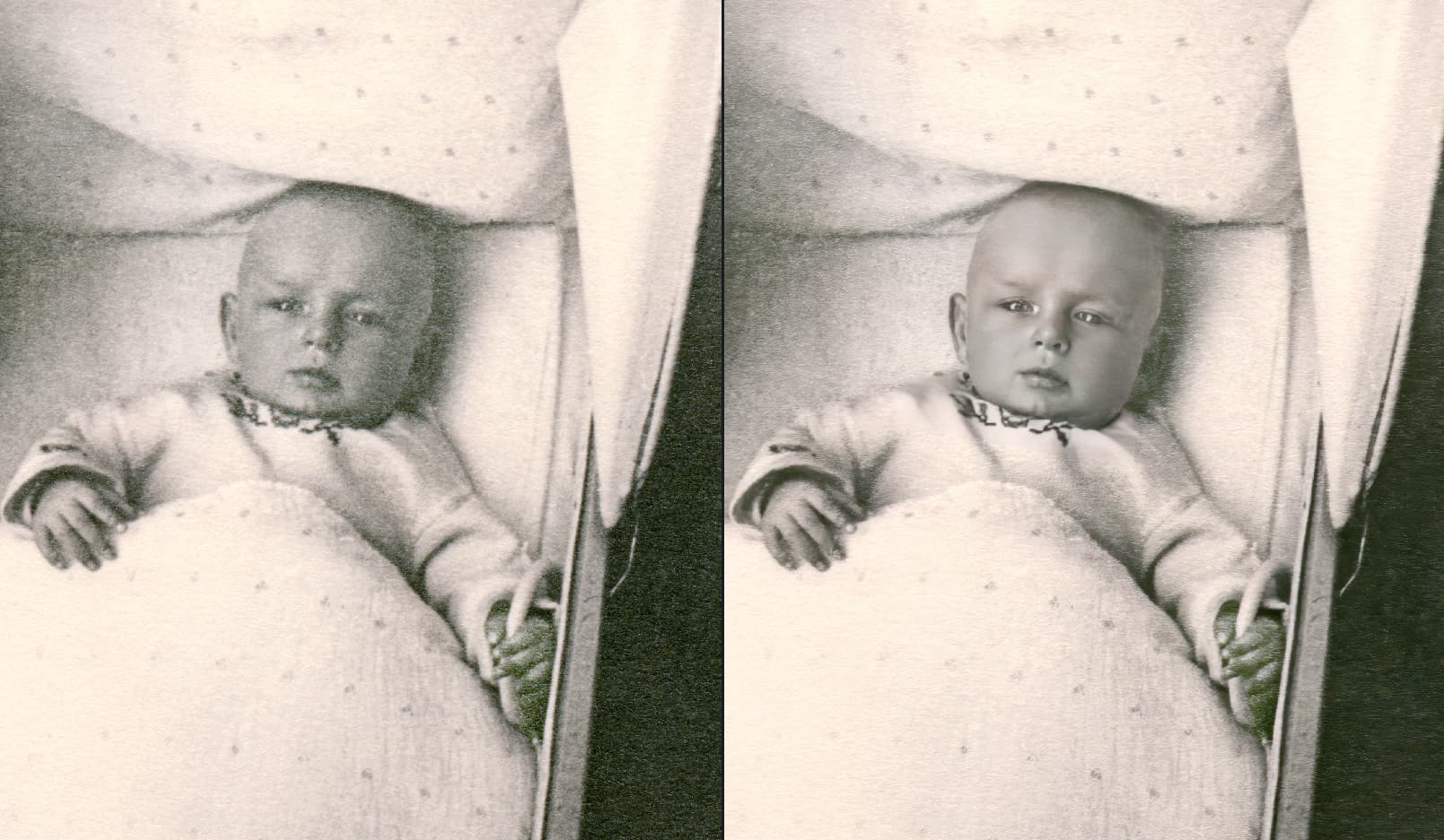

I just noticed that the face recovey tool is much less efficient than the previous version. In 90% of the cases, between the tool activated or not, there is no difference whereas Gigapixel recovers the quality of the faces really well.
Big example here
Photo AI 1.3.4
Gigapixel 6.3.3
I gave the on/off subject detection a try, but it didn’t get the face recovery to work for me. I tried selecting one face or the other too, instead of both at once. I’ve gone through turning on/off other features too without finding a solution.
There’s definitely a fly in the code ointment somewhere. Even for those that got it working on their set-ups, you shouldn’t have to turn features on/off randomly to coax the software into working.
This is frustrating and I hope they could roll out a fix.

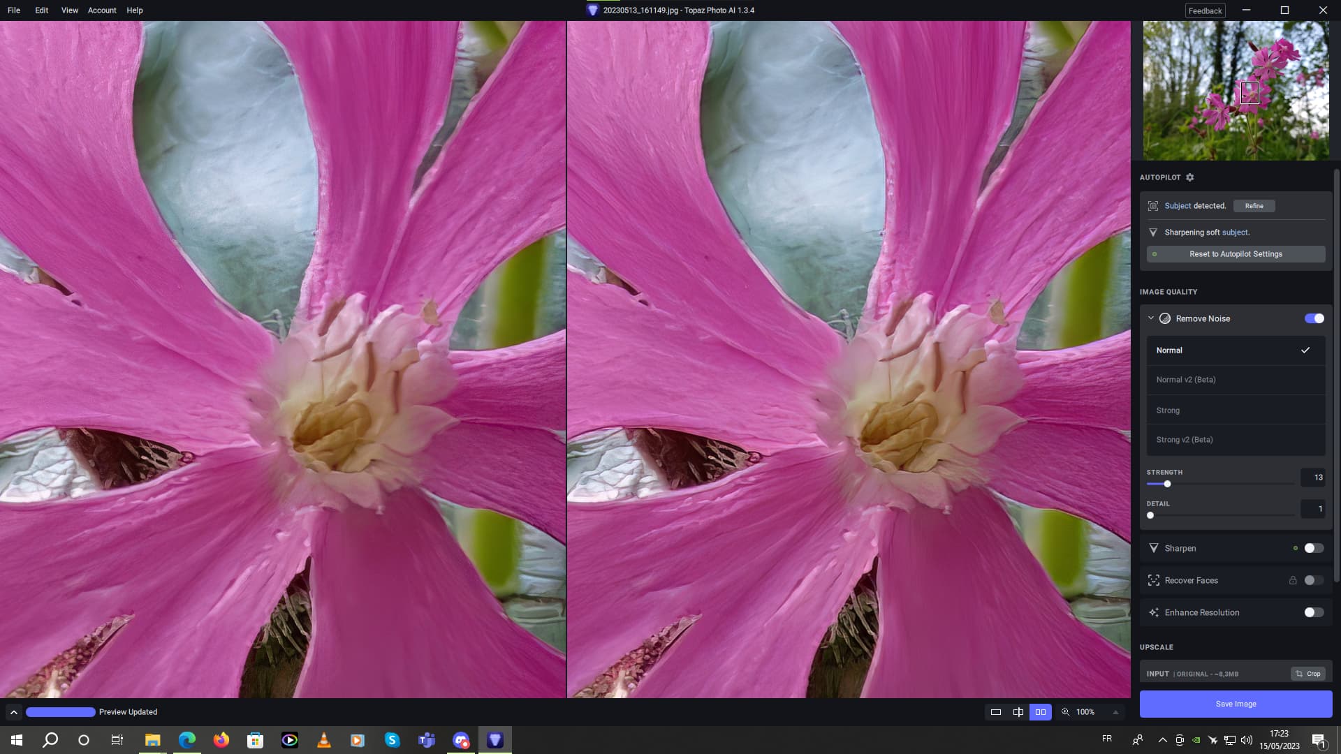

However, the strong Denoising is not satisfactory either, even if I set the strength to 100% (see image):
The area around the face is well denoised, the rest of the picture hardly at all.
Denoising v2 doesn’t offer any real improvement either. Due to the formation of the filaments in the dark area on the right, the quality seems even worse to me:
