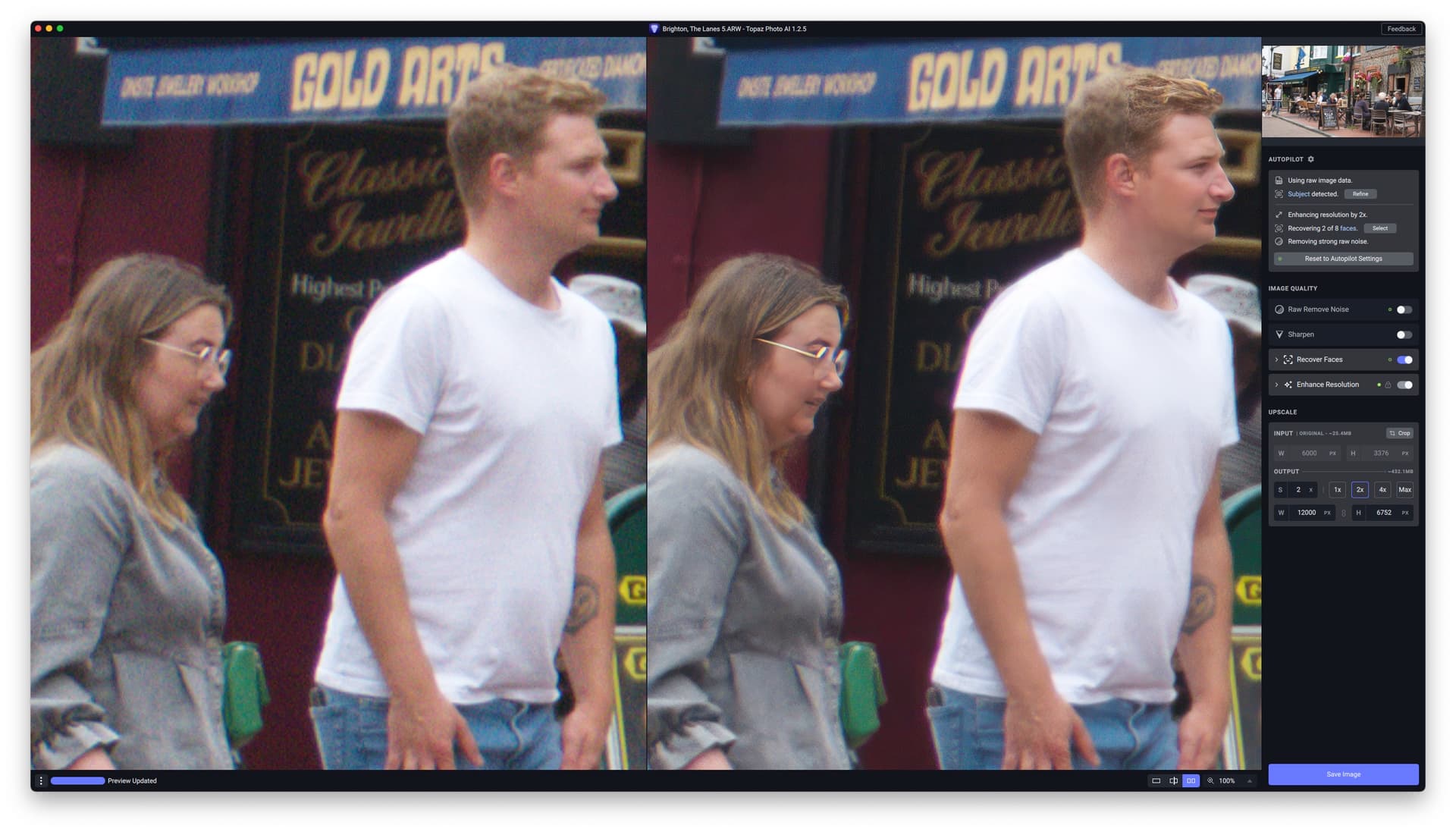

It seems to depend on the image. In this street scene, the faces further away from the camera, which are out of focus, definitely produce a shift.
I didn’t check the difference between vertical and horizontal scaling.
I am using v1.2.5 on an M1 Mac mini with 16GB RAM

You are at 100% magnification in the screenshot. Even then you get misalignment. Try to increase magnification to 200 or 400%. That’s when I get massive vertical scaling errors.

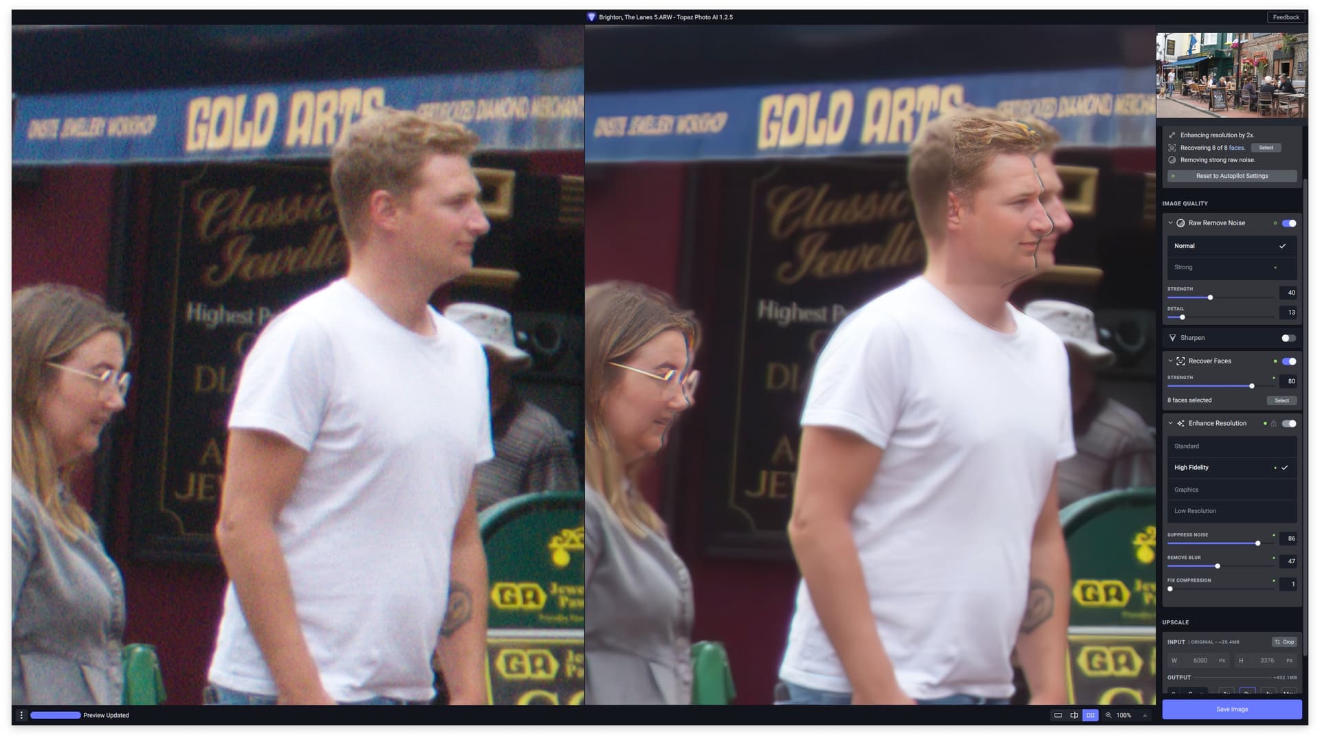

No displacement when noise reduction is off, just the usual issue with hair (esp the guy on the right). Truth to tell, this is not an image I would normally want to upscale or use face refinement on!
Well, as long as it is an image that exemplifies the issue, it doesn’t matter
