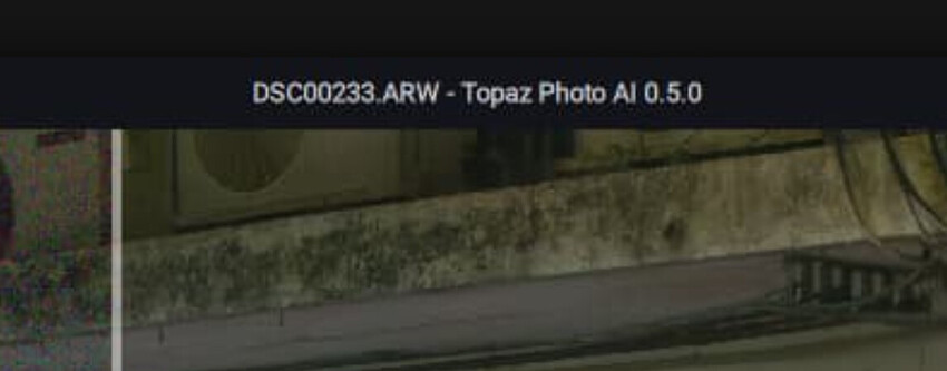

The version is shown on the subject line on the display area:

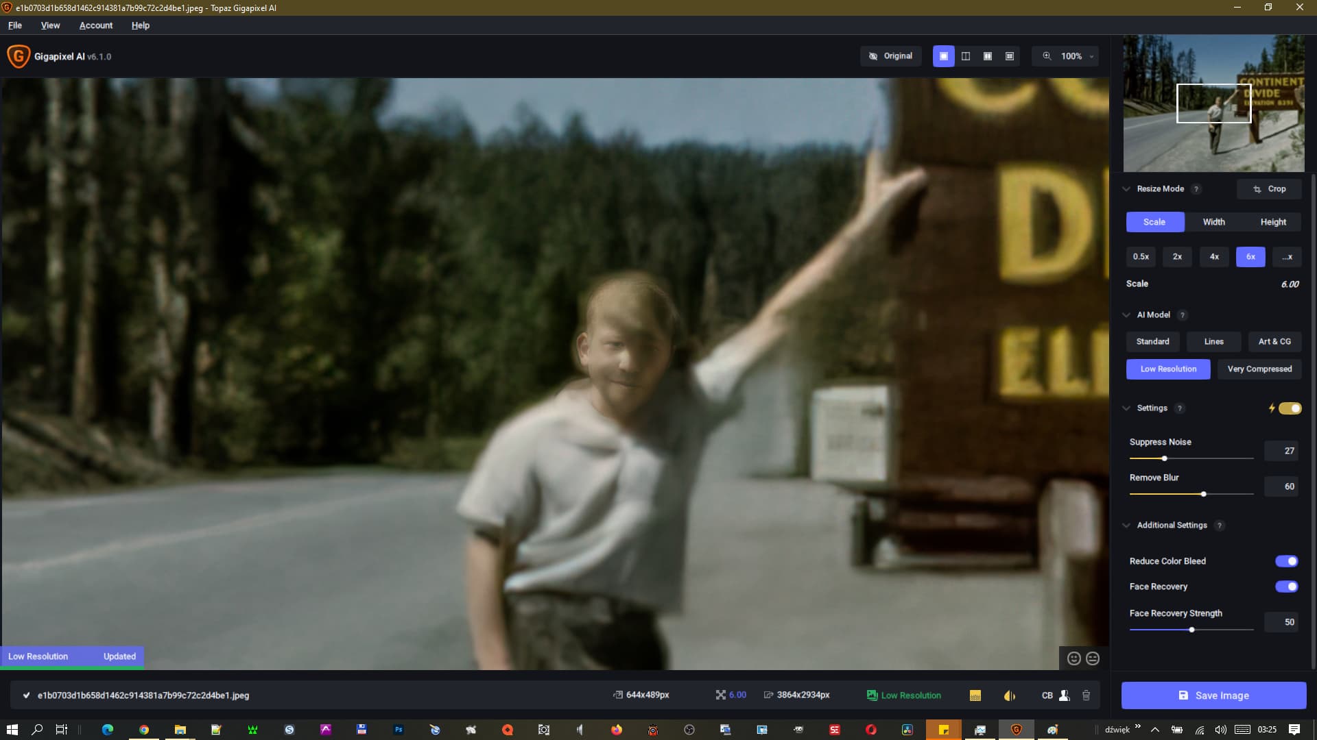

Just out of curiosity, I tried to upscale your image using Gigapixel AI 6.1.0 and it correctly detected and processed the subject’s face. Though the result looks a little bit off…
Face restoration 50%
Face restoration 100%

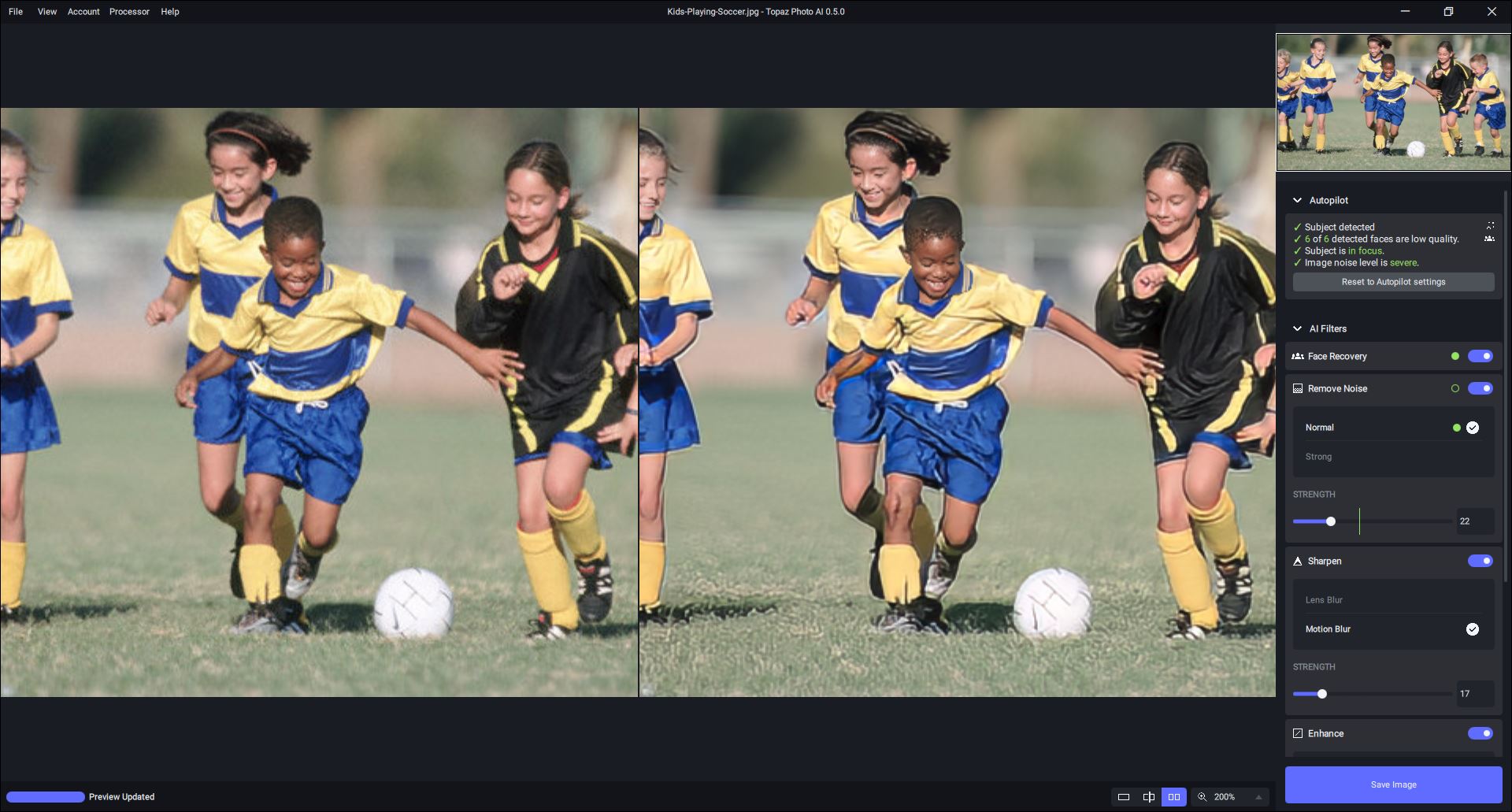

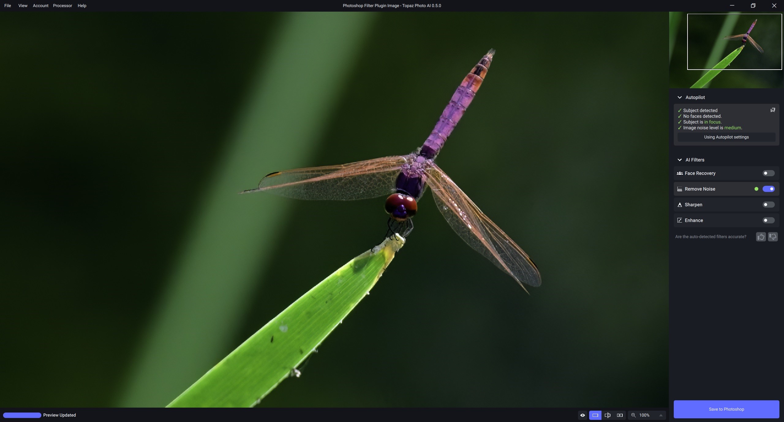

Autopilot consistently states there is “Severe Noise” in the images I’m running. I honestly don’t even think they’re medium noise - I’d classify them as Low Noise. Latest pic tested attached. A-Pilot also always states the images are “In Focus” - I find I regularly want to add sharpening to the Autopilot settings (maybe it’s my eyes …).
I like that when I switch to manual settings there’s a Green Line on the slider spectrum (I’m assuming that’s where Autopilot would place its setting). That’s nice! I don’t have to retain a number value in my head and try to match it to the slider bar as I experiment with different settings.
Autopilot accurately detected the Objects and Faces in this image.
I tried Side x Side View this time - working @ 200%. NOTE: The squiggly worm artifacts that resulted in the Processed Preview pane at right (in the green grass). That’s not good. Nothing resembles that in the pic at left. See labelled snip attached.
RE: the Background - The program mostly retained the bokeh effect, but one horizontal streak got sharpened noticeably. That’s an area I’d mask out to avoid it getting sharpened when a masking facility is added.

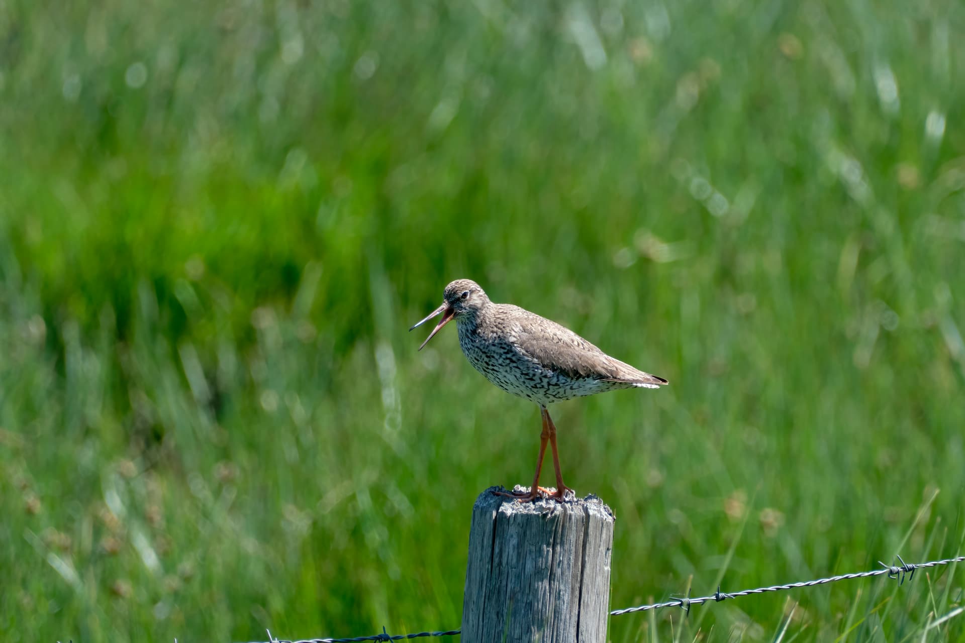

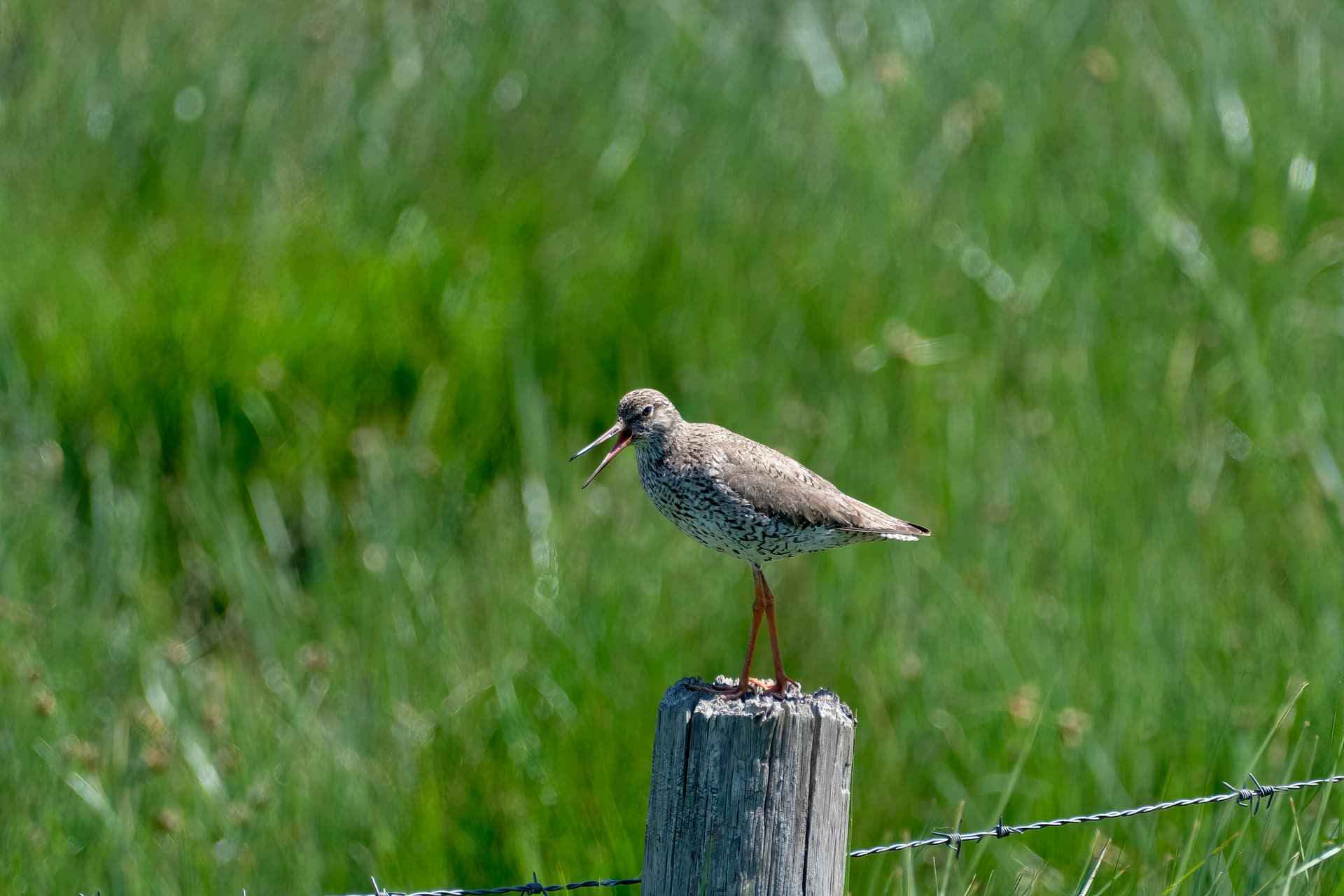

Sharpening in Photo AI is quite problematic generating artificial defects in my pictures. I took the same picture and processed it through Photo AI and Sharpen AI. Photo AI only detected low sharpness, didn’t detect a subject so the whole picture was sharpened. But zoom in at the wooden pole under the bird’s feet. At the left side the structure of the wood is completely changed. Also as Photo AI didn’t detect a subject the bokeh was altered. In Sharpen AI I tested without a mask, the result on the wood is nice.
Top Is Sharpen AI, bottom is Photo AI.
I am using this as a stand alone app right now.

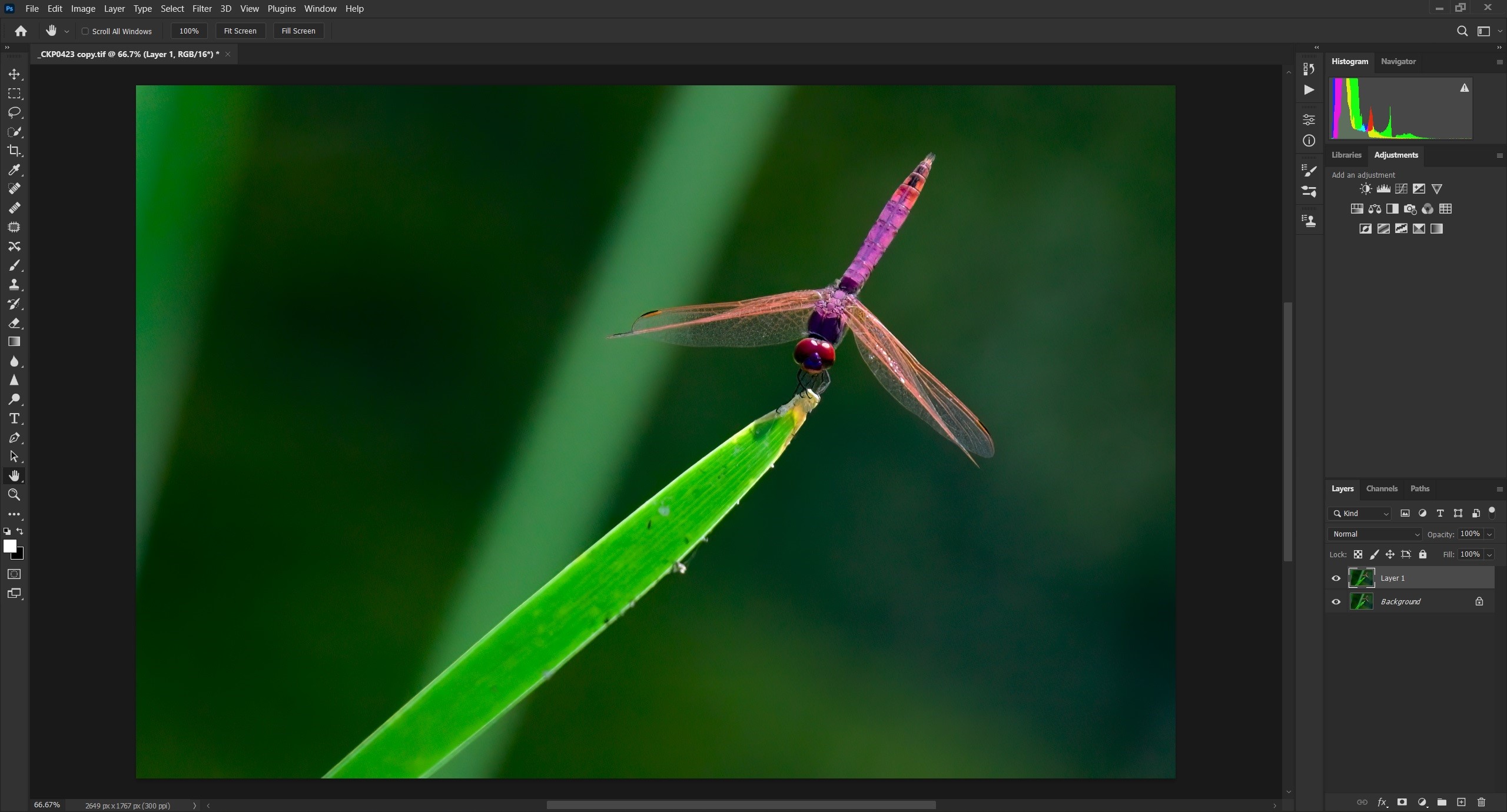

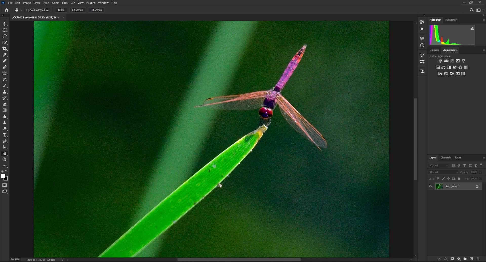

Hi I am seeing that when opening a photo in photo AI that the colors are lost but when it gets back into photoshop the color appears fine.
Topaz would have to address that.
