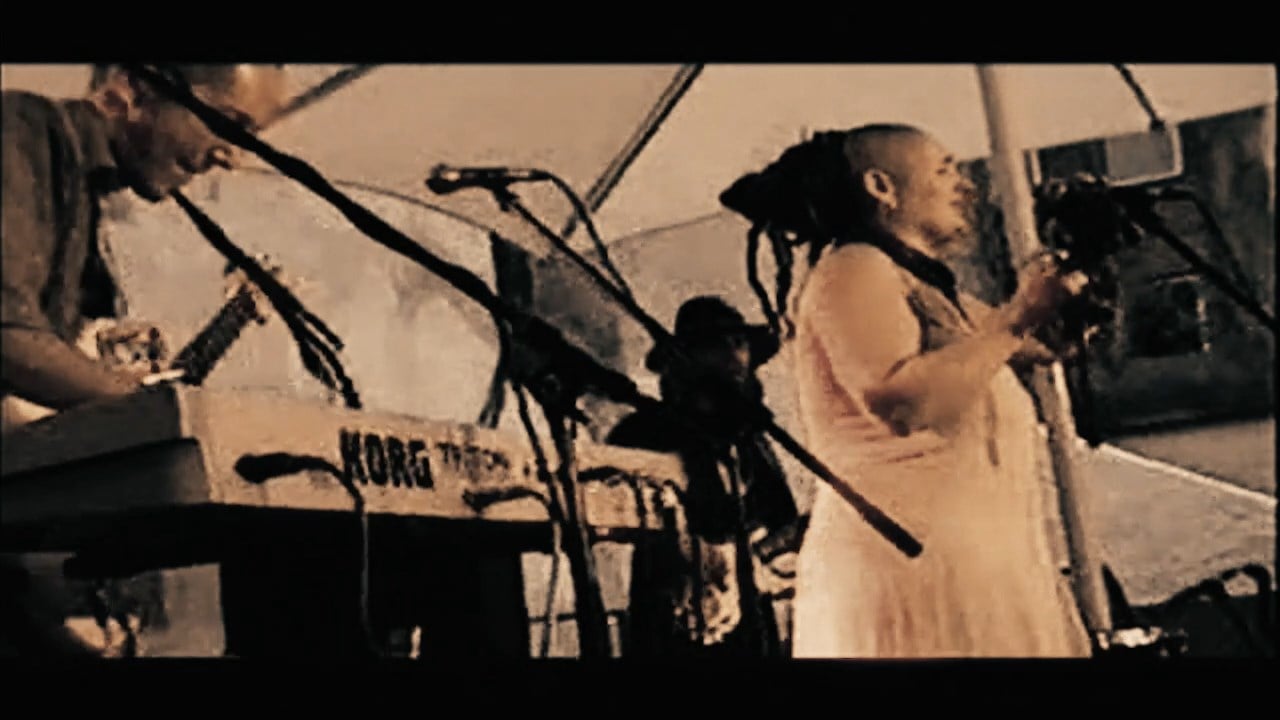

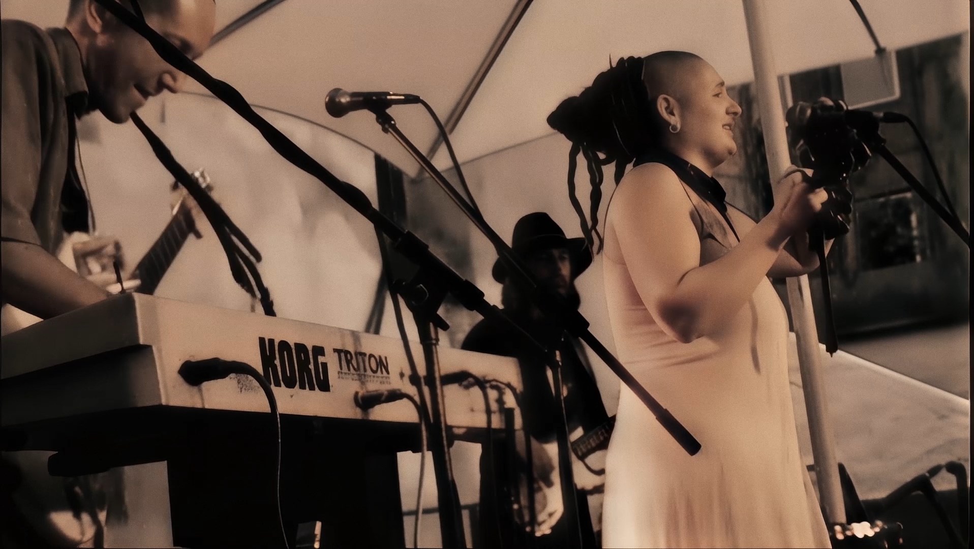

A 16-minute clip took 6 hours of SeedVR2 and 15 hours of Starlight to process.
From this:
To this:
Brother those are just perfect. But after those three what to choose to upscale, cause still watching 480p on 1080p screens or higher its blurry, not as much of course but still
