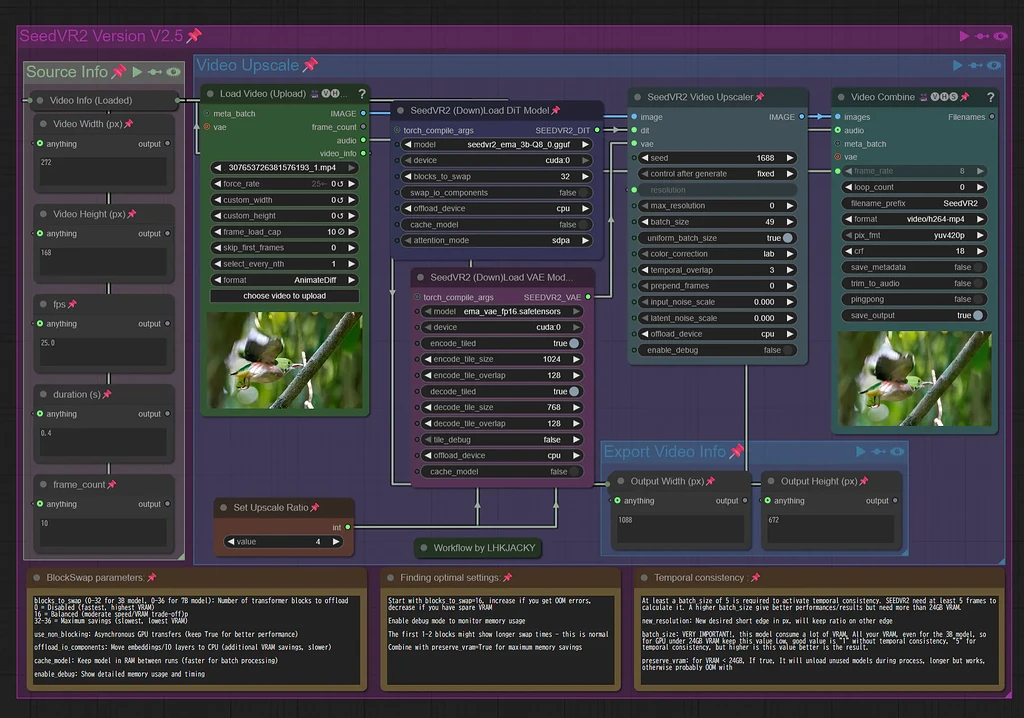

The SeedVR2 Version 2.5 :tada: has just been released today.
You can now download it through the ComfyUI Manager.
I have written an installation guide on my forum.

I installed it and have been testing it since yesterday, but I get a torch error. Torch won’t start. I’ve installed it in many different formats and tried it, but it still didn’t work. I wonder if it worked for you? If so, what are the settings?
torch.compile failed for DiT: cannot import name ‘check_supported_striding’ from ‘torch._inductor.kernel.mm_common’ (C:\ComfyUI\python_embeded\Lib\site-packages\torch_inductor\kernel\mm_common.py)

I haven’t encountered the error you mentioned above. However, I did run into some other issues when enabling torch.compile. I managed to resolve them after some debugging.
Since it’s a brand-new release, a few bugs are to be expected. I’d recommend disabling torch.compile for now—it’s not essential, and I didn’t notice the speed improvements they claim.

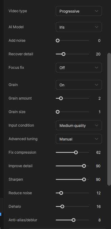

Starlight isn’t faithful to the original video, so I never use it. After SeedVR2, I use Iris for processing, which gives better results. It’s also faster. And you won’t get plastic faces.
For each new video, click “Estimate” again so it finds the optimal settings for the video. Then, set “Improve Detail” and “Sharpen” to 90. I use “1” for the “Grain Size,” but you can also set it to 2 for larger videos.
