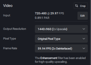

I tried a few things, but my computer is doing another movie right now, so it was too slow to keep testing options.

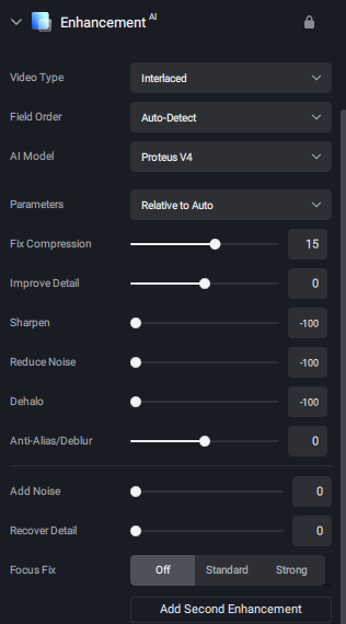

I got somewhat acceptable results with these:
and
The faces did look a little warped. Maybe a second enhancement with the Iris model would fix that. I’m am reluctant to recommend the Iris model because it can mess up faces in unnatural ways.
