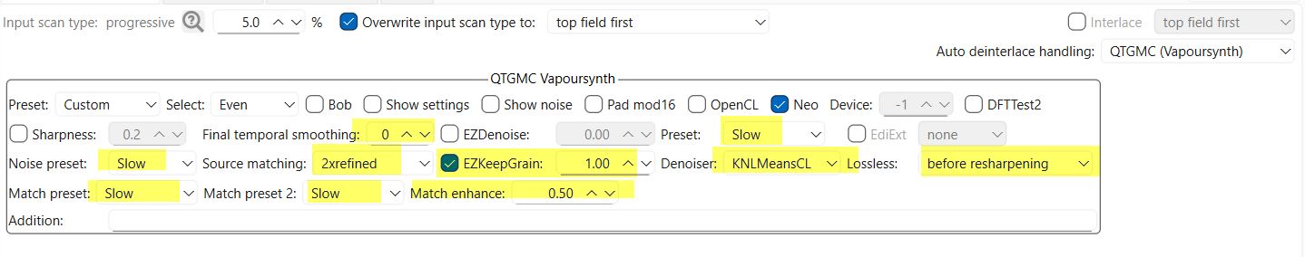

qtgmc loses a lot of detail.. even with the medium profile, or even fast, without temporal smoothing. the deinterlacer that gave me the best quality is muksun with virtualdub, msu is good too. deinterlacing produces the staircase effect but proteus v4 corrects it well, if you use hybrid, export in ffv1 but in avi, not mkv. mkv loses a little quality.
does not with this settings
I agree you need to use the lossless or near lossless setting in QTGMC and it works very well. For “priming” i.e. cleaning up and deinterlacing an SD 50i/60i compressed source it can work well as a pre-conditioning stage before fully “decompressing” and removing remaining compression artifacts later on in Topaz with a HQ intermediate.
