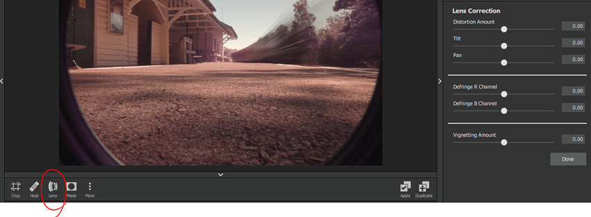

Is there an easy way to straighten an image in topaz studio or a plugin to help?
Currently I’m using crop and trying to a line the it with a straight edge in the picture.
I use the crop tool too … there are also lens correction tools that can be used. I don’t find it terribly easy to use these though

Like Shazzy said, you could use Tools > Crop & Rotate menu in Topaz Studio. Though it is klugey, you can make it work.
I’d suggest you use the Rule of Thirds lines in this tool set as your guideline for straightening (either to check a horizontal ‘Horizon Line’ or a vertical upright - like the side of a building).
Just pull one of the outer box lines in toward the “line” in your photo that you want to be sure is straight - as if you’re going to crop the image (but you aren’t!). Once whichever of those outer box lines you’ve pulled in is touching one end of the “line” you’d like to be straight then move your cursor out a bit to be able to use the Rotate functionality. Pull or push your image in whatever direction lets you make sure your entire “line” falls along the outer box line that you’re using as a reference.
When you’ve done that, pull your original Crop line that you’re using as a straight line reference back out to its original position so you don’t end up cropping out content you want to retain.
Then hit accept or move on to the next stage of your processing. It’s not an elegant (or the easiest) approach. It certainly isn’t automatic. But it will work! Good luck!!
It might be easier to use the Angle slider in the Crop and Rotate tool, instead of dragging with the mouse - once you’ve got the number in the box highlighted you can rotate more accurately with the up/down arrow keys (add shift to move in multiples of ten).
