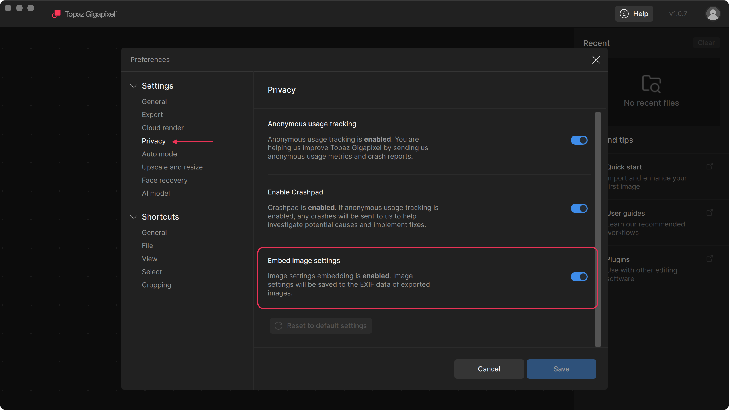

Does this preference suite your needs?
I am not sure when this was officially implemented. The details of the applied settings will appear in the “Description” or “Image Description” metadata field depending on how you inspect an image.
For slider values, they’ll appear as decimal values between 0-1. To get the same value you’re see in the UI, 100x the value and round to the nearest whole number.
