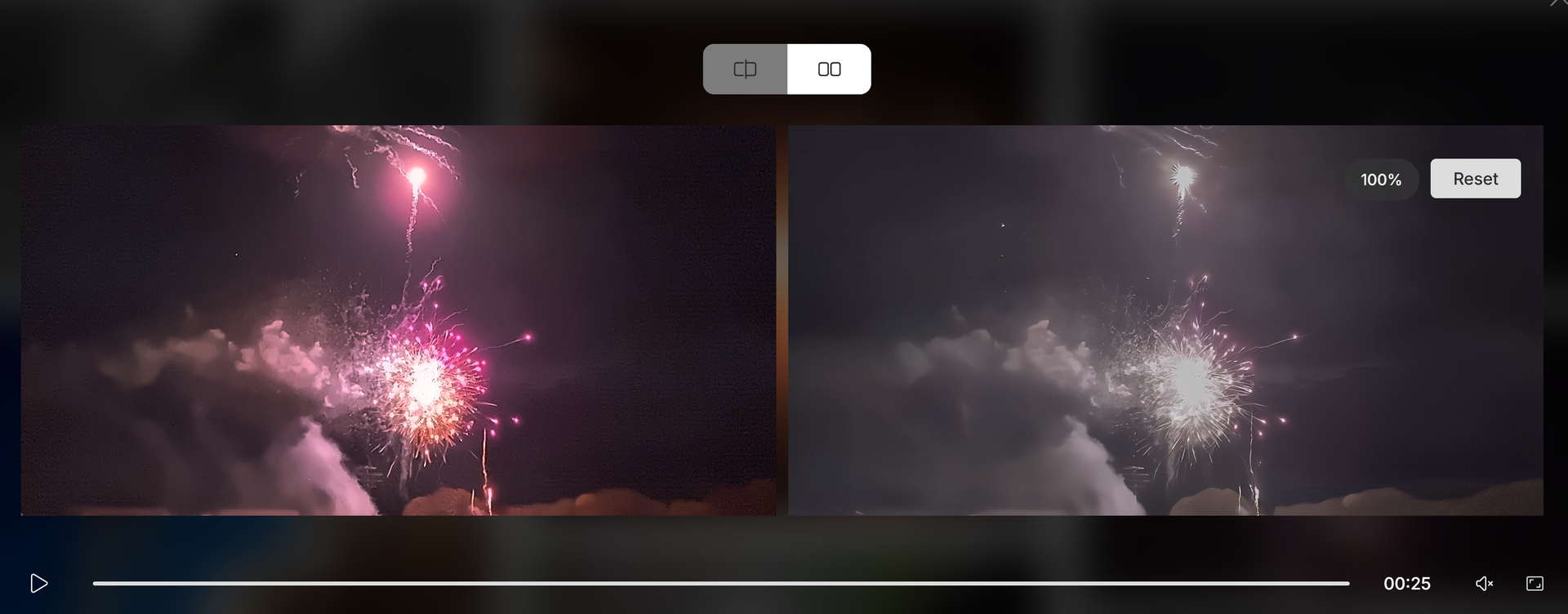

Also i noticed on precise mode, it seems to dumb the colours down?

Regarding the color issue, can you share a screenshot of the input vs output?
this is PRECISE 1 but precise 1 and 2 both dumb down the colours, it is quite a difference in colour, if you look at how bright the fireworks were in the original VS the 4K output on the right side, this was upscale from 1080p left side to 4K output RIGHT SIDE, I wish there was an option to enable “vivid colour enhancement” to keep the original colours or make them better
Can you email in and send a request ID number for a file ran within the last 7 days so we can take a look?
If you don’t have one available within the last 7 days, please share the input and output files with us.
