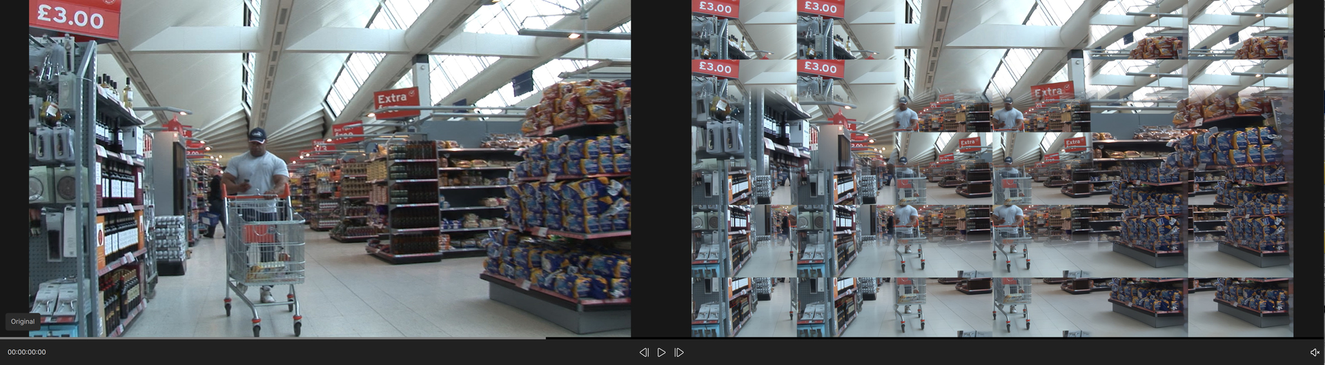

Stab is producing a "tile effect" after updating to MacOS 27
Just discovered the next Stab error :grin: :

i have the exact same tile effect tiled preview results when activating stabilisation full-frame, only with full frame this tiling happens, and not with autocrop. have a 27.01 mac osX
 not that it makes any difference here. if there is a fix to download, please let us know, seems there are many many many people with this very same issue, but using different wordings instead of tiling tile effect hence there are many threads here discssing the same issue though.
Topaz Video desktop v 1.7.1 on MacOS Golden Gate 27.0, running on a MacBook Pro.
The use of Stabilization results in a completely garbled video.
Can you grab the logs and either screenshots or a small sample of the garbled output to share with the support team at help@topazlabs.com? This way we can get that in front of the devs for further review, as we are aware of some tiling issues that are being looked into.

Hello !
I have the same issue with Stabilization with latest version of Topaz and MacOs. Just with the Full Frame setting, the Auto-Crop is working fine.
It was working well few month ago but then I did the update (MacOs and Topaz) and It stopped working.

Hello,
We have the same issue reported in this thread: Stab is producing a "tile effect" after updating to MacOS 27
Since updating to macOS 27, Stabilization in **Full Frame** mode produces a tiling / “tile effect” in the output. **Auto-Crop** mode works correctly.
**System details:**
- Mac with Apple M5 Pro, 24 GB RAM
- macOS 27.2 (the issue was already present on 27.0.x and the 27.2 update did not fix it)
- Topaz Video 1.7.1 (also tested 1.6.1 and 1.5.0 with the same result)
- Model: Stabilization ref-2, Full Frame
- Source: Canon H.264 1080p 50 fps MP4
We use Full Frame stabilization professionally for event videos, so this is blocking part of our workflow. I can send logs and a sample clip to help@topazlabs.com if needed.
