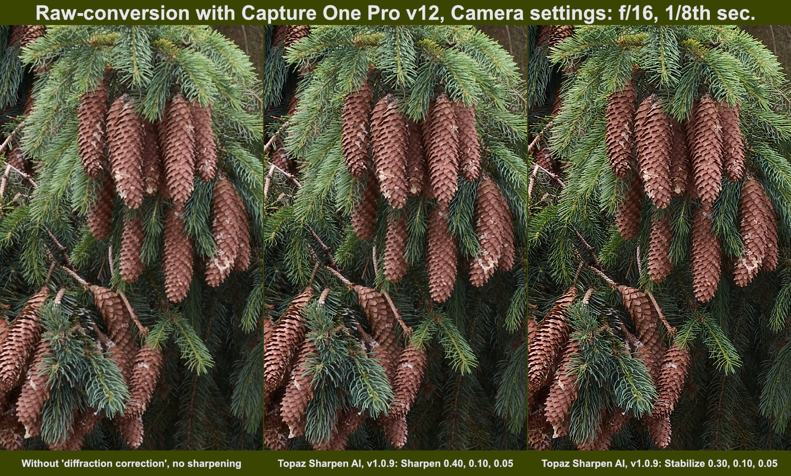

Here are 2 comparisons, based on the same image-crop. The image was taken on a sturdy tripod, but an aperture of f/16 was used. That narrow aperture caused diffraction blur (with resolution loss) and, additionally, a tiny bit of subject motion blur (despite my trying to shoot when the wind induced subject motion was at its minimum) was caused by the required exposure time of 1/8th of a second.
The first is a straight Raw conversion with an excellent Raw converter without any additional sharpening, with first a Sharpen mode correction and then a Stabilize mode correction applied to that crop. Here they are, side by side:
Click on the image to view it at 100% zoom, and make sure that your browser doesnât zoom in itself. Maybe itâs better to download the image and view it in an image viewer or editor at 100% zoom setting.
Due to the softness and resolution loss caused by narrow aperture diffraction, Sharpen mode already produced a significant improvement, but removing the tiny amount of subject motion blur with Stabilize mode helped it a bit more.

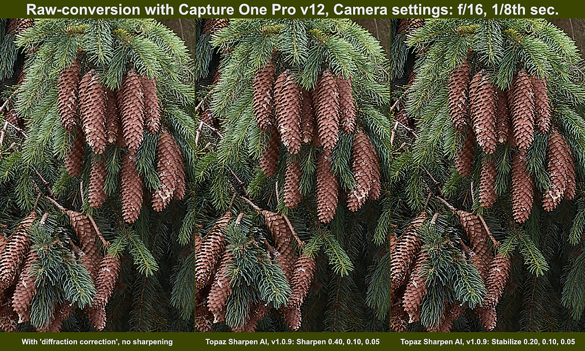

The Raw converter I use also offers a feature called âDiffraction Correctionâ, which usually does a very good job of applying automatic Deconvolution sharpening (like the Topaz InFocus plugin does), to compensate for the diffraction blur. I also used that as a Raw conversion, again without adding any additional sharpening.
This time, the Raw converter already took care of most of the Diffraction induced blur. Therefore the subsequent Sharpen mode adjustment only produced a tiny bit of additional sharpening, as it should. By using the Stabilize mode, again a slight improvement was achieved.
This demonstrates that if an image needs more help in regaining the original sharpness, Topaz Sharpen AI will make more of a difference. If that same image is already reasonably sharp, then the gains will be relatively small.

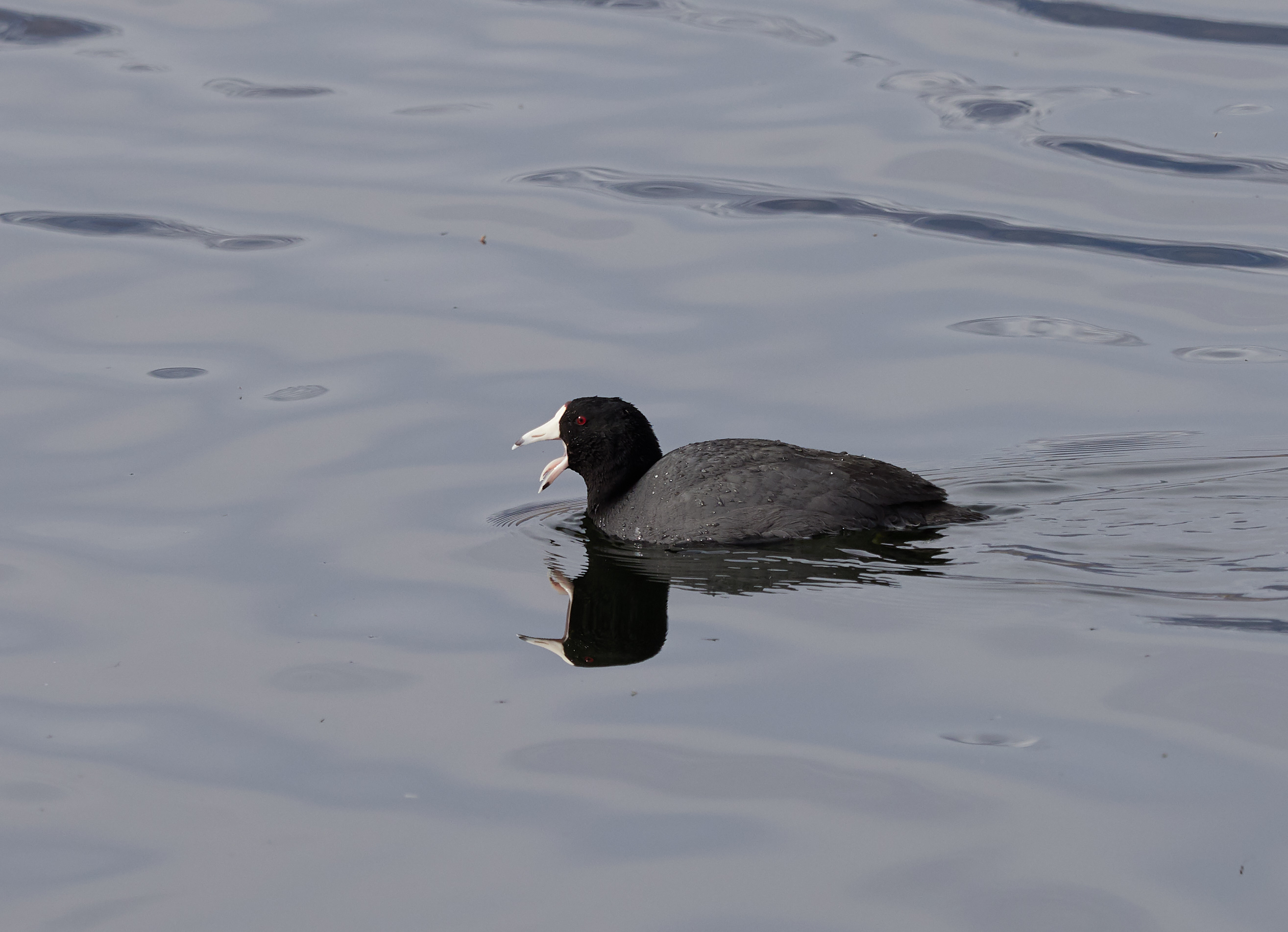

But then, every once in a while, I come across an image that is slightly OOF. Last week we were at a local campground and I had been taking some photos of an American Coot. The birds are all black except for the beak, and that sometimes makes them difficult to get good focus. No contrasting colors unless you get the focus point exactly right. I took some photos of one gliding along on the lake and it came out slightly OOF. Here is a crop of the original photo:
Here is the same photo after being run through Sharpen AI:
This is also an example of the issue you talked about before. I only wanted the bird sharpened, not the water waves around it, but Sharpen did all of it.

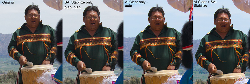

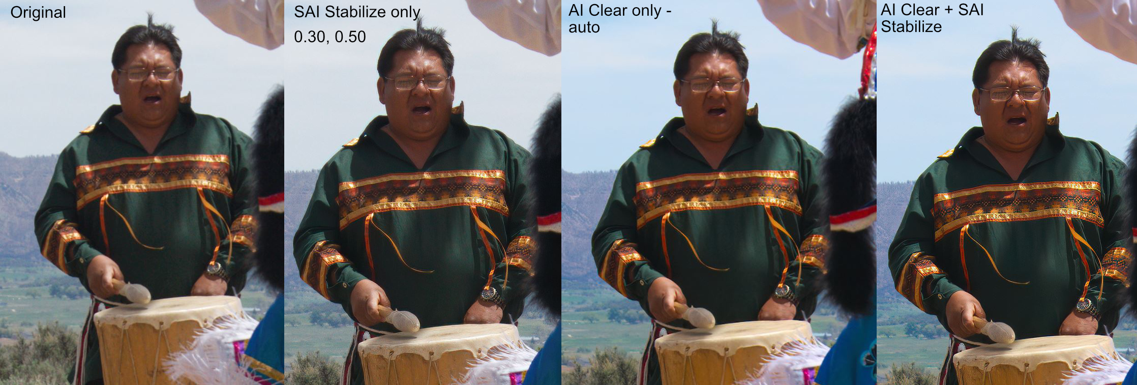

I ran a test of AI Clear, Sharpen AI (SAI) and those two combined. Below are the results. You can clearly see that the overall best is the combination of the two but this may not be needed on many photos. This was a hand held photo at 1/500s using a 18 - 250mm zoom 16Mpx shot. This is a small section crop at about 82% enlargement. SAI Stabilize only would have probably been a bit sharper at 0.5 instead of 0.3 but I didnât want to over sharpen. Also, the camera focal point was on another subject closer to me.
