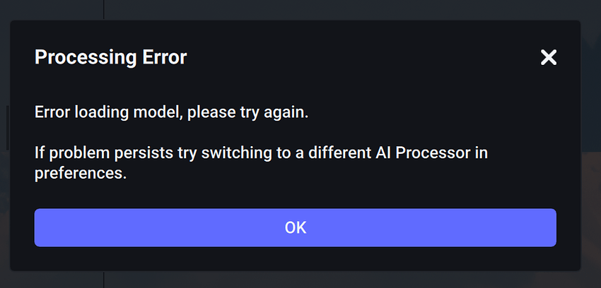

Had many issues with Lightroom Classic or Photoshop plugins on the beta or the releases and this has been quite annoying. This time Sharpen in both LR and PS crashes, flickering, with the following message.
Processing Error, Error loading model, please try again. If problem persists try switching to a different AI processor in preferences. I have to force quit Sharpen every time.
I uploaded the full version and it is the same issue.
The message to load the plugins into PS comes up fine and there seems to be no problem. Same through Help. However the plugin crashes. The standalone Sharpen works fine.

I restarted my computer, closed the apps, same problem.
