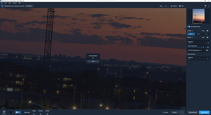

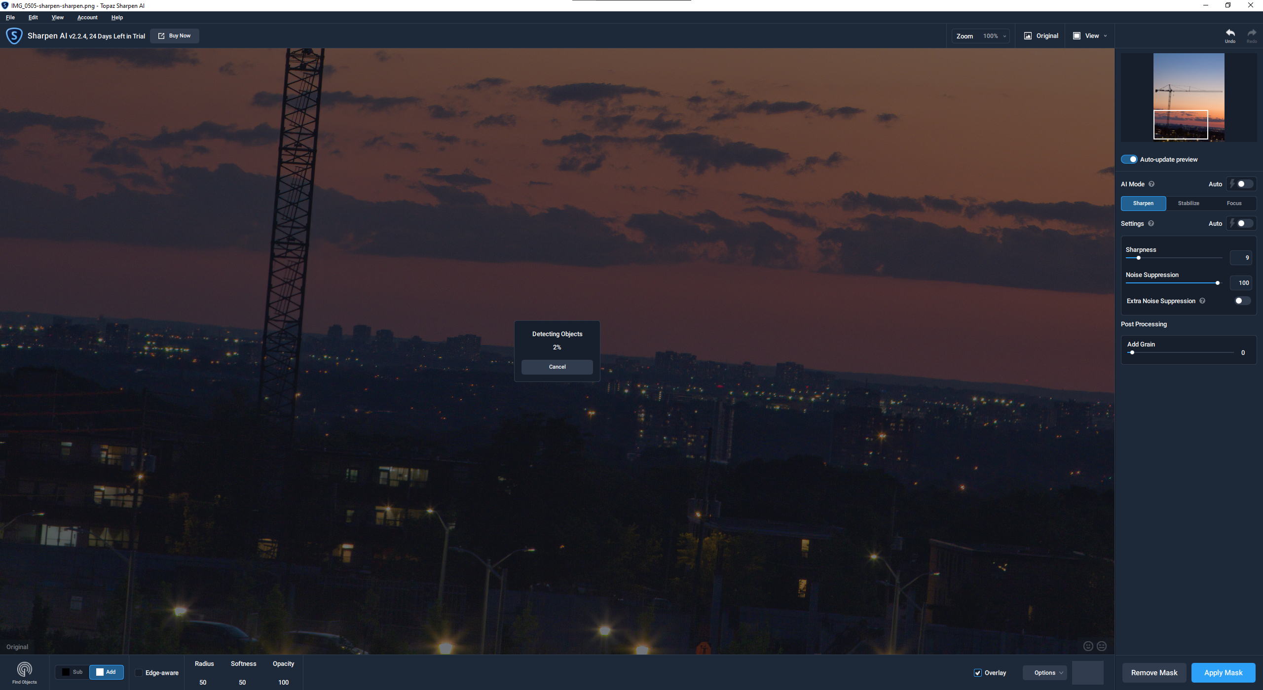

So no matter what I do I can’t get this Detecting Objects dialogue to go away. It pops up 2 seconds after I click the Mask button (i dont click anything else) and it just stays there. If i press cancel it doesnt do anything. Happens with every image. I have to use task manager to force close sharpen AI. I dont see any options in there to turn off auto detect and I’ve uninstalled sharpen ai several times. I’ve also tried deleting any folders I could find associated with it as well. For example in my user appdata folder and the installation folder. I can’t seem to find anything about this issue on the forums.
Also I notice my CPU is hovering around 15% usage when this happens as well. And it stays that way until i force close the program
You have Find Objects active, click on it to turn it off.
When I open the mask tool, find objects is not highlighted, and this detecting objects still pops up and gets locked. If I click the find objects button it turns to a highlighted icon but the detecting objects dialogue is still froze at 2%. This happens with portrait shots with people as well it. If I click remove mask while that dialogue is up, it closes the mask menu but the dialogue stays on screen and ihave to force close.
Ok I changed my gpu to OpenVino and then clicked mask and for some reason this cleared the error. I was even able to switch back to my rtx 3080 without problems. So strange

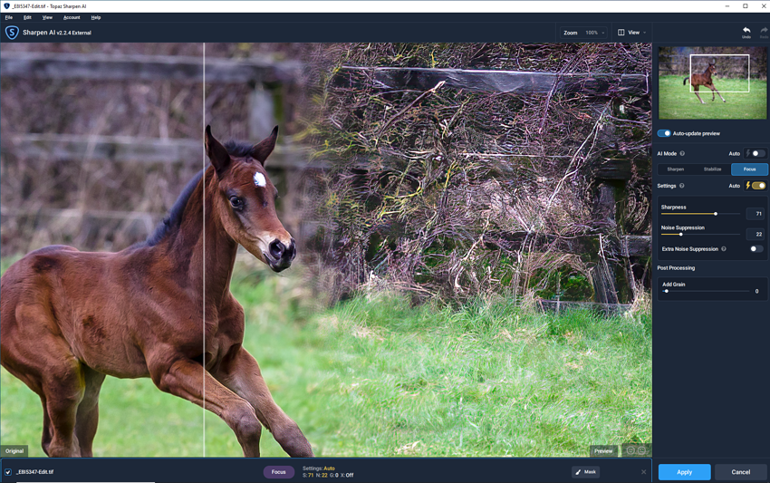

You need to use the mask tool and only sharpen the colt. The background is out of focus and needs to stay that way.
Of course, that’s an option. But the other modes don’t show this kind of behaviour. Additionally, when zoomed in it is too easy to miss such artefacts (although this is extreme)…
IMHO, this does not sound like a workable approach unless he makes a really precise mask. Otherwise, say, he wants also to decrease noise, and as the result will have different noise in masked/processed and not processed areas. Taking it simple, the program produced an artifact in the area where it definitely was not expected. Well… The AI is not as good as the real I.
@ivkuzmin Exactly.
