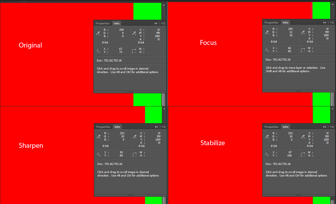

Hi Adam, There seems to be a marked color change, I wont say shift, during processing. You can see the difference between the Original, top left, and the three processing modes … which are different from each other:
The original is just a test image I use because it has solid color in each column with no change in RGB values, its only 600x400 so you can download from here and check processing … Auto was used for all:
Just so you know, I can also replicate this in version 2.1.8 as well.
I don’t see the exact differences between processing types you did, but it is somewhat dependent on where you take the sample. There is a gradient of values near the boundaries that eventually stops changing after you get into the bulk of the solid color area. Apparently the software is homogenizing the local color based on the neighboring colors, and this is having an overall influence even at a distance from the other bulk colors.
If you put the three different processing modes on different layers, and set them to difference mode compared to the original you can clearly see the color transition zones at the boundaries.

My guess for this is there might be slightly different behavior depending on how big the image being displayed is. I will take a look at it.
I talked to @partha.acharjee about this and he can correct me if I missed something or said something wrong.
The summary is that the network needs to do work on the image and it will change it slightly no matter what. We also do do some color correction to fix grid artifacts which may shift stuff slightly as well. The color shifts noted (at least on my screen) are not perceivable outside of the color picker values though, so I think this isn’t a major issue. However, if you find any very noticeable color shifts on non-solid color images we would want to take a look at that.
