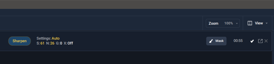

For reference here are the times I’m seeing on 2.2.4, using on it on a 4031px by 3025px JPG image.
I don’t have any times on record for the previous version to do a proper comparison.

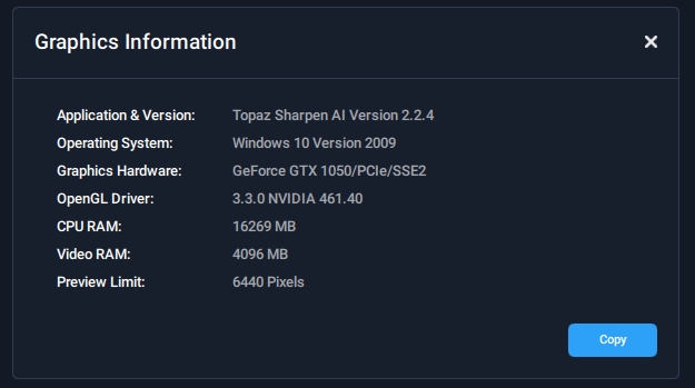

You may need to post the image to a file sharing site where it can be downloaded from then post a screenshot of the parameters used for processing. As, for me, it is the same as the previous version with a 6000x4000 image:
And my Notebook is similar to yours except for less RAM than you and my driver is updated:
You can try updating the NVIDIA driver and see if that makes a difference, or maybe there is something running that slows the process down.
