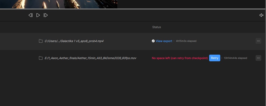

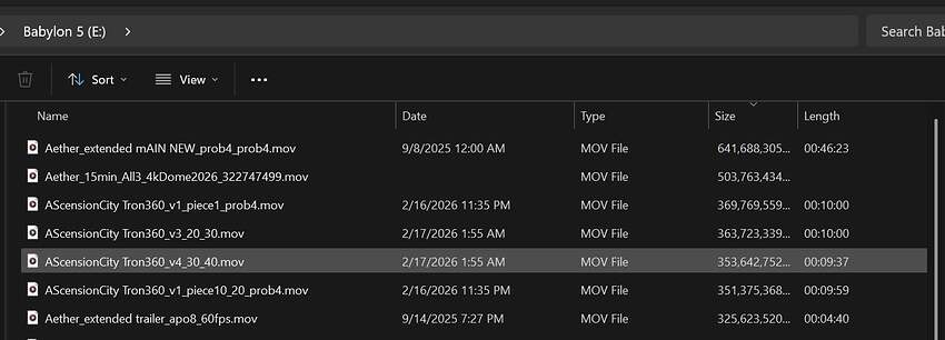

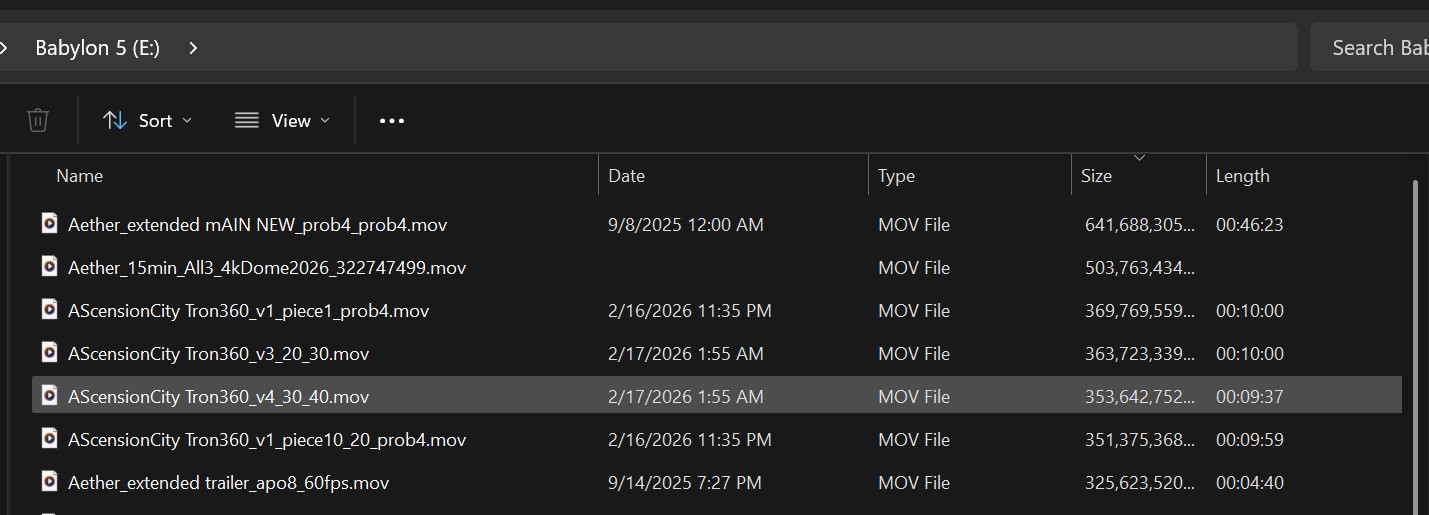

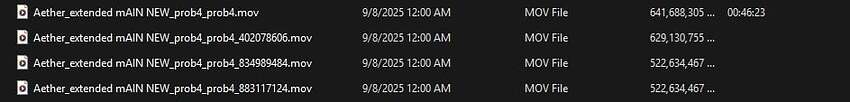

I’m doing these massive 8k conversions on a 4096x4096 domeshow and i am doing it from 1 ssd to another ssd - both drives have close to a terabyte avail so does my main drive - the end file is 640gigs roughly but it keeps giving me this out of space error and when i look all drives have plenty of space -plus it often leaves multiple copies of the file on 1 pic u can see 3 copies all close to being done but not . those numbers are in gigs so they are huge - same date more than a 1 1/2 TERABYTES of storage its sucking up - the longer list one with the single file with no time is just cuz its stil thinks its live in the software and waiting for me to retry from checkpoint
The logs are showing that drive D is out of space, where the original source file is being pulled from, and the temp files are being written to, along with where the export looks to be set.
The files with the random string of numbers are the temp files being created as the video processes. These will be joined back together at the end and merged into the final export.
