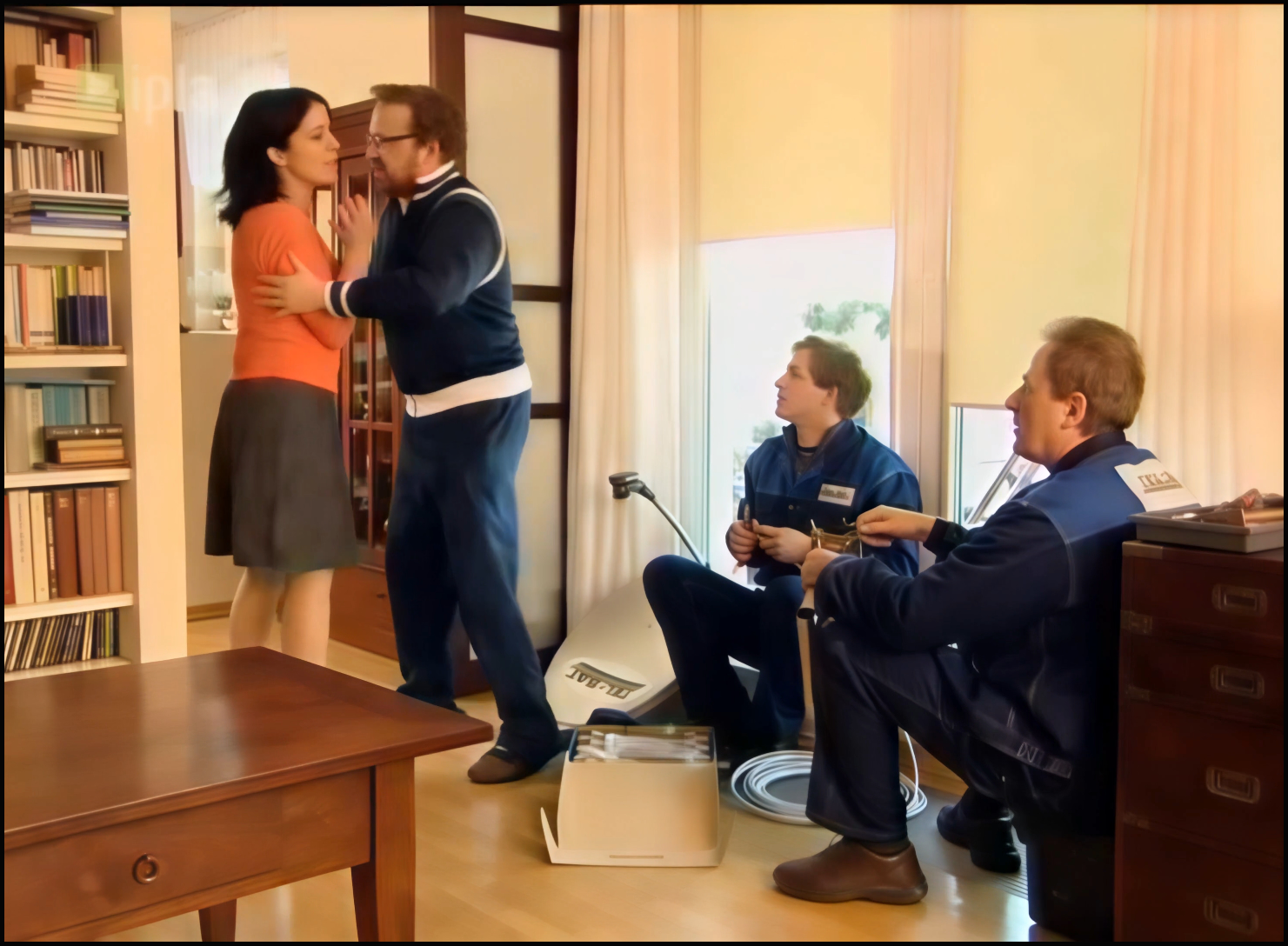

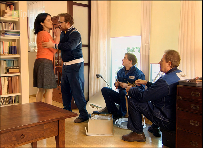

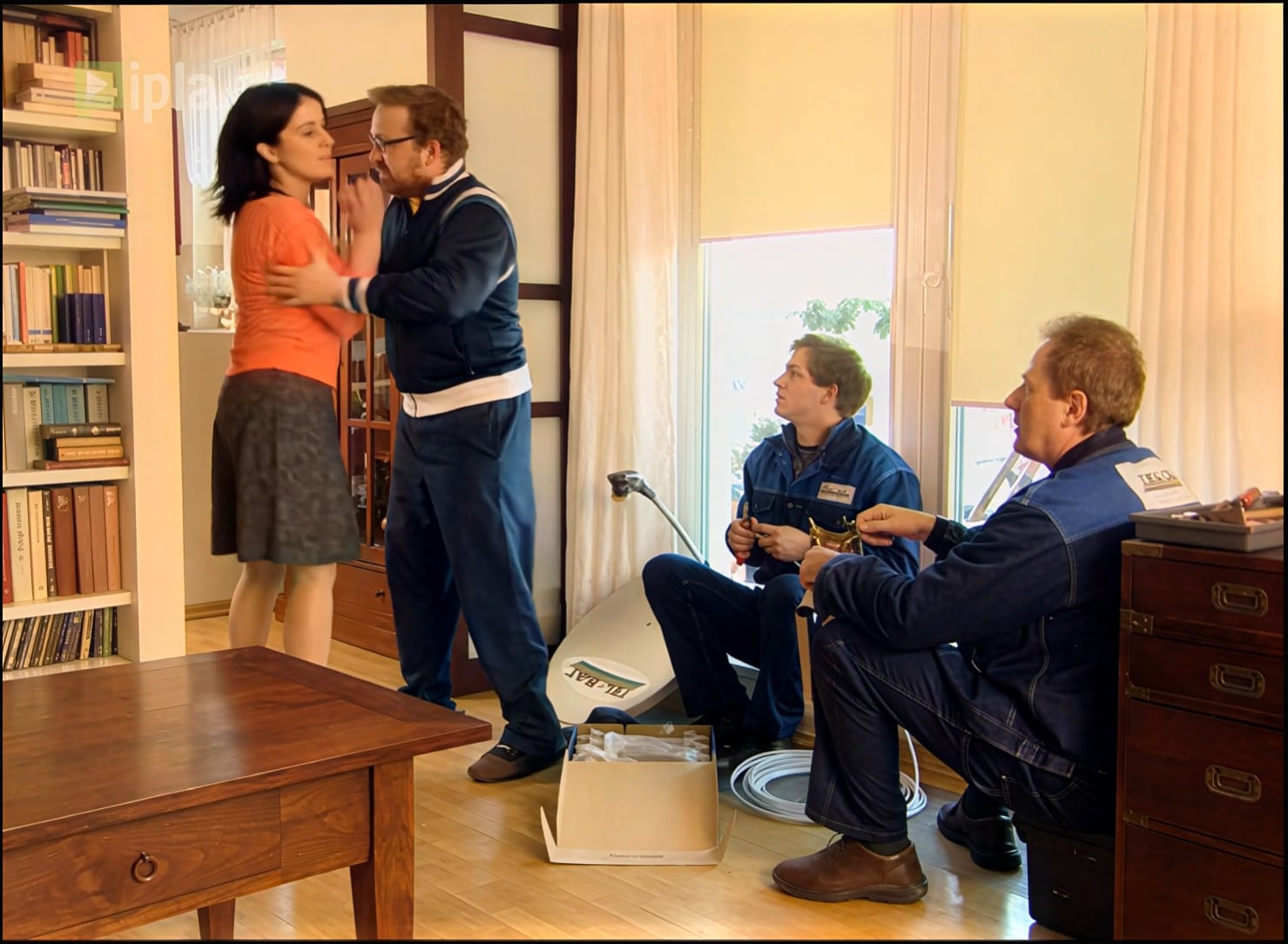

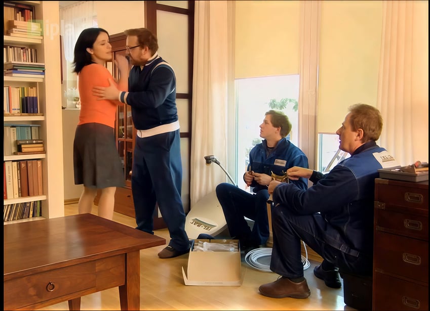

For comparison:
Original ( 576p ):
After Starlight Precise 2.5 ( 1080p ):
After Starlight Mini ( 4K ):
After Starlight Precise 2.5 ( 4K ):
