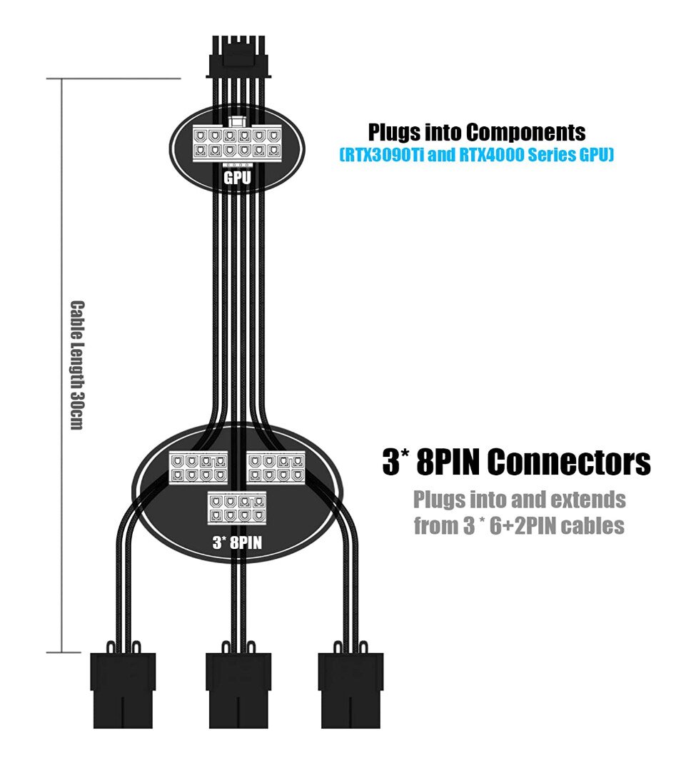

I found two cables on Amazon that run power from 3 PCI power sockets (Corsair) to the single connector on the RTX 4090. It is not as snazzy as the CableMod version but looks to be very well-engineered and uses stranded copper of an appropriate grade. It should not overheat. (See image below) It costs in the vicinity of $20.00 US.
