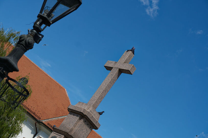

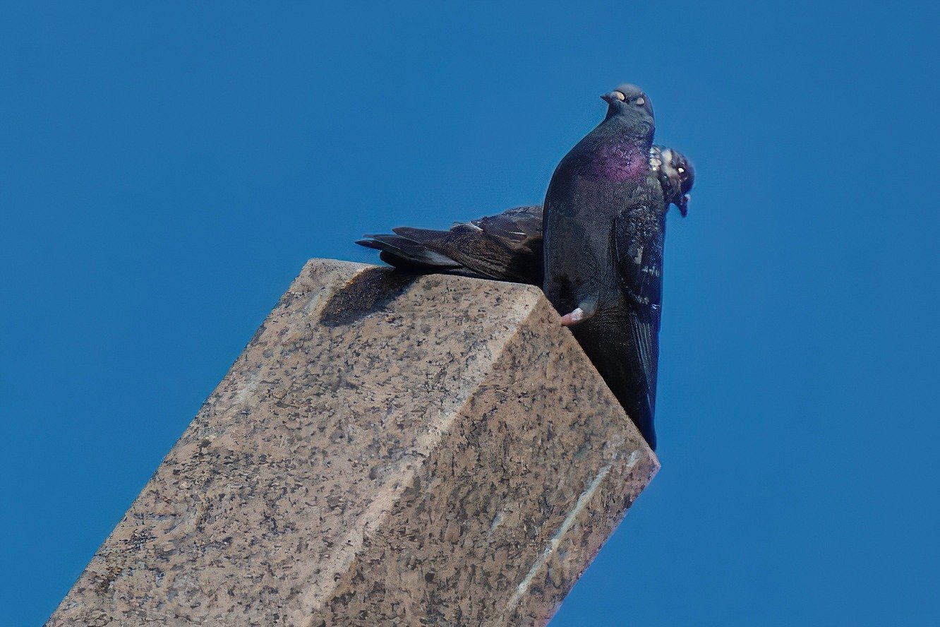

I don’t shoot birds, but I took a random snapshot the other day with Sony a6300, kit lens, APS-C sensor. Not high ISO, but far away birds with soft lens.
