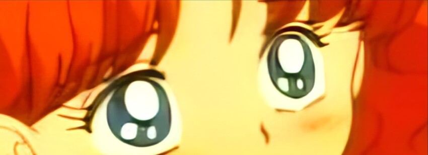

Here was a test that I did a while ago comparing various models. The source is 360p, outputs are all 1080p –
AHQ
AMQ
ALQ
GHQ
GCG
Iris LQ
Iris MQ
PROB
THD
THF
Make of it what you will. As far as interpolation, I generally do not use duplicate frame removal, although I will say that it can make some older cartoons look more modern - but, maybe that’s not what you’re going for. By the way, you can achieve a “smooth” look without going up to 120 or even 60 frames.
