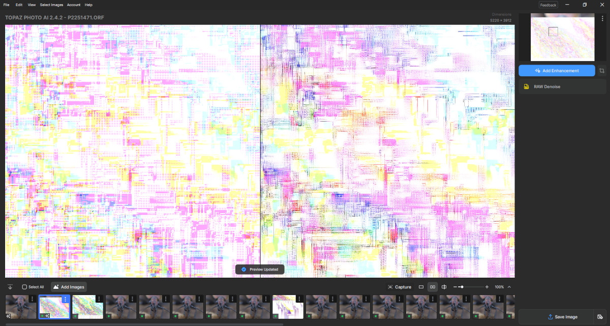

When I open many photos, the program produces errors in some photos. Installing an older version doesn’t change anything.

The problem only occurs when uploading ORF photos (Raws from OM-1). There is no problem with other formats with any number of photos.

The problem is still the same - but I got tired of writing e-mails. I am currently using Topaz as a plugin and using Tiff files. There is no problem here.
