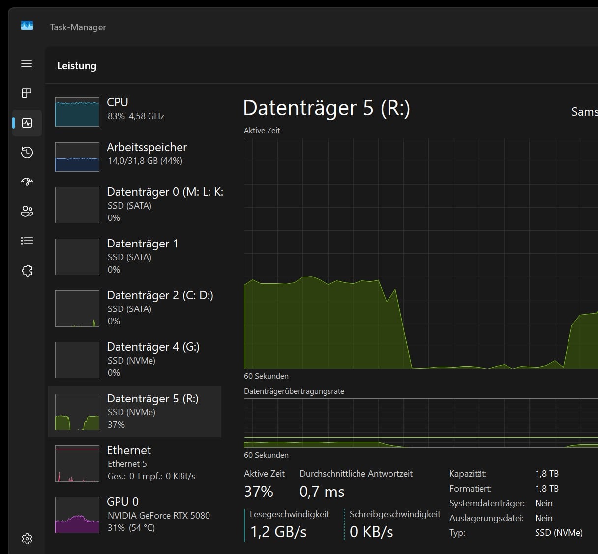

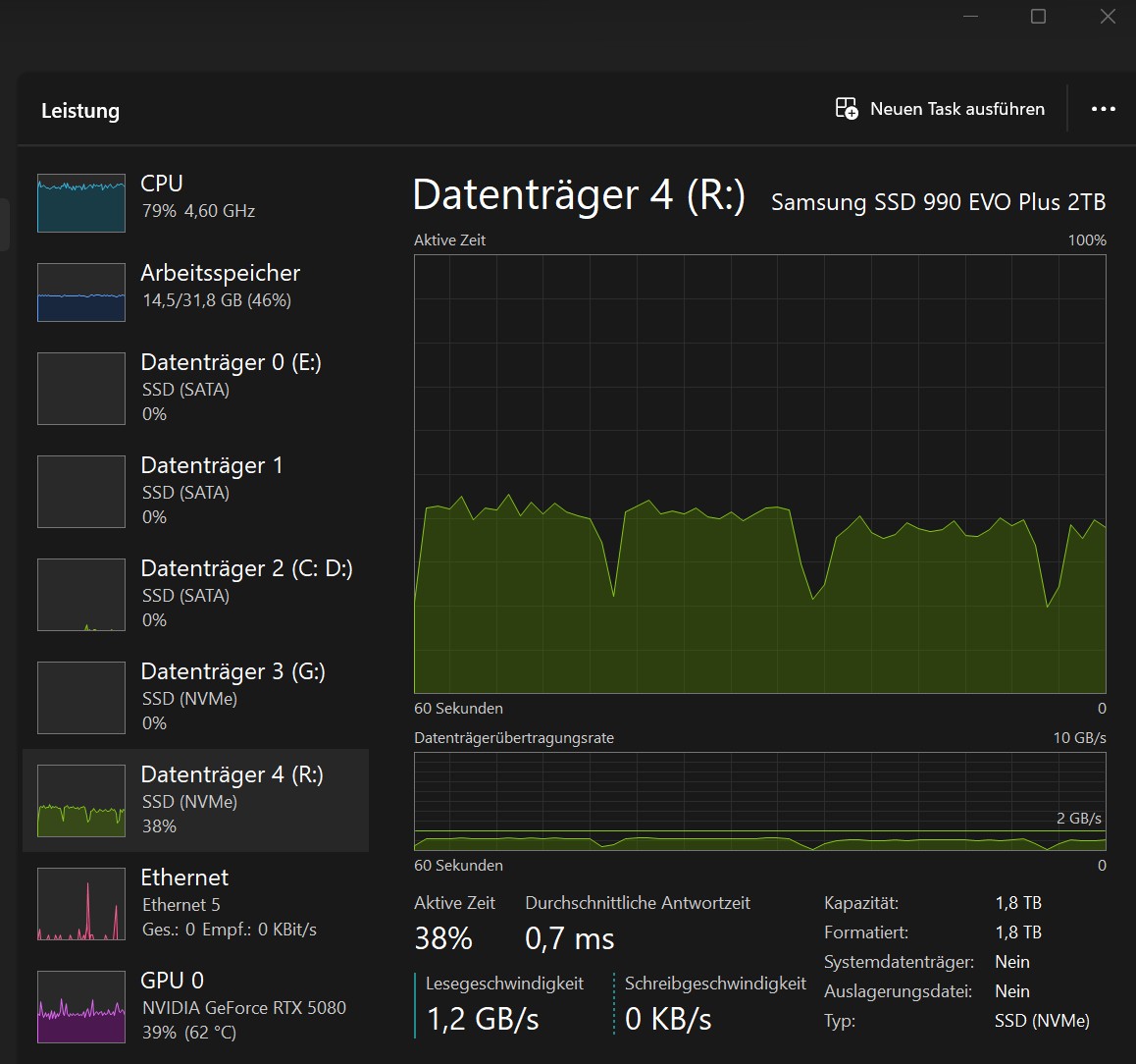

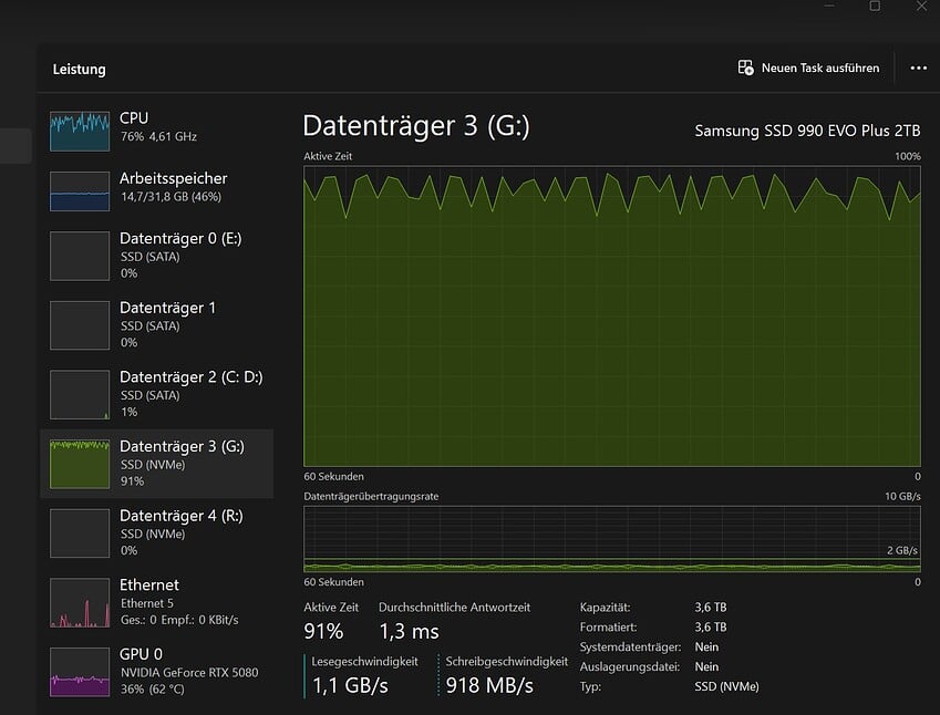

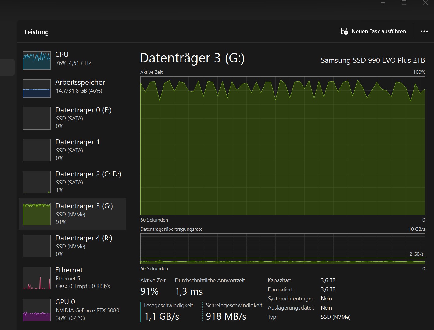

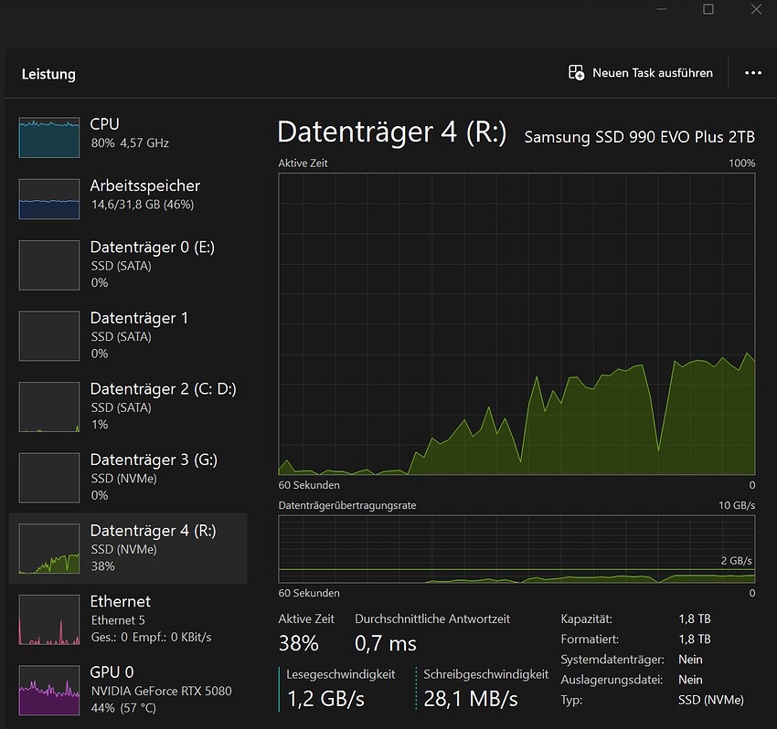

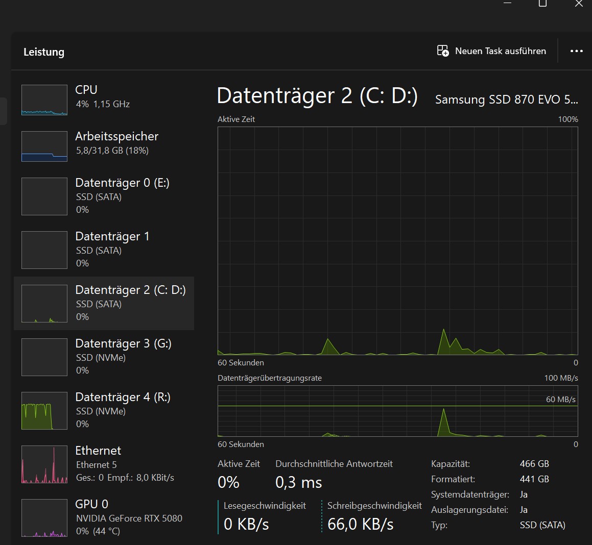

The computer starts up with normal/good parameters, but after a few minutes it gradually slows down and after 20, 40, or 60 minutes, a reading frenzy occurs on the disk, which is Topaz’s output target.
The file is read billions of times, with over 10 Gbit/sec as a permanent state.
See screenshots.
As a result, the computer has now slowed down by 15 to 22% on average!
This is unacceptable given the computing times that are to be expected with video AI today.
For a job that takes many hours, the computer is only working at about 83% of what it could actually do without this bug.
The ‘read terror’ occurs on the disk where the file to be written by Topaz is located.
It is read billions of times at 1 to 1.7 GB/s.

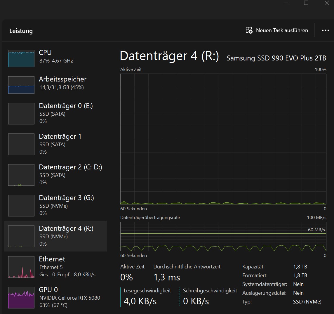

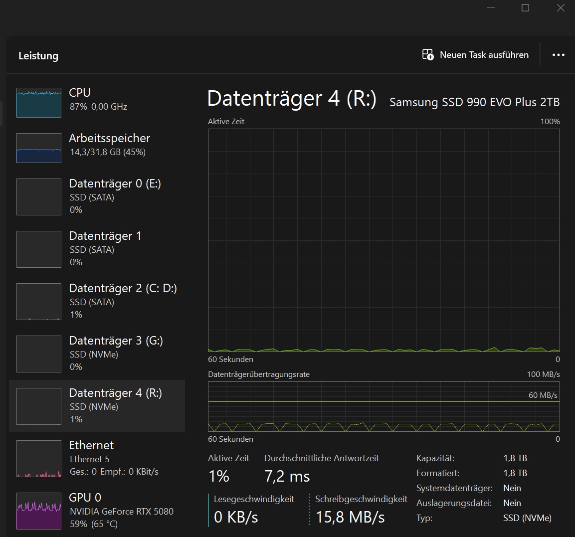

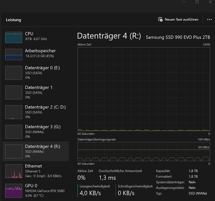

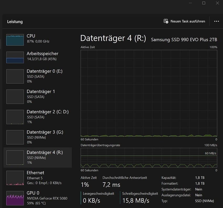

1st test: ProResLT output
Start speed: 5.9 fps – cyclic read approx. 100–300 Kbytes/s (H264) – cyclic write: 8 Mbytes/s (ProResLT) – everything great

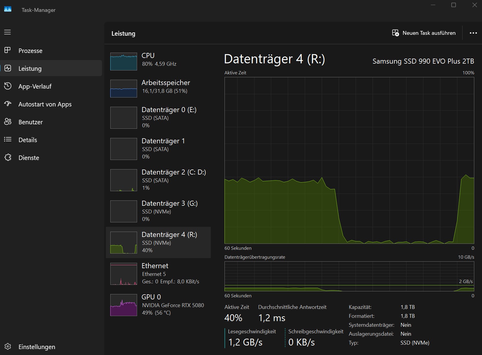

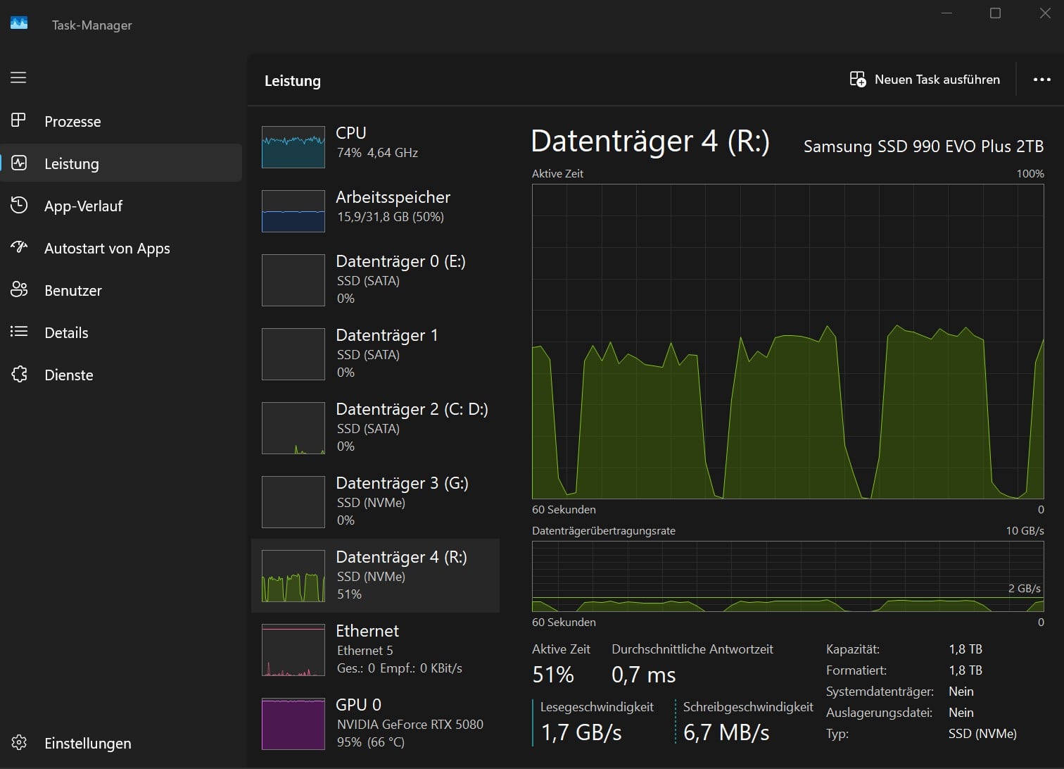

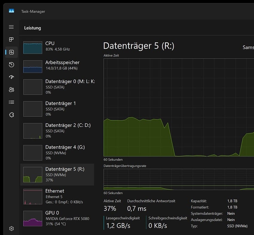

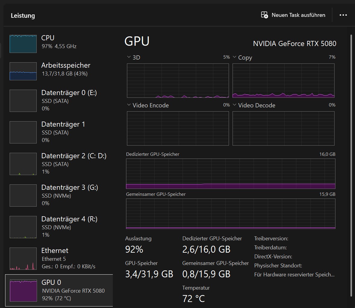

After 40 min: 5.5 fps - Cyclical reading - in blocks lasting approx. 20% of the time - from 1.2 to 1.4 GB/s begins! (visible in Task Manager)

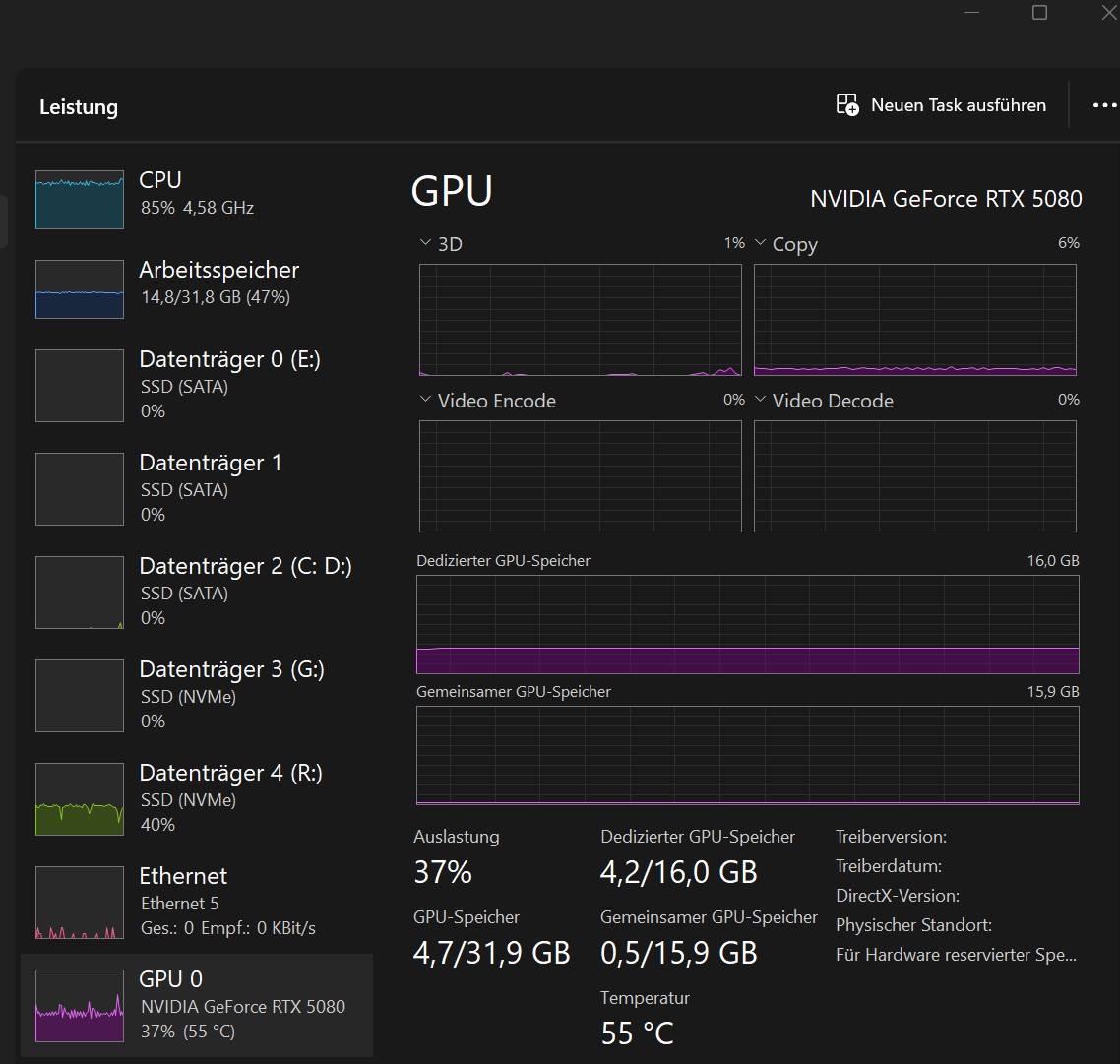

After 50 min: 5.4 fps - during the ‘meaningless’ read operations, GPU utilization drops below 45%
After 65 min: 5.3 fps
After 75 min: 5.2 fps

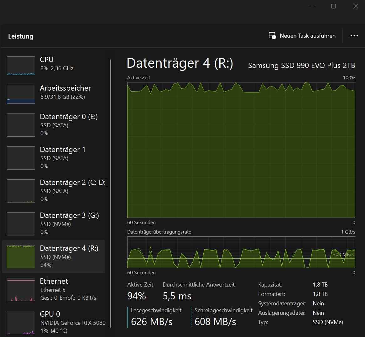

After 90 min: 5.1 fps – frequency of ‘pointless’ read operations increases
After 100 min: 4.9 fps – frequency of read operations continues to increase

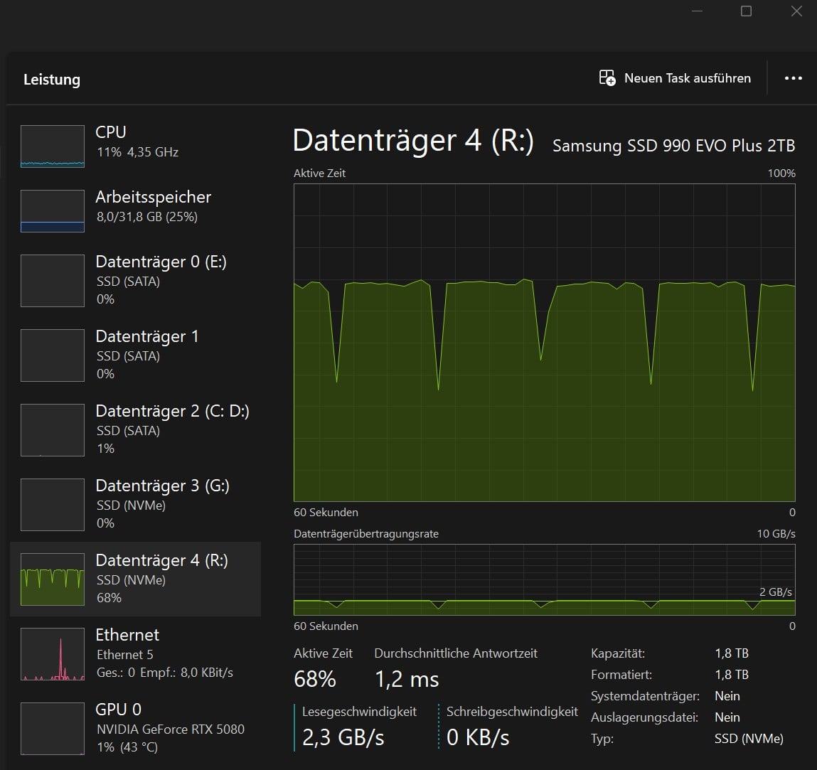

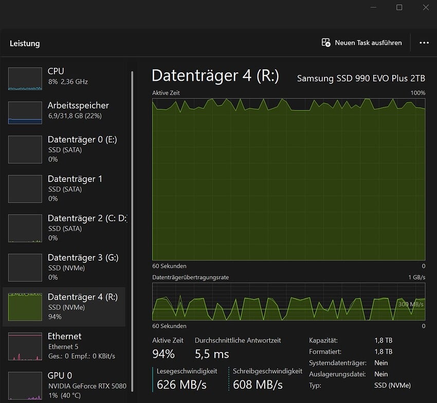

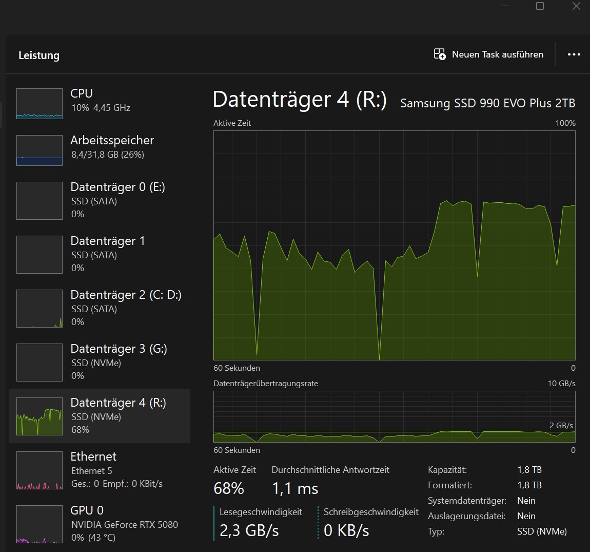

After 130 min: 4.8 fps – pointless read operations now occur continuously
→ CPU utilization as at the beginning, BUT: GPU only 40 - 55 % !
