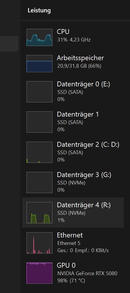

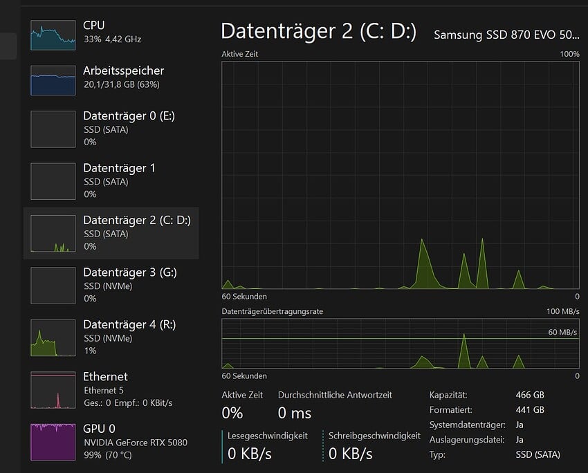

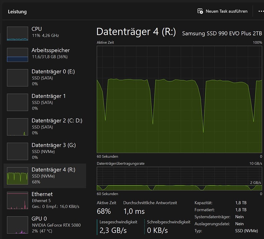

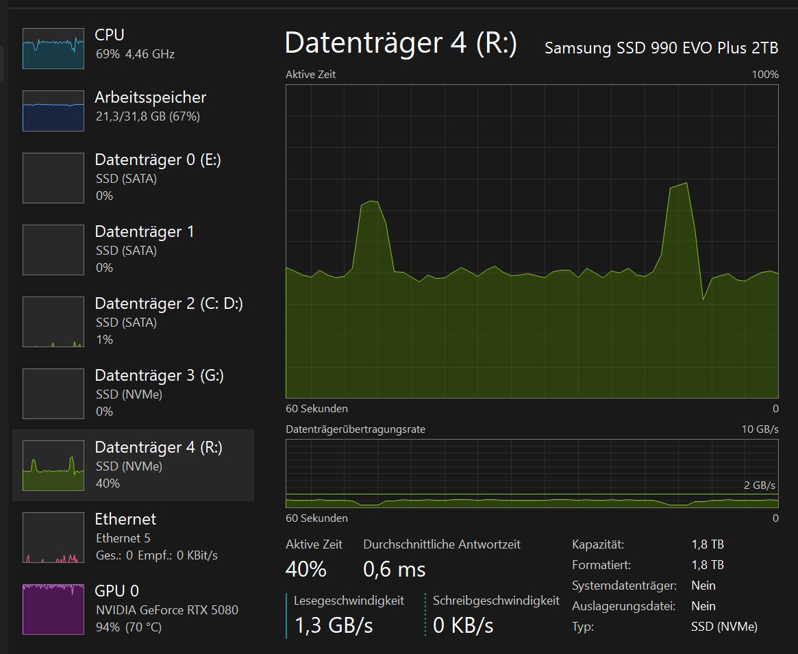

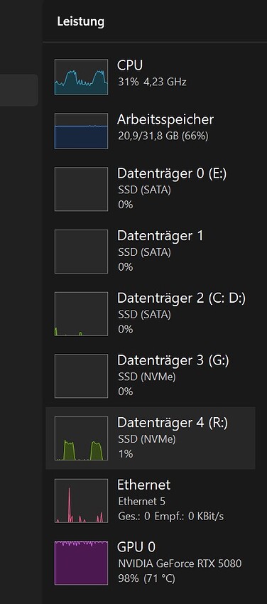

While with ProRes and AVID (JPEG-based/intraframe-compressed codecs), the error is accompanied by a drop in GPU performance (see screenshots above),
with FFV1, on the other hand, there is an increased demand on the CPU!
The GPU continues to operate at around 100%.
In my opinion, this is an interesting clue that might show the programmers where they need to look?
utilization and start of problem after 24 min from start:
… after 60 min

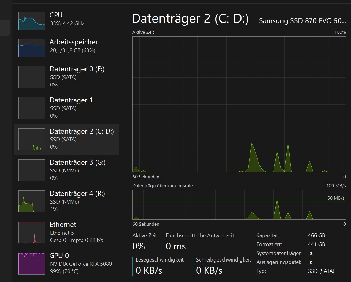

System during the TOPAZ outage:
ffmpeg.exe ran “smoothly” for many hours until the end, after Topaz was shut down in Task Manager:

Yes, and as I documented earlier (with a screenshot), the “reading terror” continues for several minutes—even half an hour—after the job has finished!
So the app isn’t finished yet, but it doesn’t even know what it’s still missing…
That’s why it won’t close normally…
