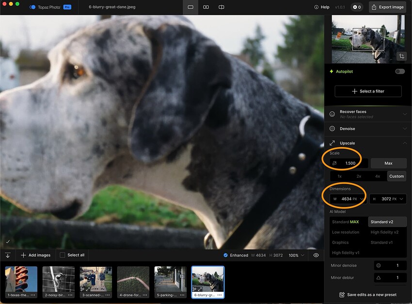

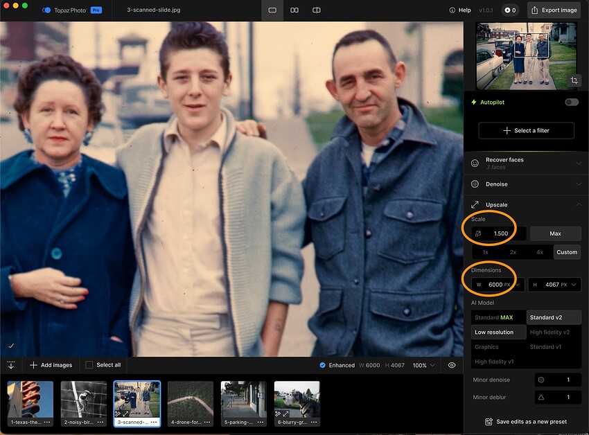

Using the software sample images to demonstrate, I added a few filters, set the Upscale dimensions to 6000px wide (which happens to be 1.5x scale on this image) and clicked “Save edits as a new preset”:
Then, I applied that preset to another image, but rather than Upscaling to 6000px wide, it goes to 4634px wide since this one is smaller than the image I used to create the Preset.
