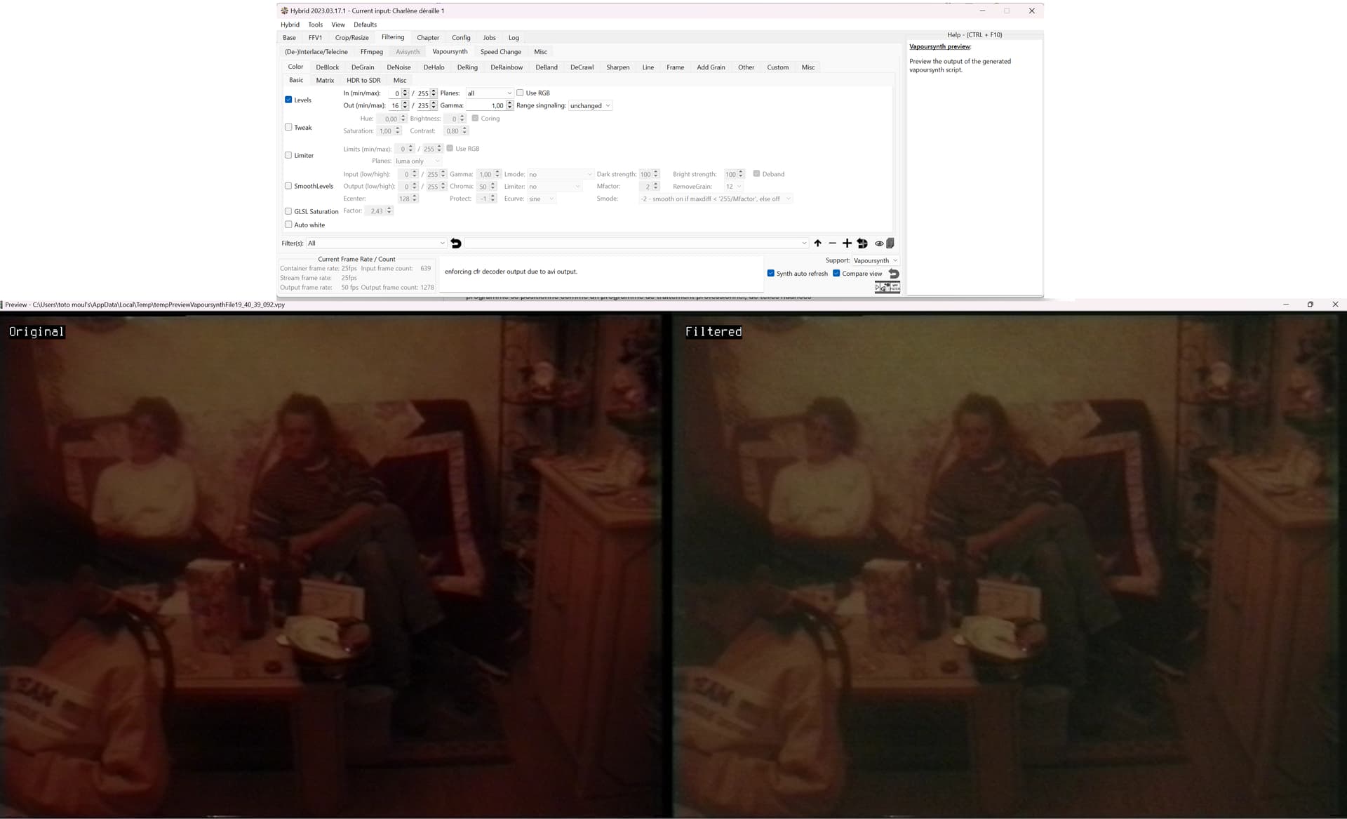

I can’t manage to play with the contrast in hybrid, if I decrease it, the image is darker, if I increase, the whites are too burnt and it brings out more noise, so I tried to play with it the level by setting 0-255 in “in” it gives me this image aspecty which looks clearer but the colors are modified, and I can’t see if it looks more natural with this scene of the video. I will try to produce like this, do a test with vai and see if I can correct the colors afterwards.
