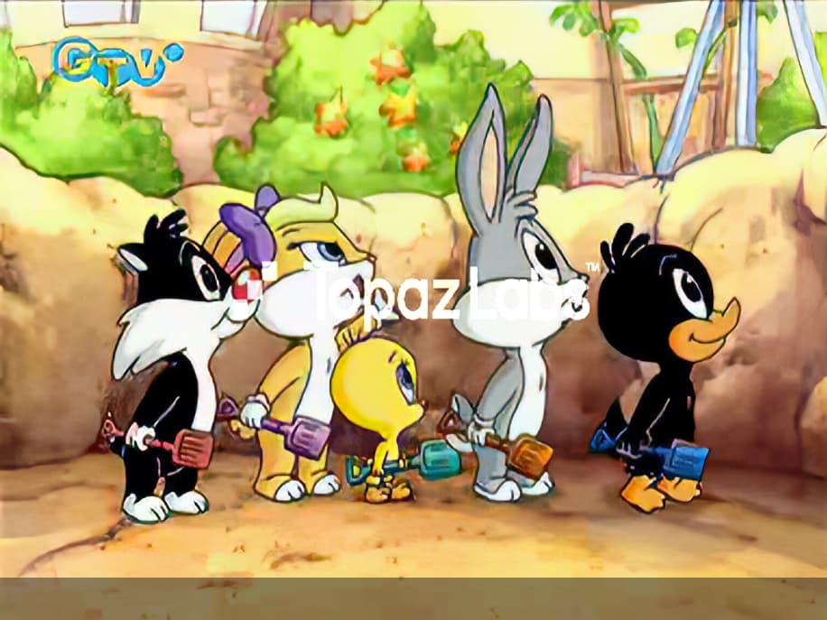

So the best algorithm for this particular video is 2x upscale, proteus, deblur, then again 2x upscale plus filter suitable for final polishing. All algos that I tried to this point even successful one gave me decent results but not perfect. I know that video is extreme case and is not something I will use to feed Topaz every day but just for the experiment! On the final I try to clean “War of the Weirds” a bit more and for that purpose I experimented with Artemis. Artemis LQ gave me best results. With MQ and HQ there is almost no difference, with Aliasing/Moire the results are weird and destructive. Actually Artemis gave a bit better results than Rhea and I experimented with different combos.
Original
First run: Proteus + Deblur, native resolution
Second run: Artemis, 4x upscale
First run: Proteus + Deblur, 2x upscale
Second run: Artemis, 2x upscale
4x upscalling on one run looks a bit fuzzy compared to 4x upscalling on two runs (look the flowers on the bush). So with 2x upscale, Proteus, Deblur plus second 2x upscale and Artemis LQ I got near perfect results (not perfect in particular shots) and with that I end for today. I hope this post to be useful or at least entertaining. On the next post I will discuss frame interpolation.
