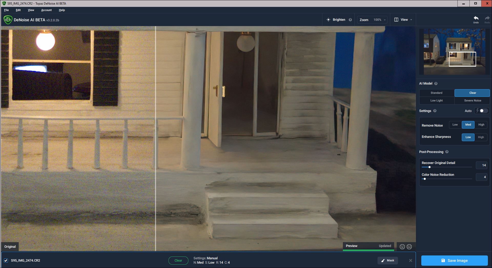

I tried a CR2 (Canon proprietary) raw image 1st in NoNoise AI (ON1) then in this Topaz DAI 3.2.0.2b beta.

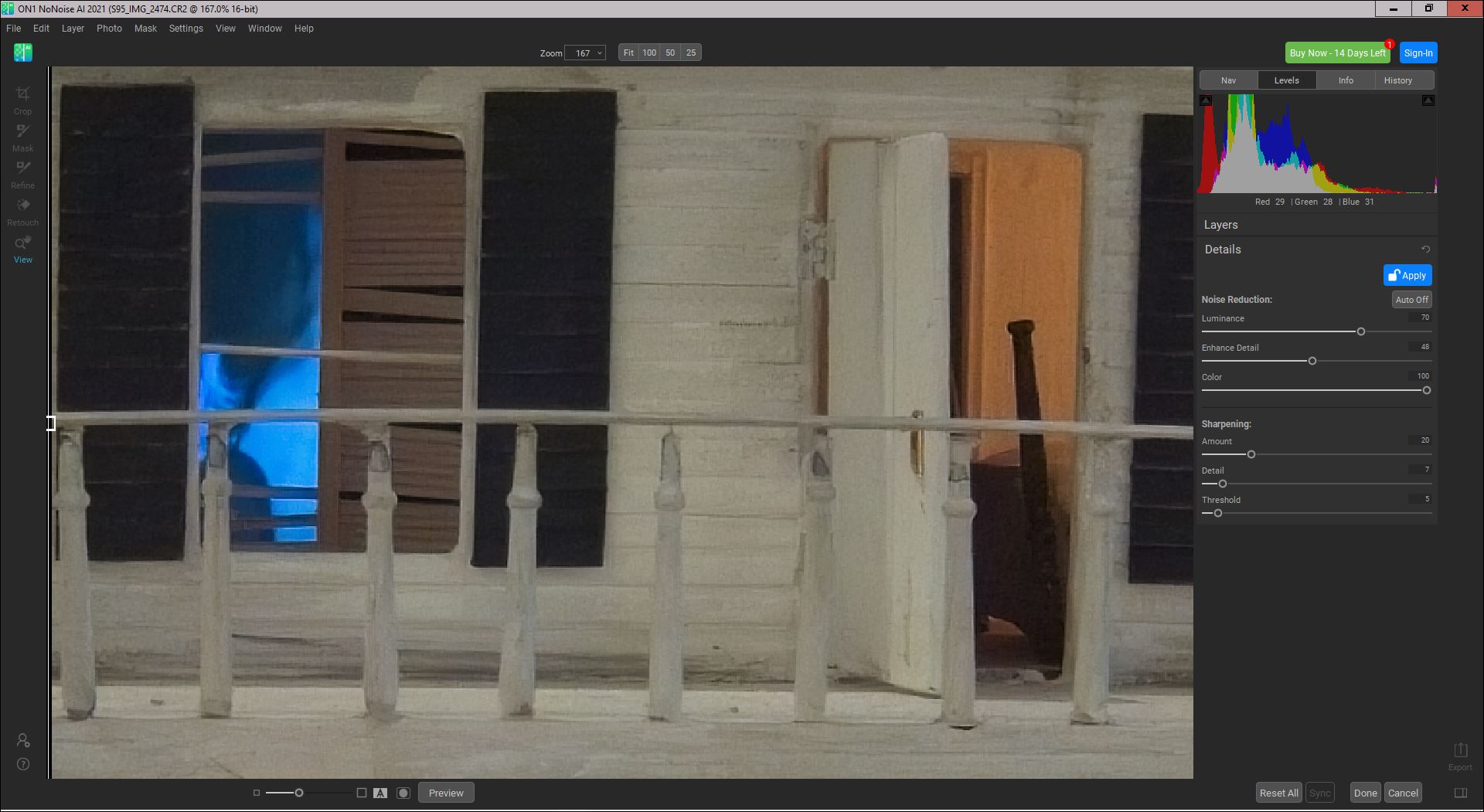

Original view in NNAI (ON1) interface:
DeNoised preview in NNAI (ON1) interface:
Split Preview - ORIG/Denoised Preview in NNAI (ON1) interface:

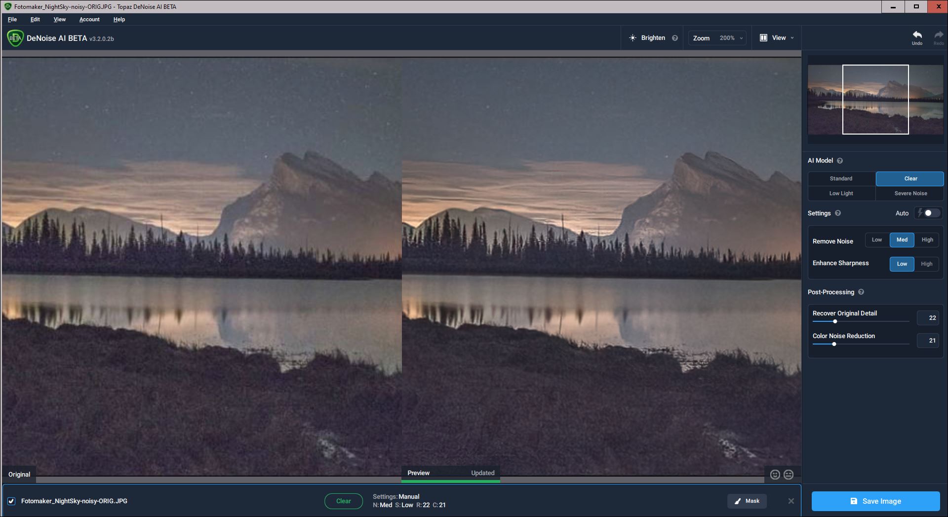

Split Preview - ORIG/Clear Mode DeNoised Preview in DAI beta (Topaz) Standalone interface:

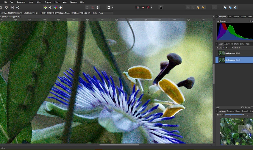

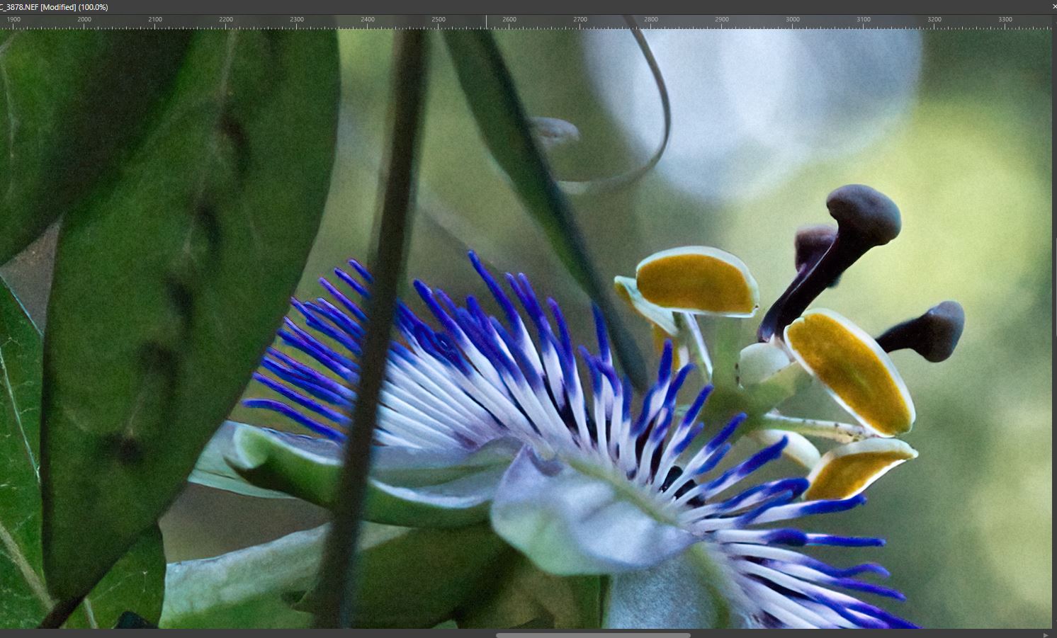

I finally got Affinity to work with DeNoise AI. Working with RAW files has to be converted to 16bit for DN to work. Now its working in Affinity.
Before DeNoise but processed with RAW setting
After working in DeNoise and exported into Affinity.

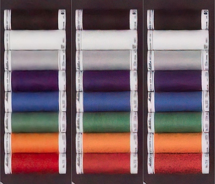

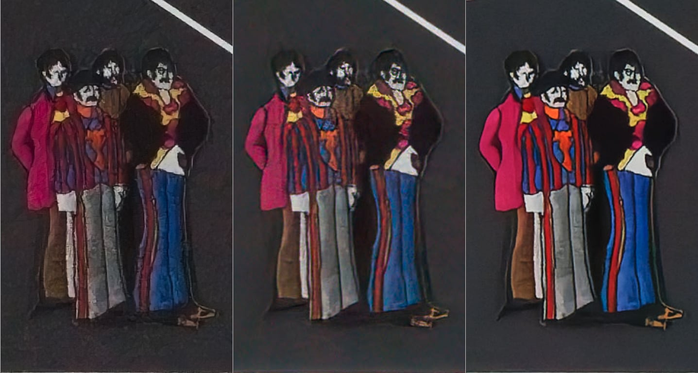

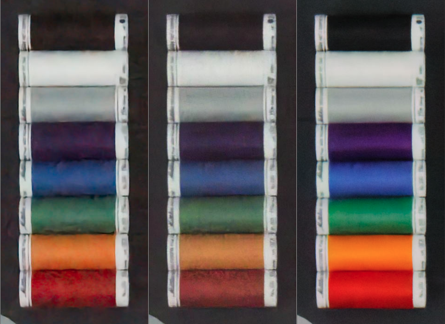

I too have done a quick comparison, but I DO have a lot of high ISO images.
This one was shot at ISO 12800.
I used Auto in all three cases (with DxO Pure Raw there’s no option anyway) but as it was a tad underexposed for the shadows, I edited all three further in On1 Photo Raw. No questions which is best!

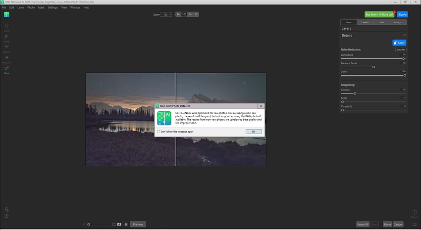

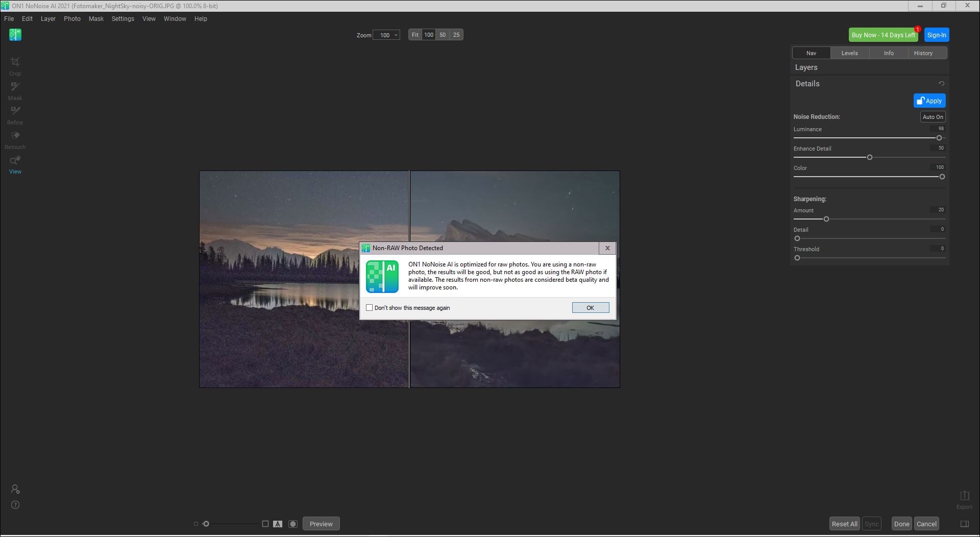

Because ON1 put the banner Disclosure up saying their product is only optimized for raw images I felt compelled to immediately try a .jpg to see what (if anything) would happen.
I only ran all these using the Standalone products for ON1 & Topaz.
I hate the idea of my denoising processing software being limited to only do its best on raw images of any ilk - proprietary camera mfr., proprietary Adobe (dng), etc. I have too many old images that were just jpgs that I might wanna denoise. And, tons of .tiff’s.
Here’s a comparable comparison to what I did with the CR2 raw image above - this time for a landscape scene .jpg
ON1 NoNoise AI - Removes critical landscape details (tree branches, etc.) that makes my image look as if it was run thru Topaz Simplify. Split preview of Orig/denoised:
Topaz DAI 3.2.0.2b - Clear Mode Preview - Set up to look like the ON1 in terms of side x side view (vs comparison 4-way view):
BTW - I liked “Clear” mode (DAI) best of all the Topaz DAI modes for all the tests I ran to do these prod. comparisons.
Very clearly so in all the tests I just ran on raw & jpg images!

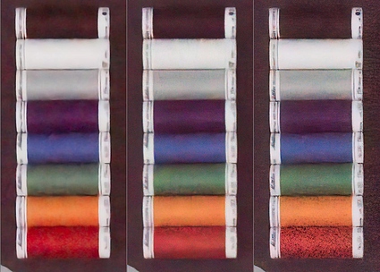

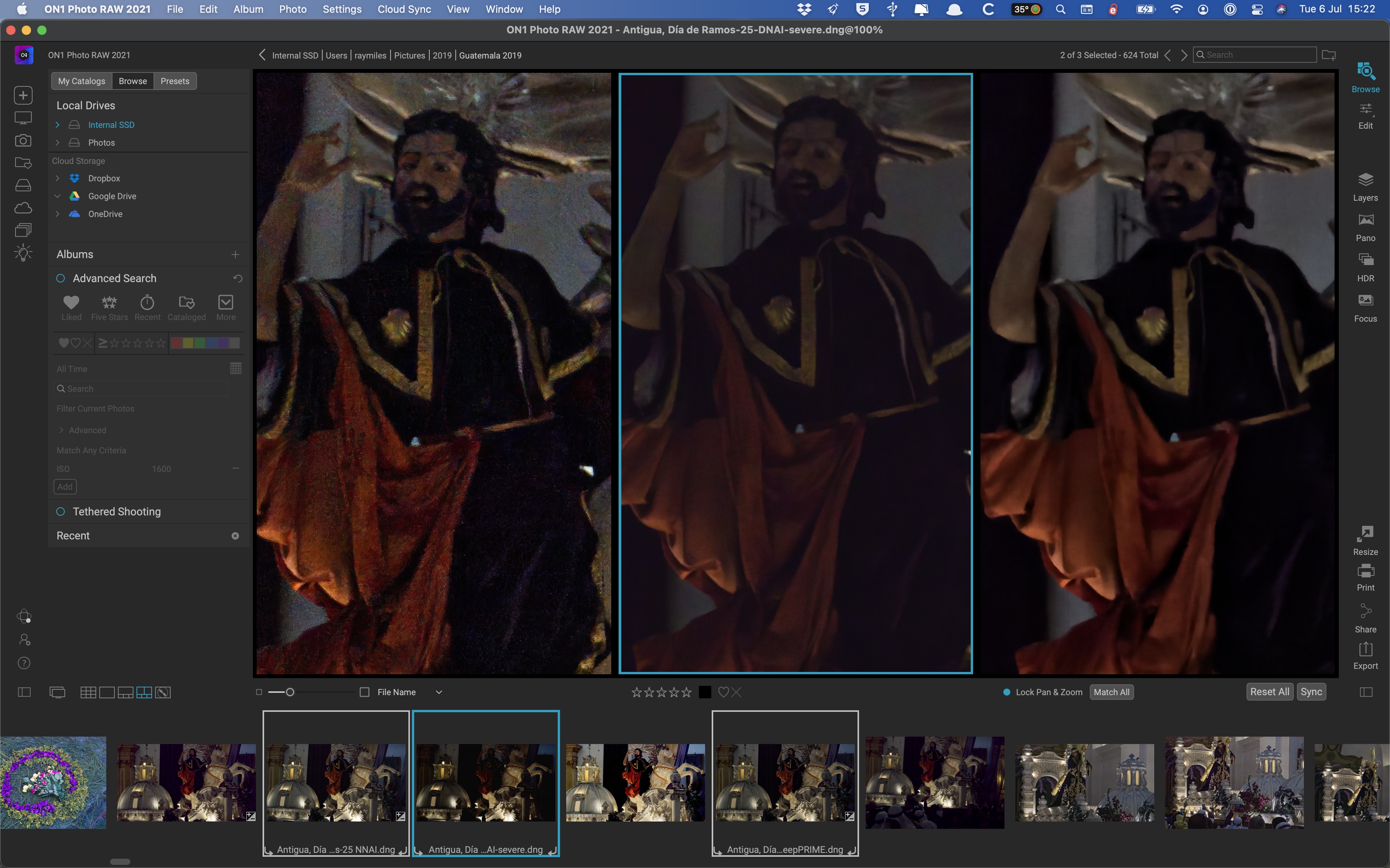

Test 1: (Very Noise RAW Image)
RAW: On1 NoNoise AI vs Topaz De Noise AI (Severe) vs DXO DeepPRIME
Test 2: (Extreme Noise RAW Image)

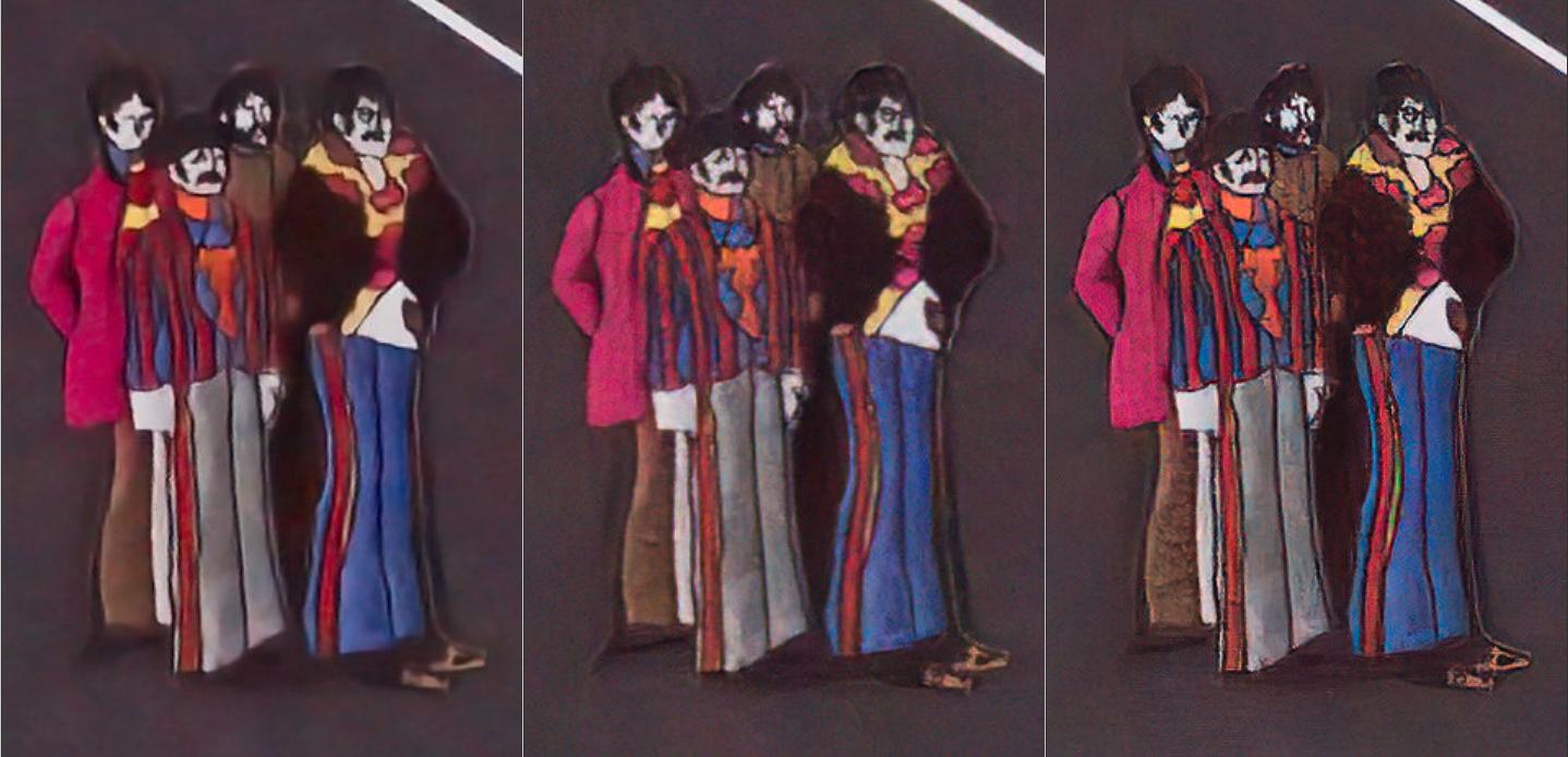

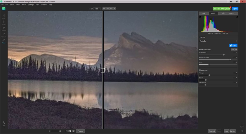

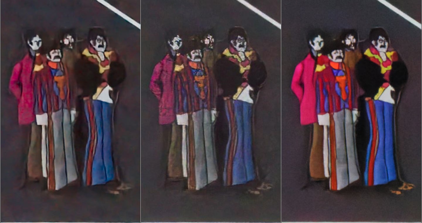

Test 3 (Very Noise JPG)
JPG: On1 NoNoise AI vs Topaz De Noise AI (Severe) vs Topaz De Noise AI (Clear)

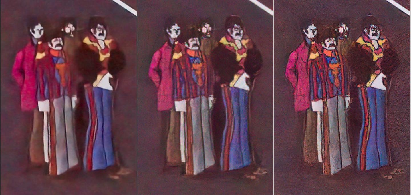

Test 4 : (Extreme Noise JPG)
JPG: On1 NoNoise AI vs Topaz De Noise AI (Severe)vs Topaz De Noise AI (Clear)

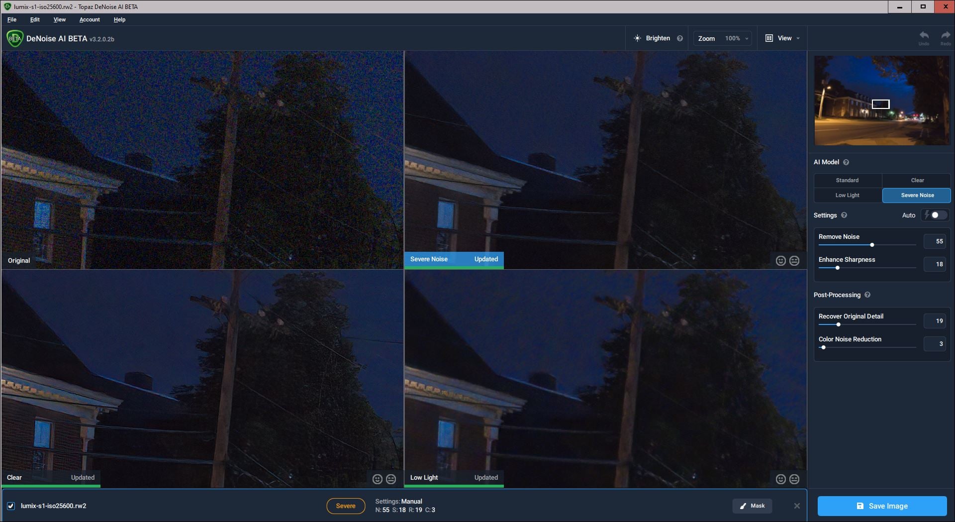

Worked with a single Lumix raw image with ISO = 25,600 (night photo with heavy noise - incl. color noise)

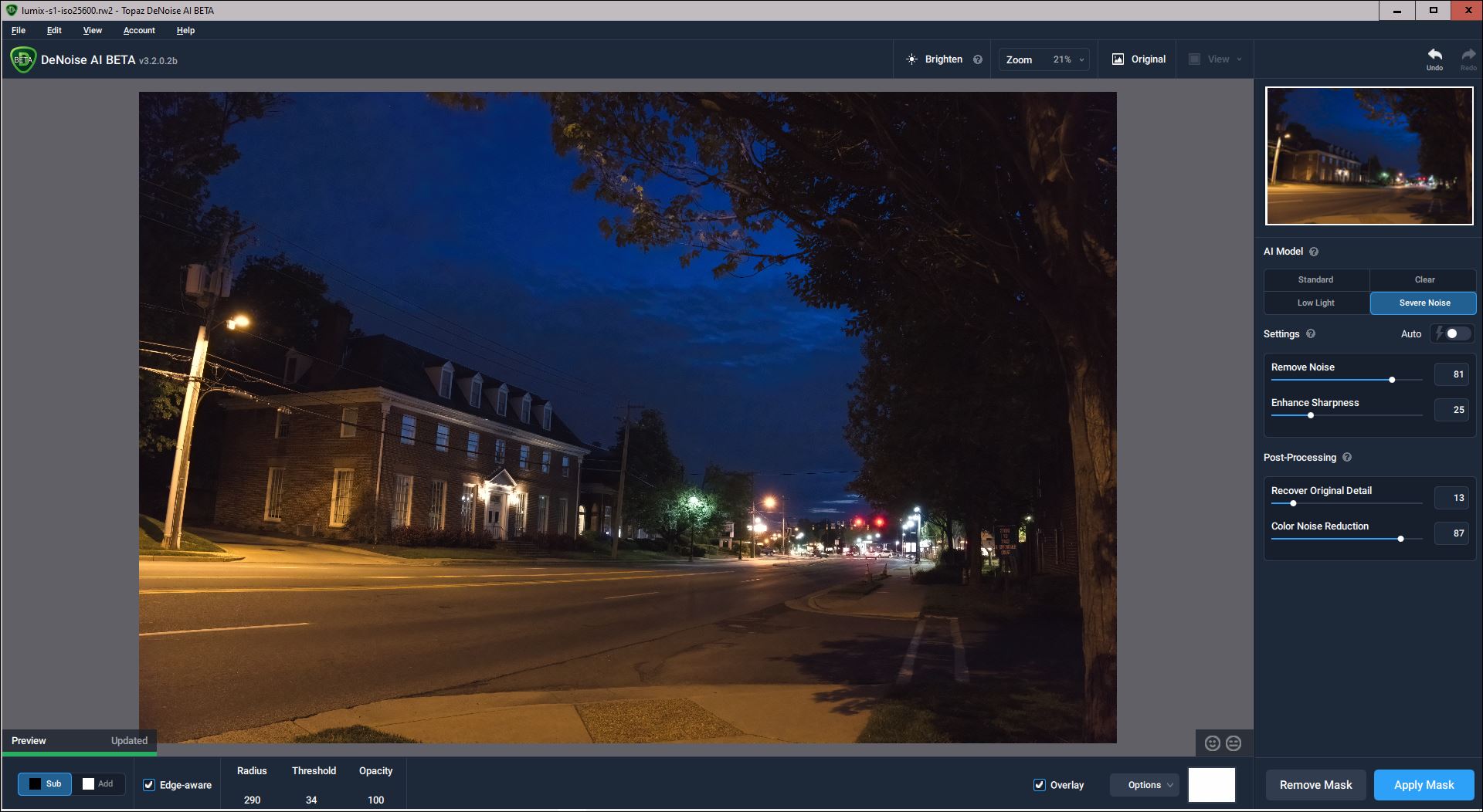

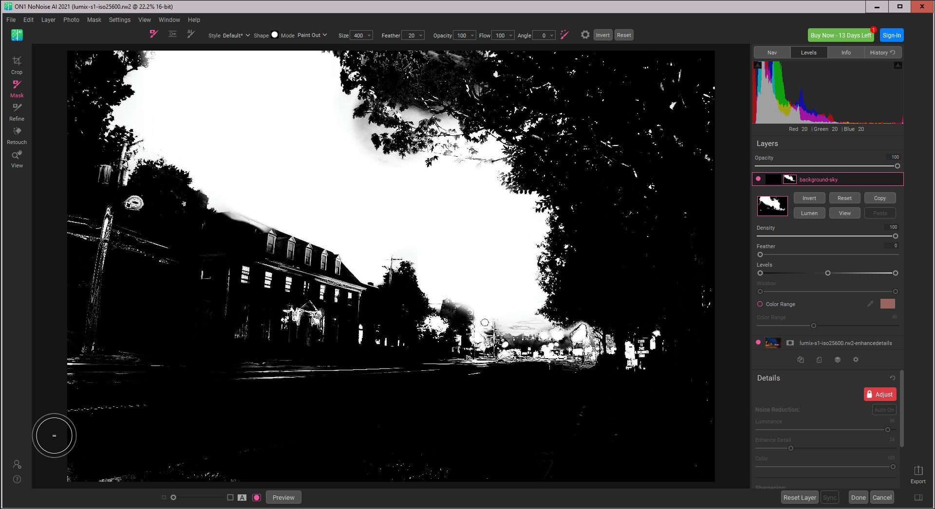

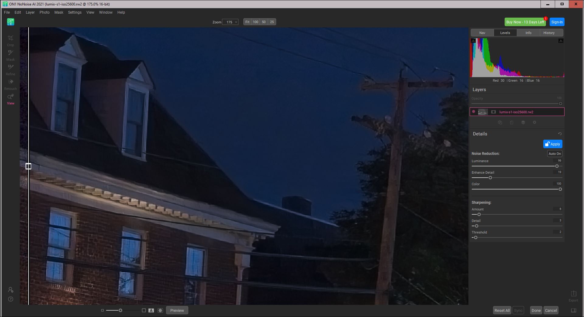

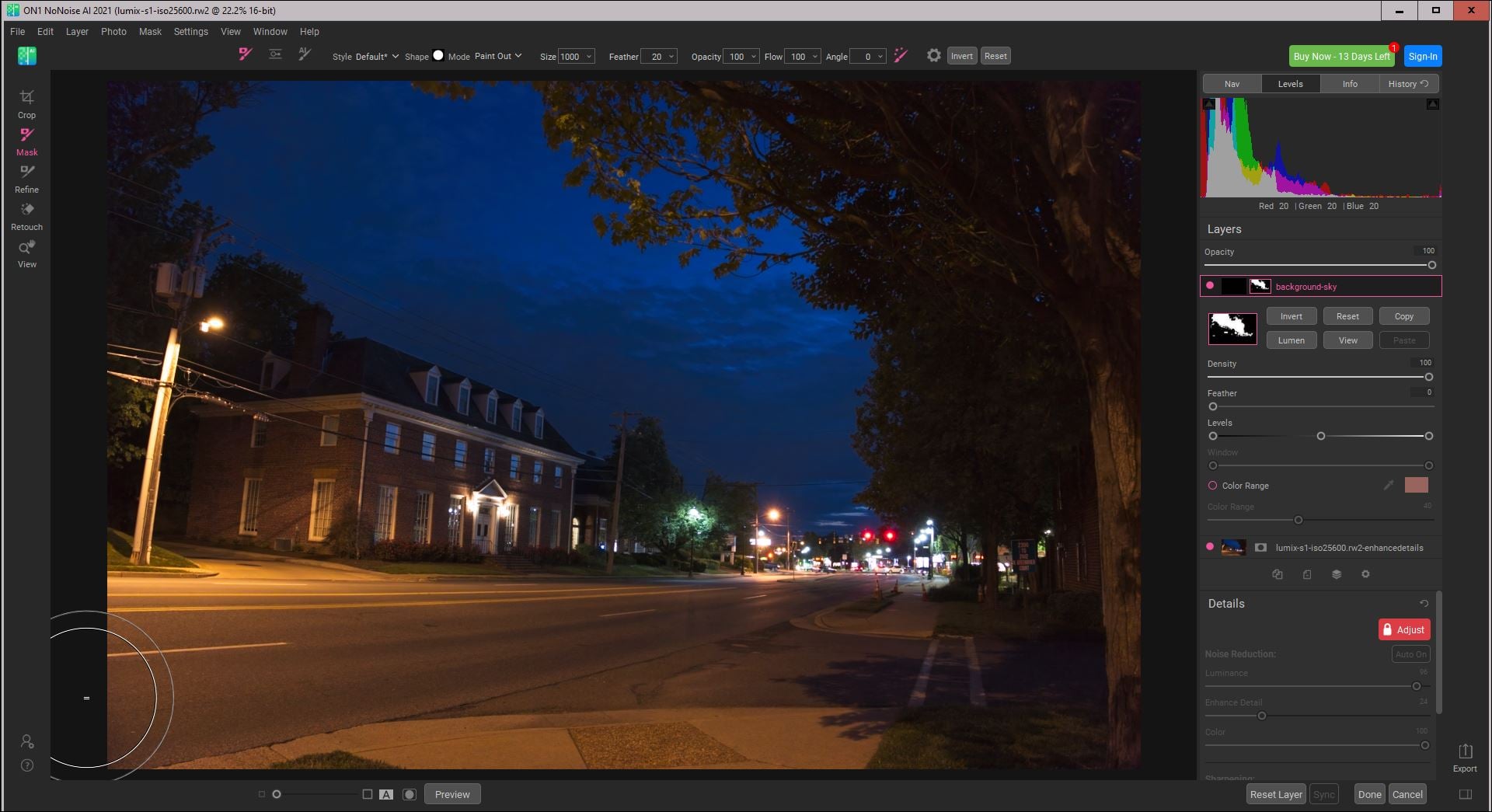

Focus Today for me = Masking Functions/User Interface in the 2 products.
Bottom Line: ON1 NoNoise AI’s masking outperformed Topaz DeNoise AI 3.2.0.2b’s masking functionality and interface options in my tests. The ON1 NoNoise AI masking experience is more feature-rich, and offers more flexible and easy-to-use masking functionality than Topaz DAI 3.2.0.2b. NoNoise AI’s masking more closely resembles the types of masking features/functions present in Topaz Studio. The one exception - I like the color paint on overlay feature that helps me see where I’m brushing in DAI.

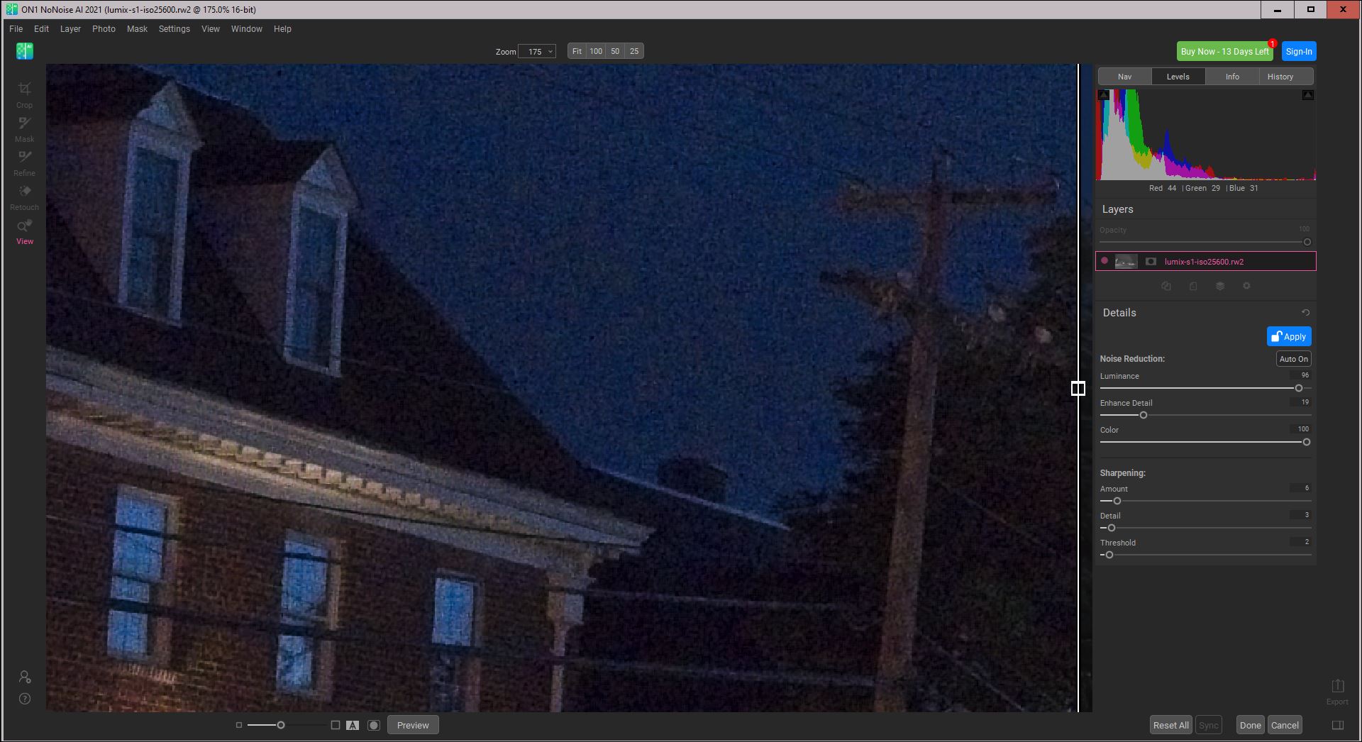

Original Lumix Raw Image in ON1’s NoNoise AI Interface (see above for image specs):
Preview of Globally Denoised Raw Image in ON1’s NoNoise AI Interface:
Split Side x Side Preview (Orig/Denoised) in ON1 NoNoise AI UI:
Enlargeable BW Mask - Easy to View + Very Accurate “Edge Aware” Brush Tool in ON1 NoNoise AI masking UI (enabled by creating a separate layer + ability to lock denoising/sharpening values for masking in the NNAI masking interface):
Raw image with Selective Masking (sky was masked to show denoising, all ground elements were unmasked - to retain orig noise - for test purposes) in the ON1 NoNoise AI interface:
  • From a global image perspective, Topaz DAI 3.2.0.2b using “Severe Noise” mode + add’l. Color Noise slider adjustment was comparable to ON1’s NoNoise AI result with this Lumix raw image. All tests were viewed at 100 & 200%. Brush masking was handled with full image elements visible in the UI; not zoomed in.

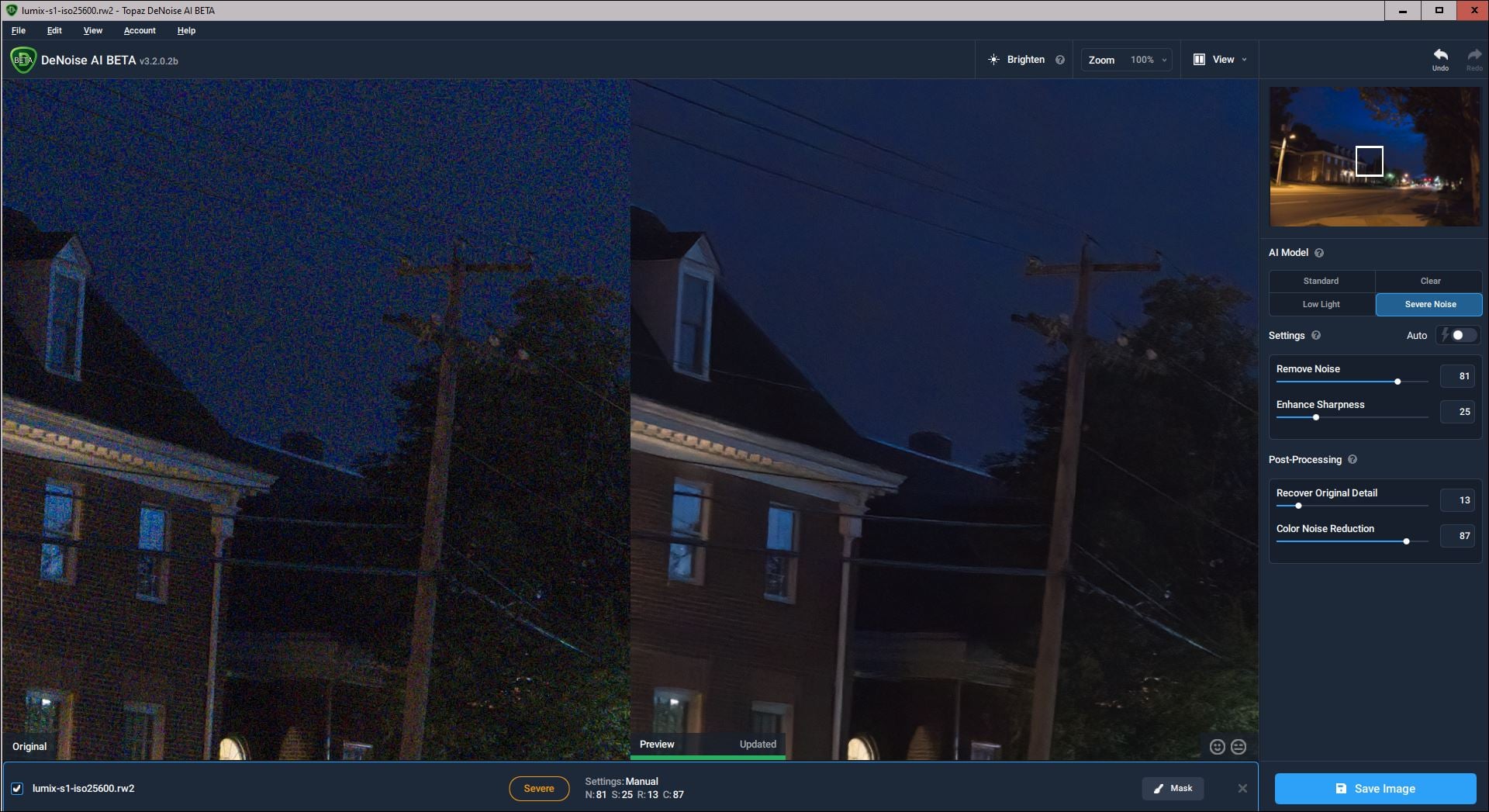

Topaz DAI 3.2.0.2b 4-Way Comparison View of the Lumix Raw Image. Significant advantage to see all denoising options/modes together to pick one to work with:
Topaz DAI 3.2.0.2b Side x Side Comparison View - ORIG & Severe Noise:

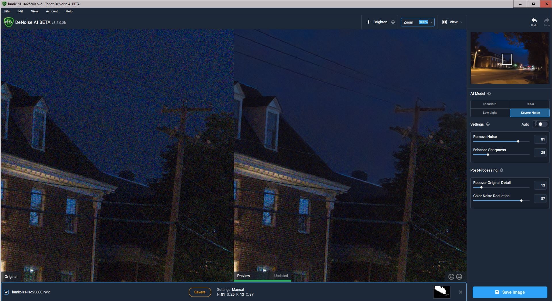

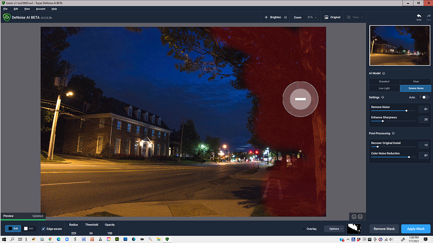

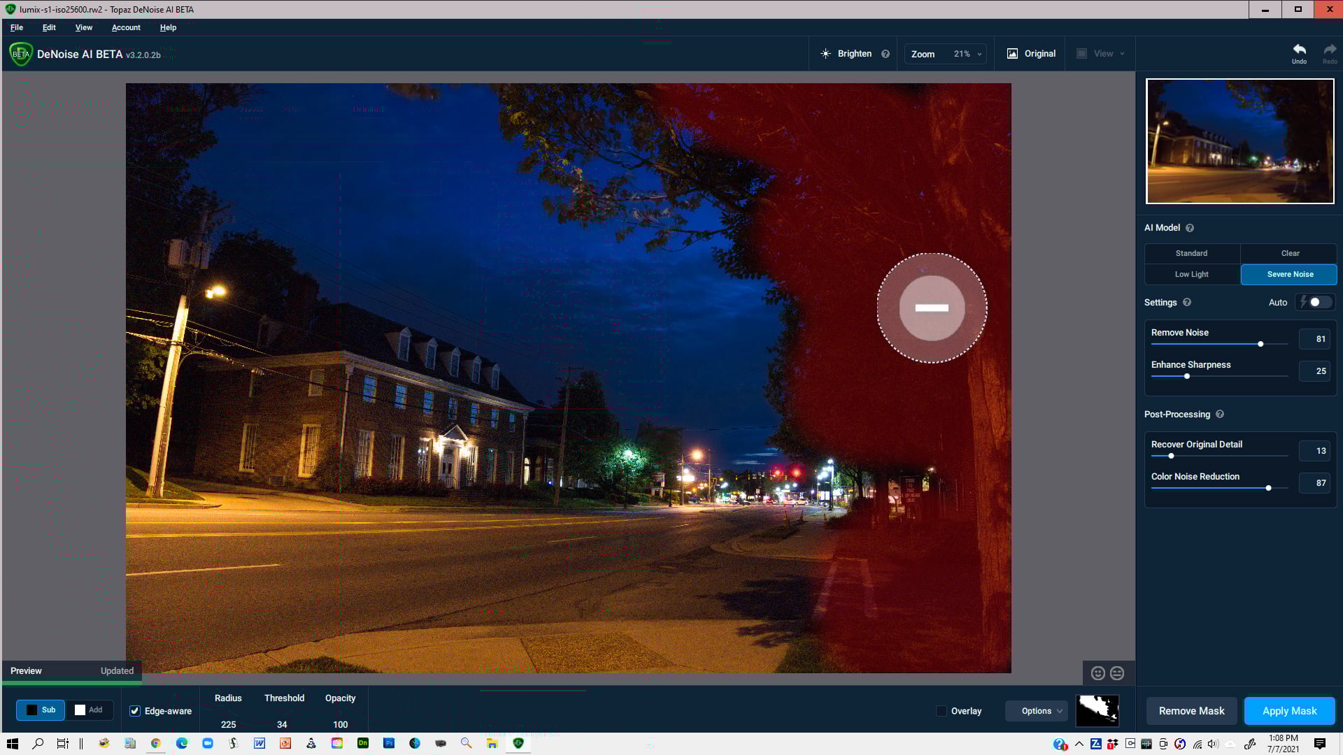

Topaz DAI 3.2.0.2b - Masking Interface with Lumix Raw Image (for comparison vs ON1 NNAI:
Topaz DAI 3.2.0.2b - Masking Brush Color Overlay Helps See Where Painting Mask over Image: [Edge Aware is set to on, but doesn’t conform well to edges - doesn’t matter if complex like leaves or smoother edges… unlike ON1 NNAI which seemed tuned to cling to appropriate edges]
Topaz DAI 3.2.0.b - Snip of Sky DeNoised and Ground Elements Masked to Retain Look of ORIG Image (for denoising comparison…):

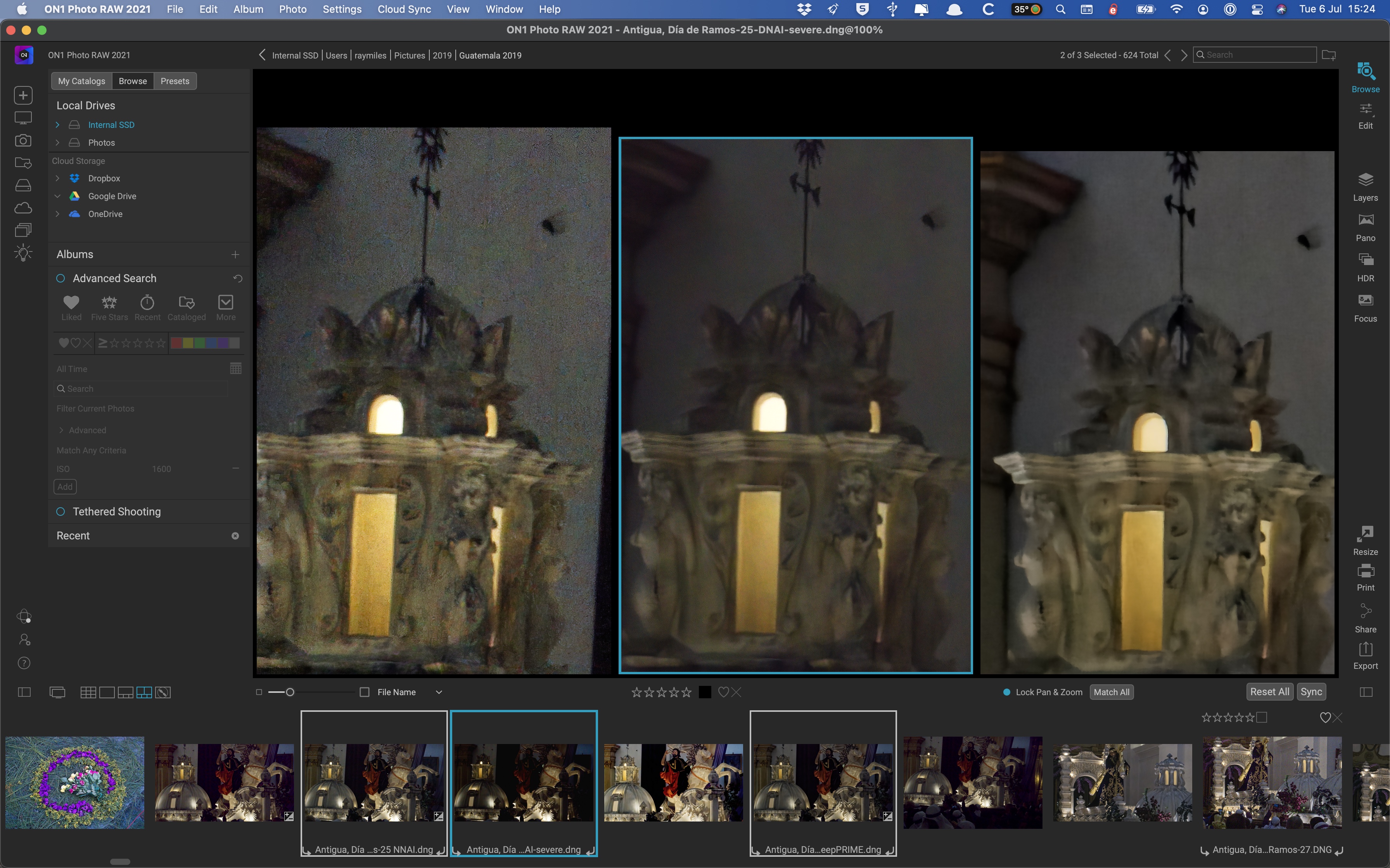

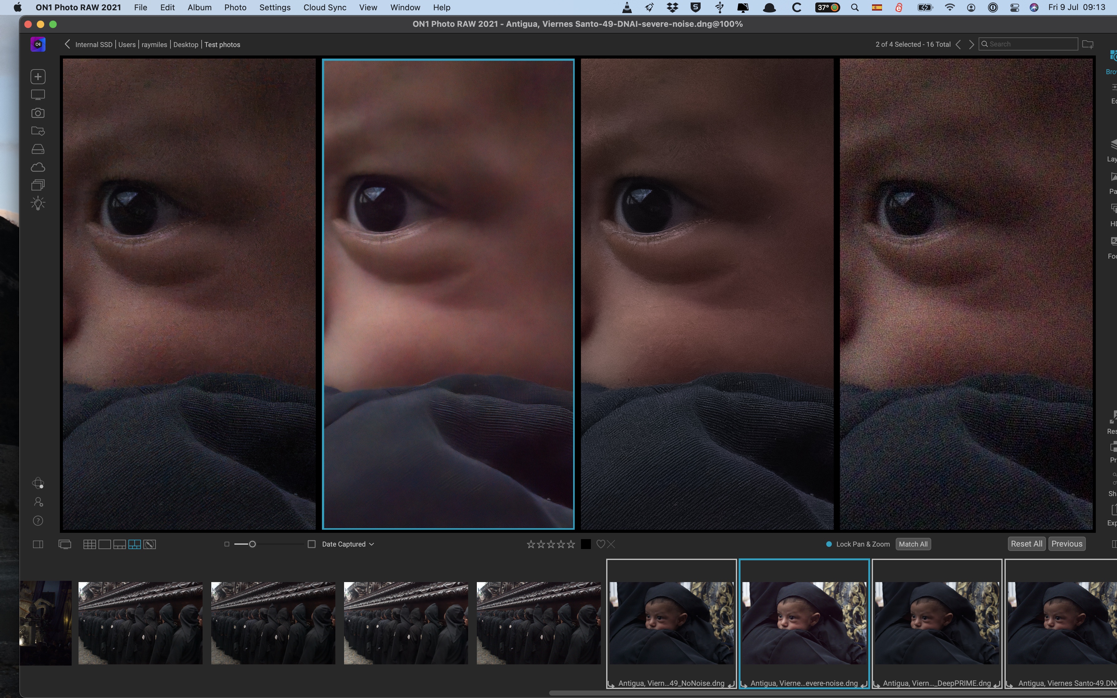

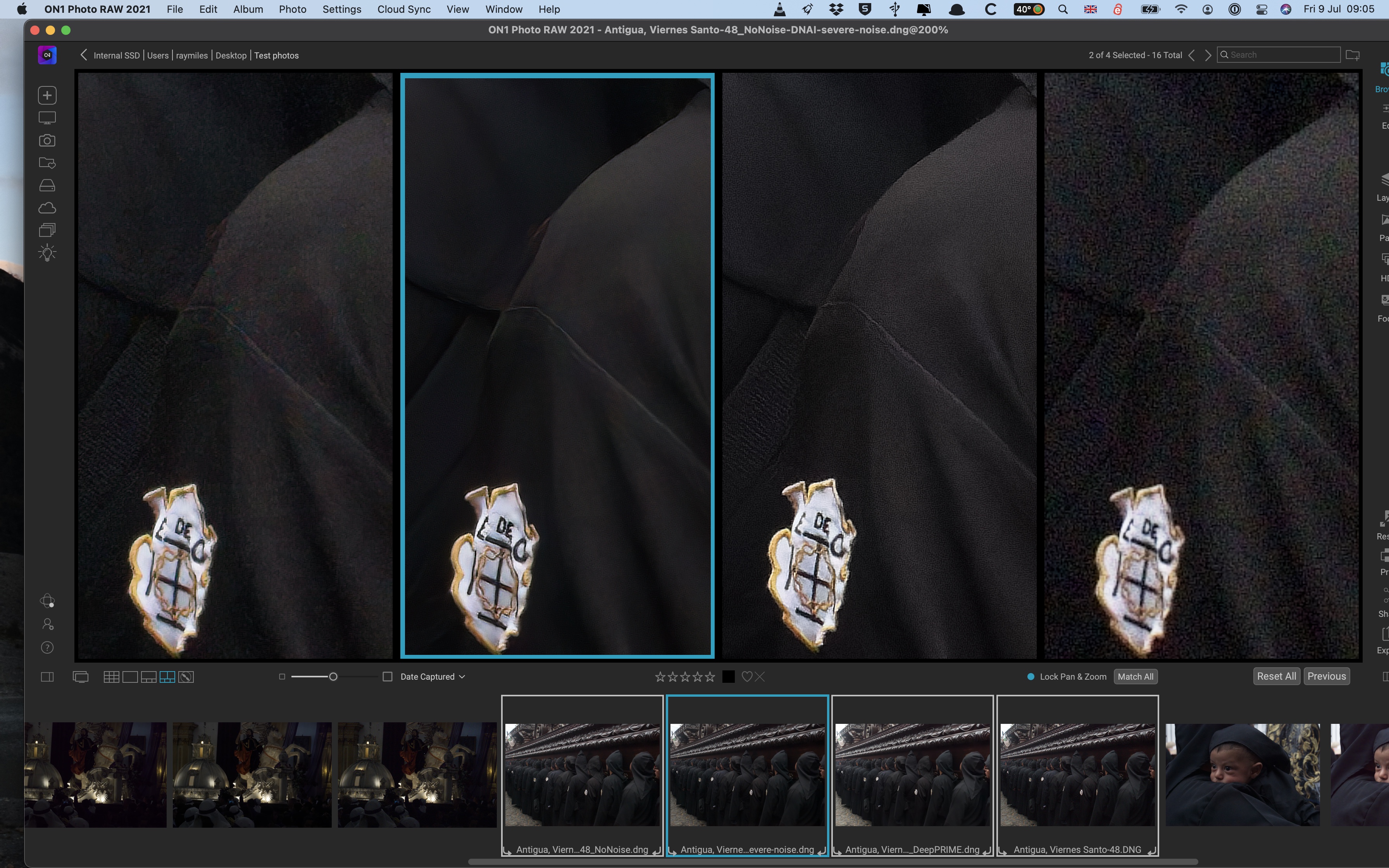

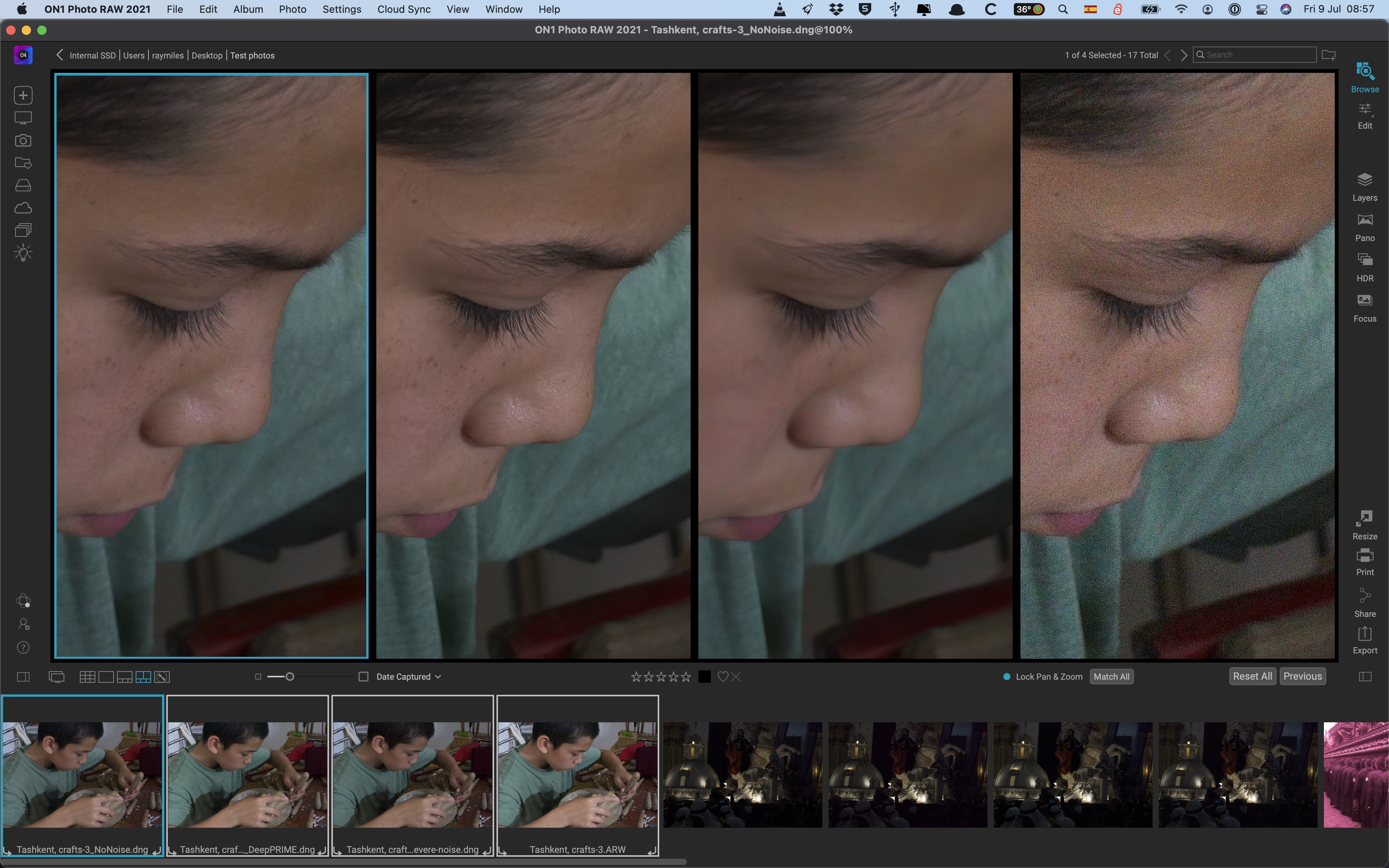

I thought this video on YouTube offered an interesting comparison among NoNoise DeNoise and Pure Raw. He did not test the masking features or a shot taken at especially high ISO. He though all three programmes did a good job, with some differences where one was better than another in one area and not in others etc.
This shot was taken indoors at ISO5000.It’s an ARW file and in all three instances it was converted to DNG for denoising.
As I have noted before (and no one else seems to have commented on this or explained why) the DNG created by DeNoise AI is almost twice the size of the other two: 114 v 87 and 78 MB.
I set Denoise to severe but maybe it would have done a better job in standard mode. Look at the freckles and the shininess around the nose!
In the past, DeNoise struggled with black tonalities at high ISO. It’s got better, but still not great. Again, I might have achieved a better result with DeNoise if I’d chosen a different model. NoNoise also struggles with the colour noise, even though the slider is set in auto mode at 100%. Pure Raw is totally automated so there are no sliders at all. However, it did by far the best job in reducing colour noise as well as retaining the textures of the black fabric.
DeNoise using GPU is the fastest of the 3 programmes on my MacBook Pro, Pure Raw the slowest: but there isn’t a huge difference.

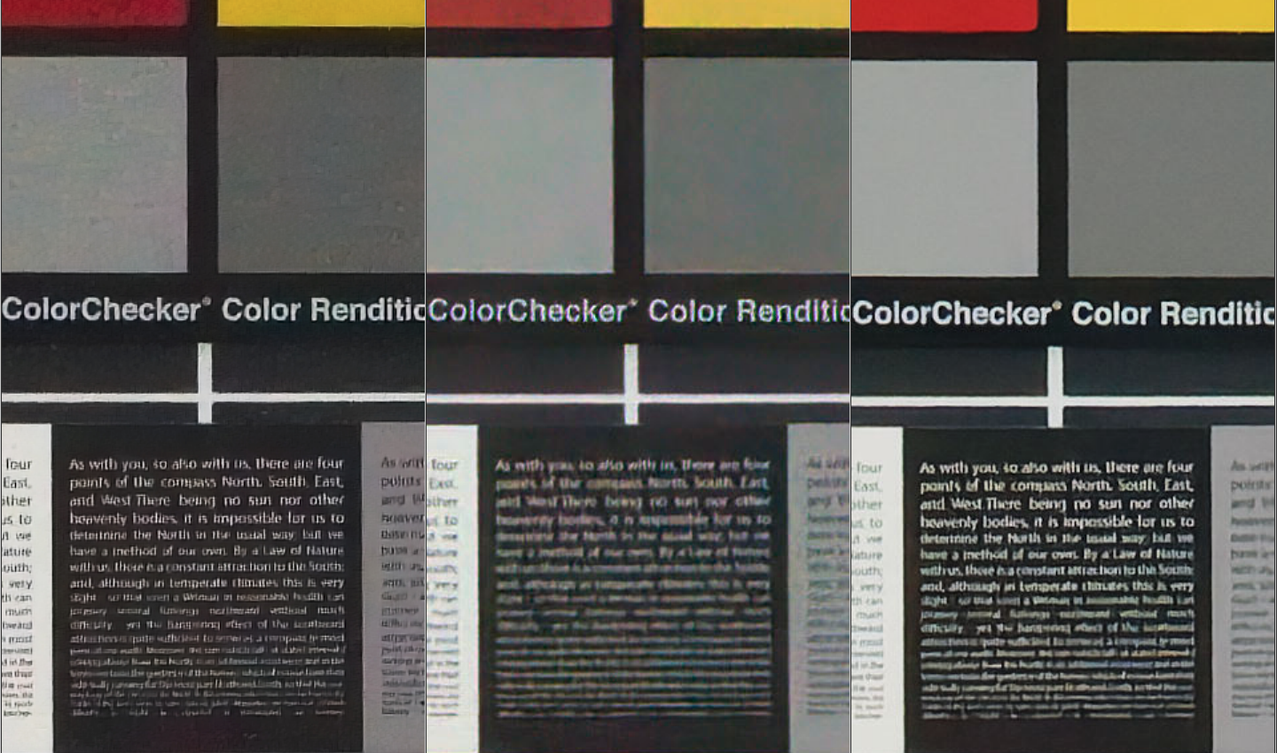

This next and the previous image are ISO12800 and were shot hand-held in low light. All 3 using the auto setting (in Pure Raw there is no other option)
NoNoise still has a lot of luminance noise, which might be improved if I had used the slider. DeNoise might also be improvable using a different model and adjusting the sliders, but in severe mode, the black tonality is off and the texture of the fabric is intermittent.
