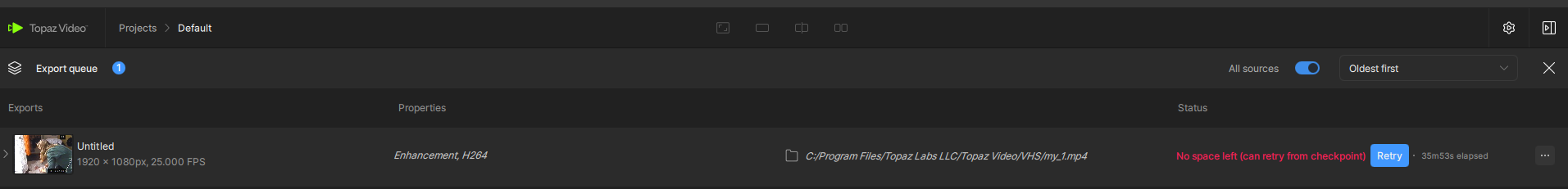

I am experiencing a repeatable issue with Topaz Video AI.
After 30–40 minutes of exporting, the job fails with the error message:
“No space left (can retry from checkpoint)”, even though I have hundreds of GB of free space.
Setup:
Topaz Video AI version: 1.2.1 (2025 Release)
OS: Windows 11
CPU: AMD Ryzen 9 9900X3D
GPU: NVIDIA GeForce RTX 4070 (used as AI processor and encoder)
RAM: [doplníš např. 64 GB]
System drive C: has ~772 GB free
Export drive (tested I: and C:) has well over 200 GB free
Project details:
Source: VHS capture, PAL 720×576 → upscaled to 1920×1080 (FHD), 25 fps, progressive
AI model: Proteus, manual settings (Fix compression ~13, Improve detail ~24, Sharpen ~3, Reduce noise ~15, Dehalo ~8, Anti‑alias/deblur 0)
Export: MP4, H.264, Constant bitrate 20 Mb/s, audio Copy
Clip length: about 75 minutes (I also tried shorter ~35–40 min segments)
What happens:
Export starts normally and runs for about 30–40 minutes.
GPU usage and temperatures remain normal.

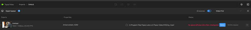

Then the export stops and shows: “No space left (can retry from checkpoint)”.
Windows Explorer still reports more than enough free space on all drives.
The same happens whether I export to drive I: or to drive C:, and after a full PC restart.
What I already tried:
Changing export folder (different drives and folders, no diacritics or special characters in paths).
Moving Workspaces/Projects folder to a different drive.
Disabling / enabling “Use temporary directory” in Crash recovery.
Splitting the 3‑hour VHS capture into shorter parts and exporting only ~75 minutes.
Closing and reopening Topaz between exports.
The issue keeps repeating, so it looks like a bug rather than a real disk‑space problem.
I have attached the log files generated via Help → Save log files, plus a short sample clip and my preset so that you can reproduce the problem.
Could you please check what is causing this “No space left (can retry from checkpoint)” error and suggest a workaround or fix?
If you need any additional logs, screenshots or project files, I will gladly provide them.
