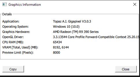

I tested the image 4000x3000, enlargement 6x at 24000x16000. Process time 2 minutes 43 seconds. I think it may be more demanding for a GPU. I have the Radeon R9 390 graphics.
More detail:

I found the Use GPU switch … it is a lot faster than I originally posted!
