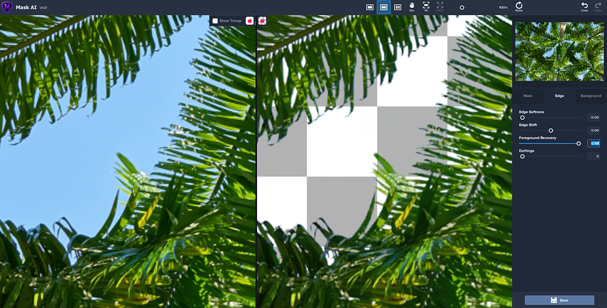

There is some refining tools in Mask AI that I have seen anyone take about yet. I masked the tutorial tree and it did a fantastic job

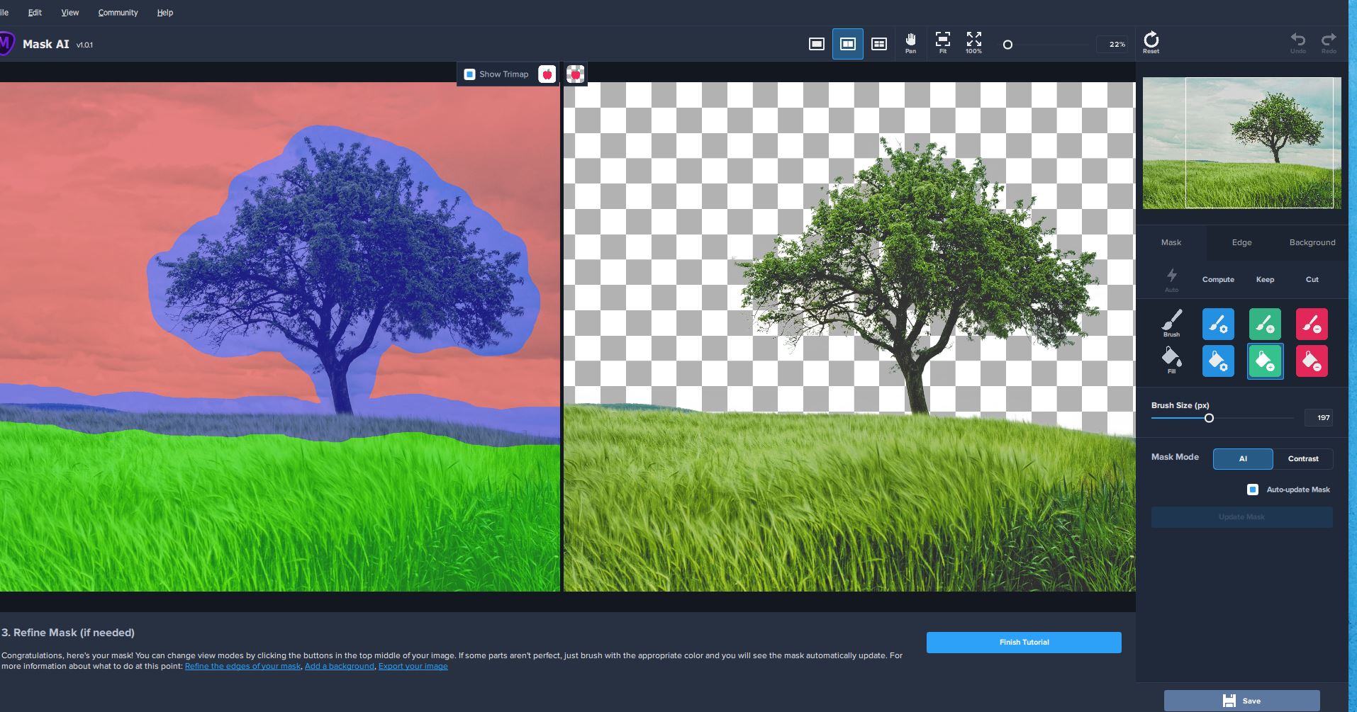

I’ll give you my examples
Started with the blue brush filling in the tree, and across the horizon, then filled in with green at the bottom. With the very first try it did an amazing job of masking the tree.

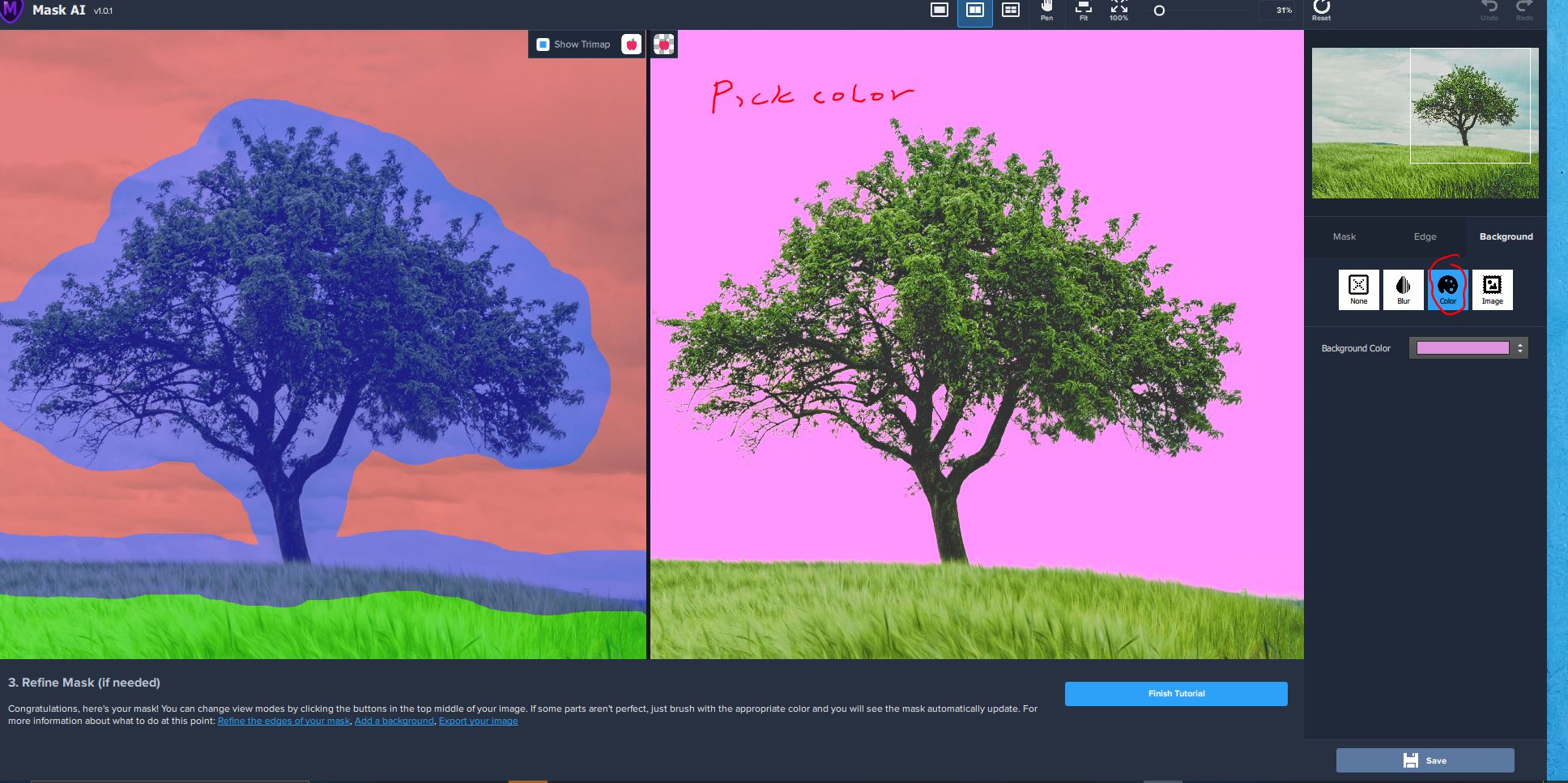

Step 2
I choose a contrast color to find any area that need extra work.

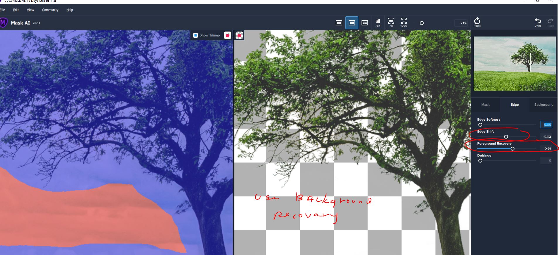

Step 3
On the tab go to Edges and you can refine the mask using the Edge Shift and the Foreground Recovery.
So far I use Foreground Recovery most to the time.
Step 4

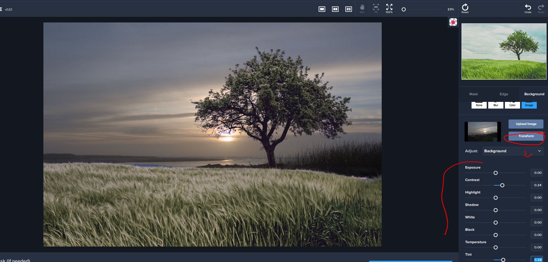

Adding a background. This is one of the areas that I like about Mask AI is the ability to add a background and adjust the foreground and the background to make it blend into one image.

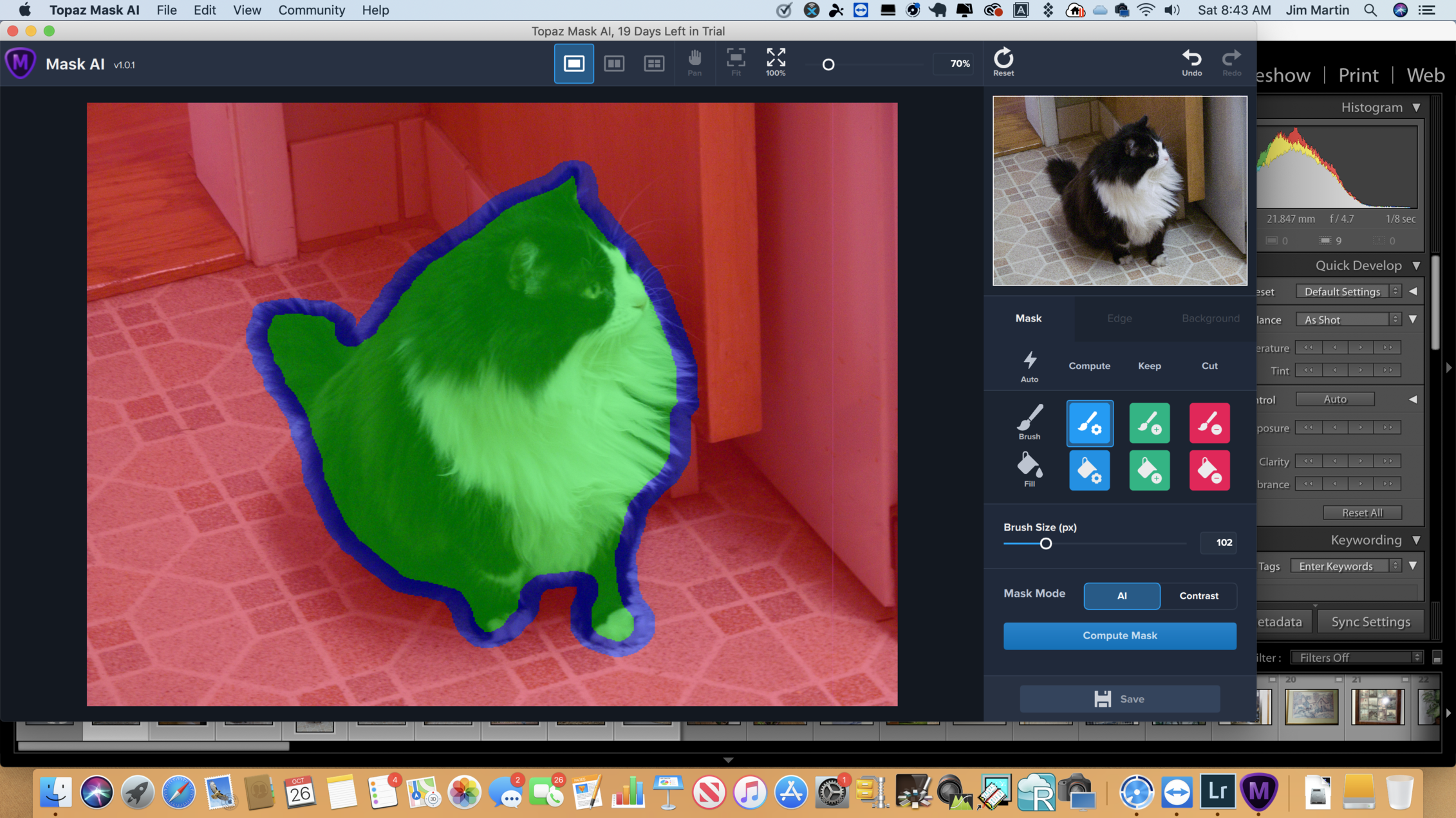

MaskAI did well on my cat Photos,where there is good contrast in color.
I would encourage trying out on colors that similar.But not too.
Even a Solid color Similar to out side of Subject as background.
See, so there you go. Do cats like squirrels? Maybe MAI is part cat… ![]()

That is a fluffy cat! Good subject for masking!!!
