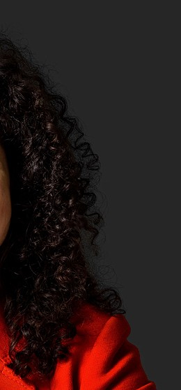

Here is a sample image provided by someone on the DPreview Retouching forum

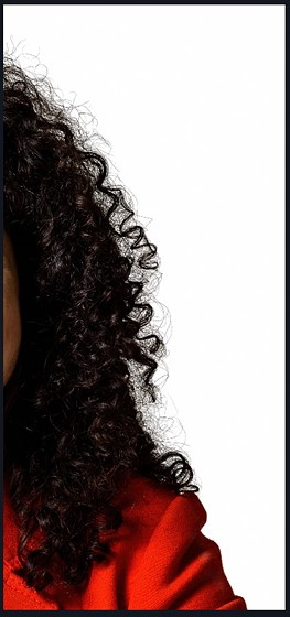

First, here is a Mask AI result and against a light background the cutout looks ok

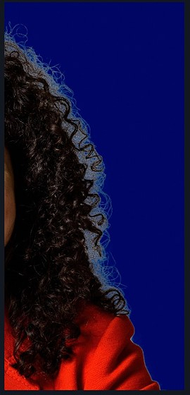

But against a dark background it is unusable

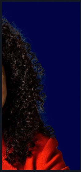

With Foreground recovery cranked all the way up you get a better result but still not really usable
You have to switch to Remask AI with its tools to get a usable result
