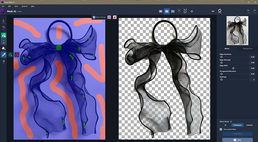

Noticed that the Transparency feature does not work like the old one on Remask. Any tutorial on the finer points of using it? Does not do a great job on something like a bridal veil mask. Hard to get right.
Hi, The Translucent Mode is quite simple as you can see from this example. Reset to Mask then just use the Red/Green brushes to indicate the background to cut and the foreground to keep. Then Click on Translucent and press Compute Mask … this is the result after 20 brush strokes:
