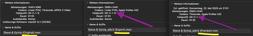

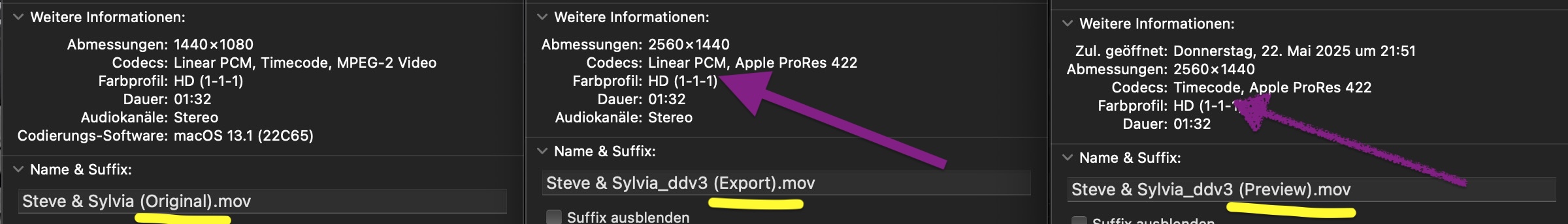

Timecode kept in preview, but not in „real“ export
I just discovered, that Video AI maintains the source timecode in the generated preview file but not in the „real“ export. But in the preview file, the sound is not exported. So we can either have time or sound.

I think I found the „secret“: You have to stay in the same codec and the same frame rate and copy the audio.
I converted some NTSC videos to PAL in Compressor, which is much faster (and feels even better to me). I did not change the picture sizes (only 720x480 → 720x576 NTSC/PAL size switch), I already added the 8 audio channels I would need later. I always switch to progressive. The best codec for that is, in my view, ProRes LT as MNX not MOV. I keep the original time code in this conversion.
In Video AI, I tried different models but stayed with ProRes LT and Audio Mode Copy (hoping to keep the 8 channels).
After I finished, I was about to reconvert the Video AI file in Compressor to get the time code back. I was surprised. I was still there.
So I guess if I don’t change the codec and the frame rate, the time code will stay.
