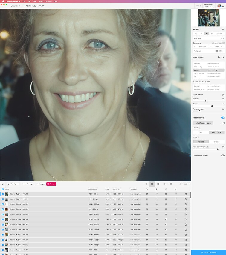

I have opened a folder of 144 low-res images and I want to run them through auto-pilot with face-recovery and exported.
All of the new files say that “-faceai v2” was used, but after the first n number of images, it doesn’t not do actually face detection.
Here you can see Face Recovery is turned on for all images:
and here you can see that sometimes while processing things, the icon shows no Face Recovery, as seen here:
Am I doing something wrong?
How do I define settings to run on a batch of images?
It would be great to have a dust removal option for recovering older photos.
In some images, Gigapixel seems to add more “dust”/white flecks.
Thanks,
Brian
  • I figured out that I would need to go through and review all 144 images in the collection I wanted to process for proper face detection. I also did cropping as needed.
  • I selected all and did an Export of everything.
  • After processing was complete and I closed the Export window, in the list view it showed under the Face icon “Off”
  • I just experimented and enable face detection on a single image, so in the list it shows it at 80. Exported. and Face Detection was off as displayed in the list again.
  • I feared I lost all of my customizations. But in reviewing the images the cropping looked good, but face Detection was off.
  • So I selected everything and clicked on Face Detection and it turned it on for everything again (showing 80 in the list display).
  • It looks to be where I think it should be.
