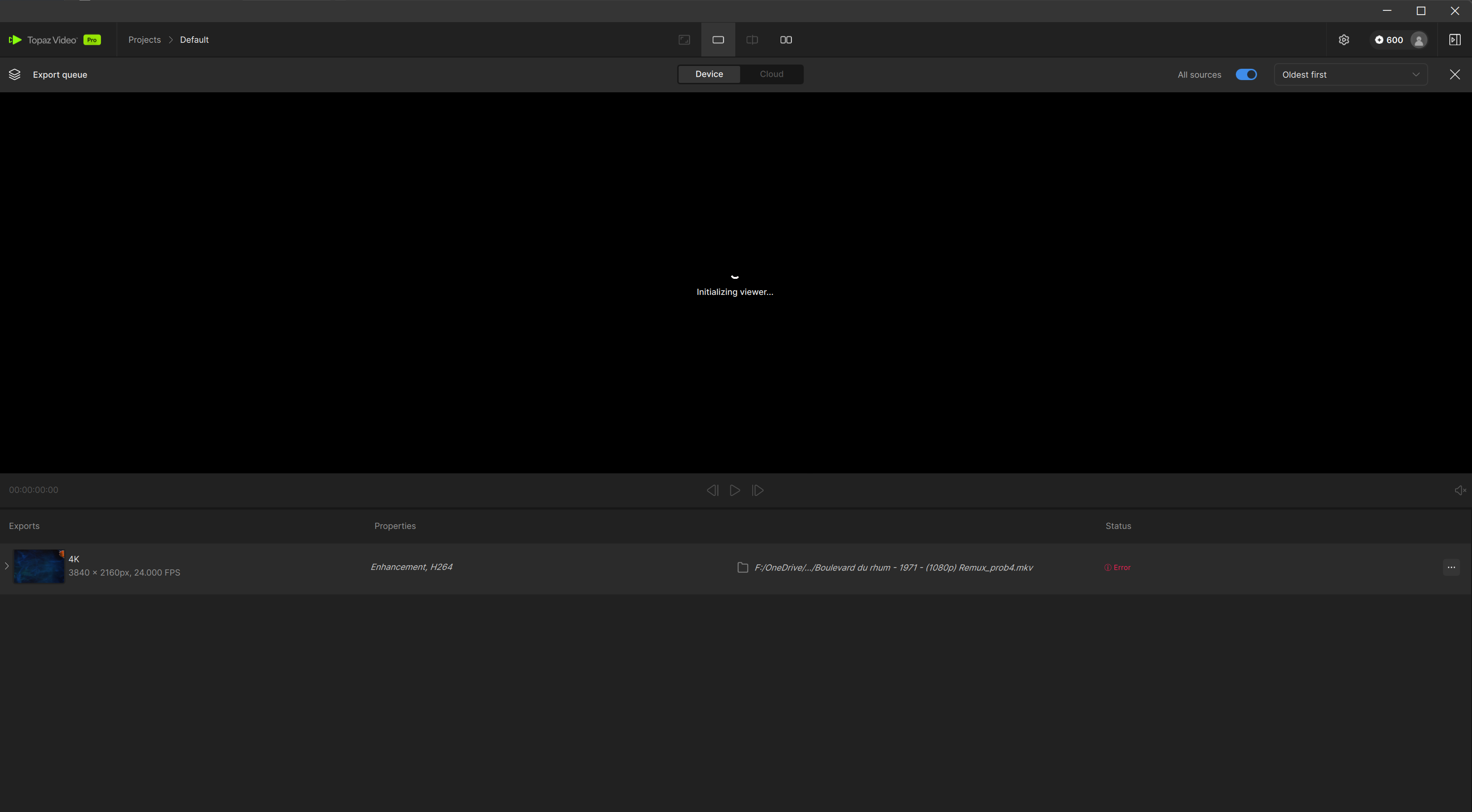

Issue with the status
logsForSupport.zip (903.6 KB)
Which status are you referring to and having issues with? Can you post a screenshot for reference?
If the issue is in the UI display, that will be needed for troubleshooting.
Hi
Thank you for sending the logs and those screenshots.

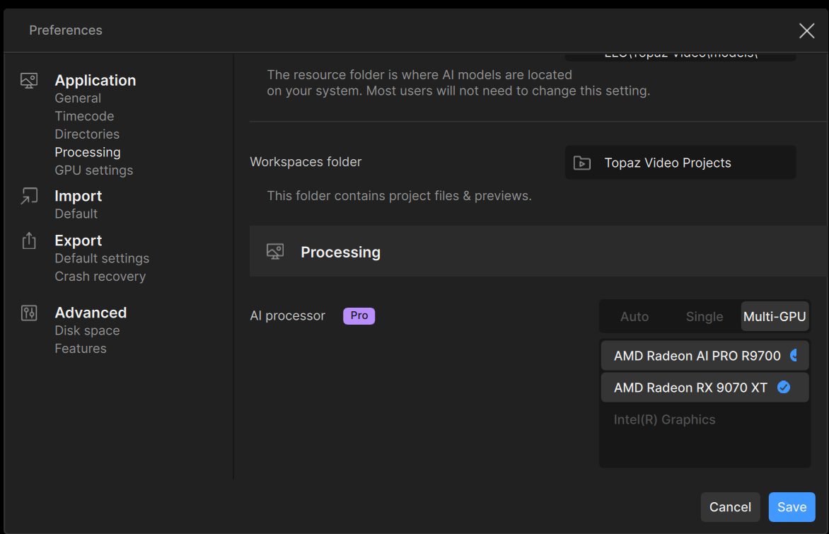

Swap the AI Processor to use just the Pro R9700 card and the process should complete without further issue.
The team is looking into some issues right now where multi-GPU is not working with different cards.
