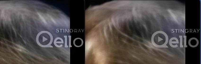

I found that - at least with the current iteration of SLM on the Mac - text and logos are handled much better if you use a 4x upscale.
left: SLM 2x, right: SLM 4x
Unfortunately that takes forever…
