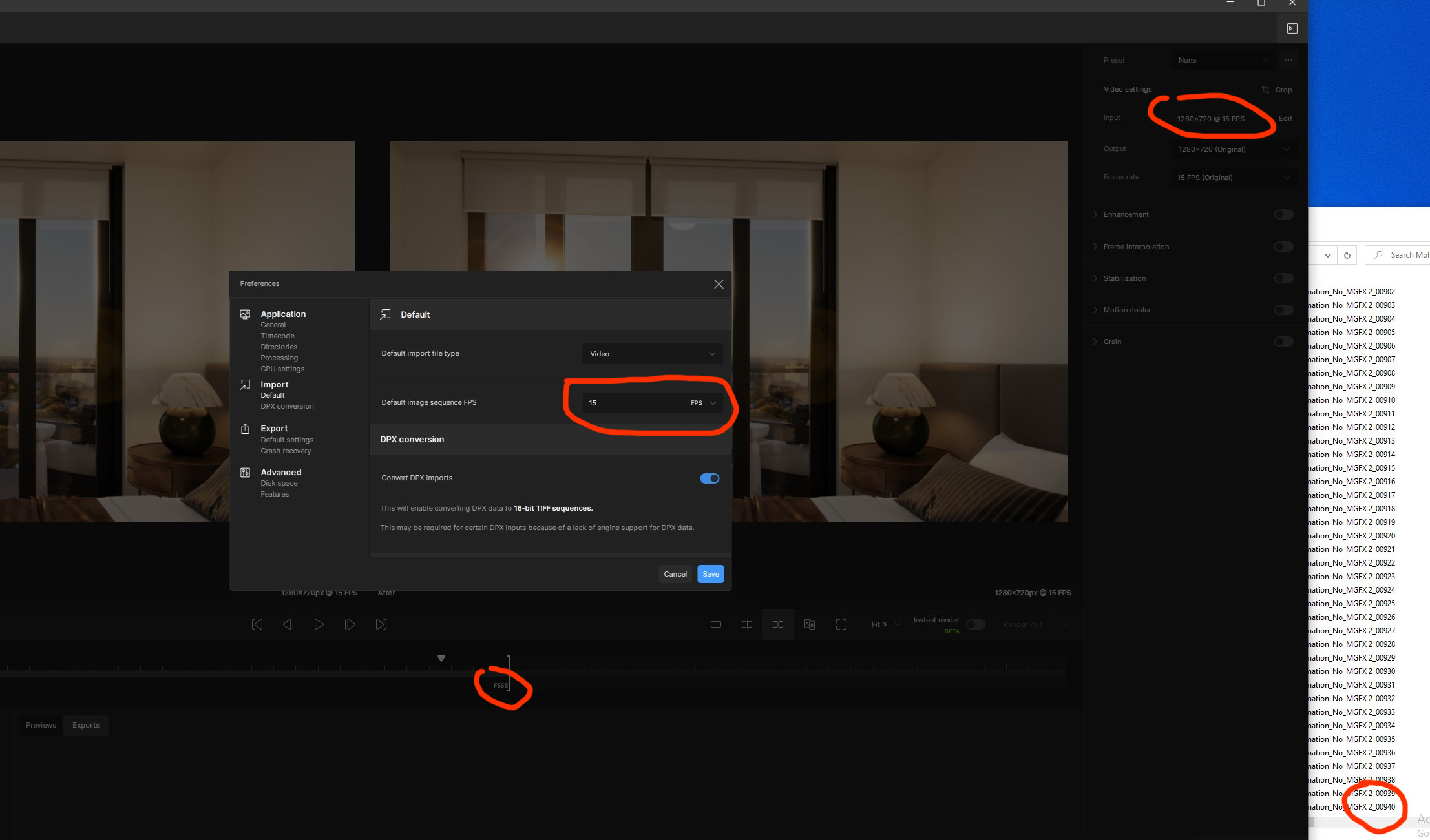

Hi, I am experiencing an issue with what I think is a wrong frame rate. I have an image sequence of 940 frames rendered from 3Dmax at 15fps. I want to use Video AI to make this a 30fps sequence while maintaining the same video length and generating the new frames.
When i import my sequence it shows the whole video but says its only 535 frames or 37:10 seconds. 940 frames at 15fps should be 62.667 seconds.
I assume I am doing something wrong but cannot for the life of me figure out what it is.
Yeah, I already found that setting, changed it to 15fps and restarted. It correctly imports and says its 15fps but It still shows the incorrect number of frames/length of sequence.
One other note. If I ignore these issues and export, it actually will only export the 565 frames as if it is running at the correct 15fps. But only 565, not 940. So the output is roughly just the first half of my initial sequence.

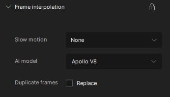

So here’s an image sequence I have. I set the input to 23.976 and the output frame rate to double that.
That enables the frame interpolation model.
Make sure ‘Duplicate frames Replace’ is unchecked. It does not, nor has ever, worked. Apollo is the best all around interpolator. You can try the others, but they’ll probably be worse.
