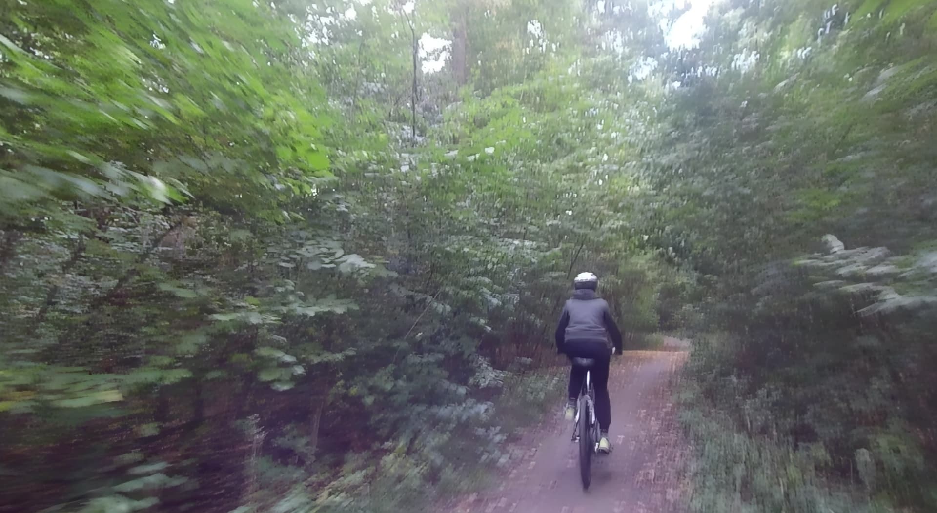

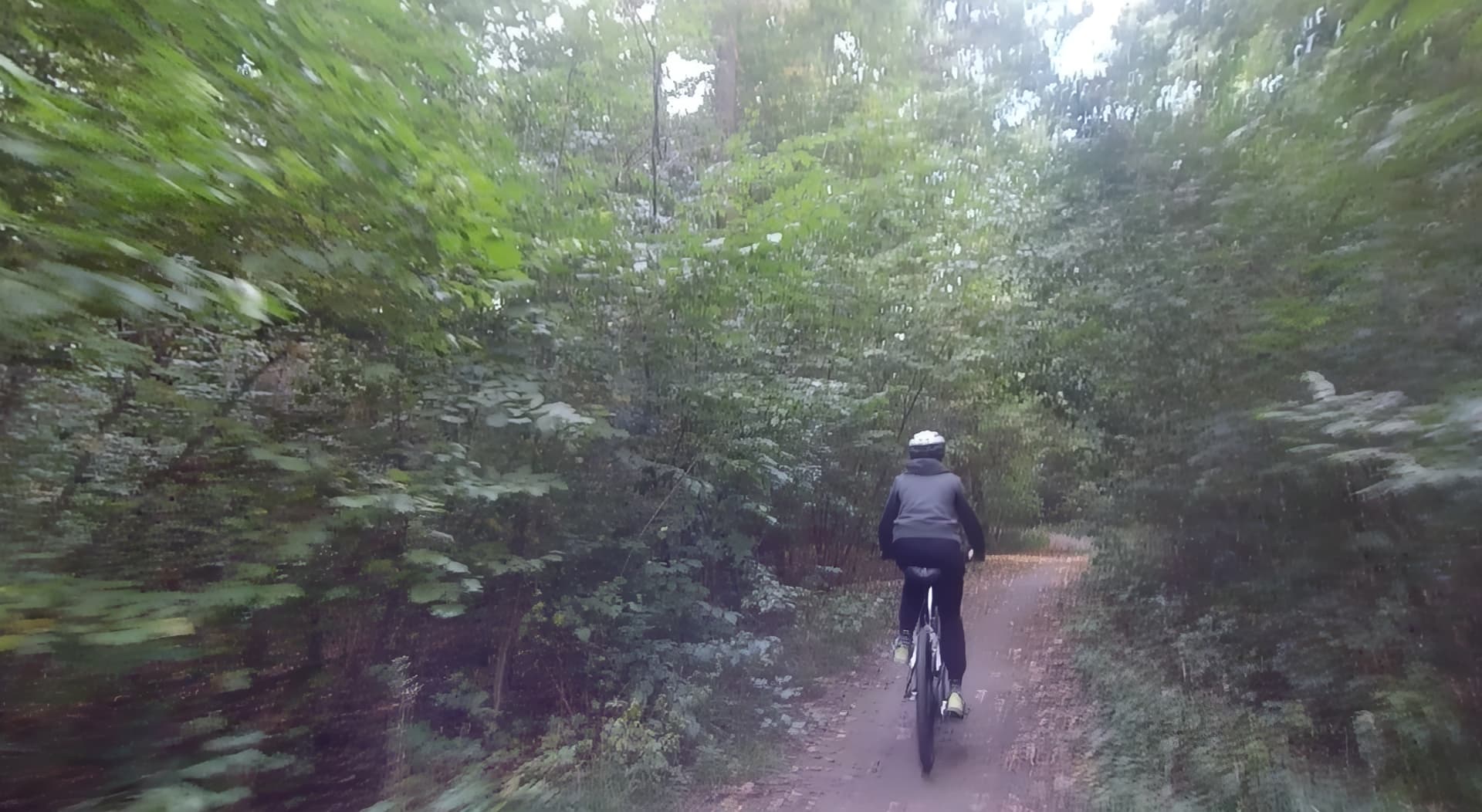

Image too green after Proteus filter?
Does the image look too green after filtering (Proteus)?
I haven’t tried other filters.
Depending on the original source materials’ color profile the models can cause some color shifts. However, these screenshots are looking pretty even in color values.
The source is AVI/FFV1/Rec709, manually confirmed in the program, and the output is in the same format, so there shouldn’t be any color shift. Thanks for the reply.

1. Regarding the difference between RGB and YUV sources.
It’s not the source that’s the problem, but the CPU or GPU usage.
I get the better image (those screenshots incorrectly labeled as YUV) using the CPU (device=-2 in the command line), and the worse image (the screenshots labeled as RGB) using the GPU (device=1, Radeon).
But! But not in every frame. Some frames are the same, while individual frames are different, just like in my screenshots. It’s as if the filter wasn’t working properly using the GPU. I’ll generate short clips and post them.
