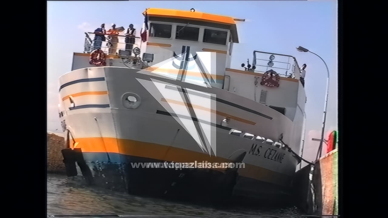

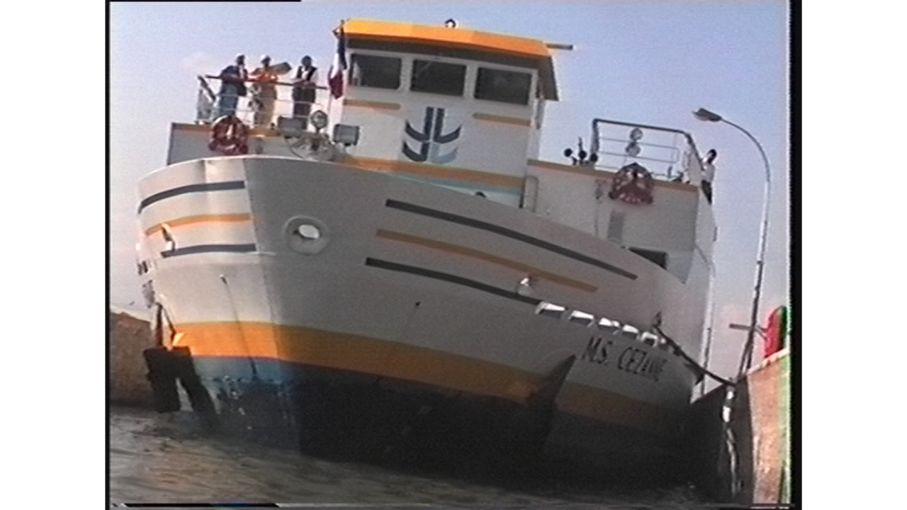

here is the comparison of two different scenes in three images.
The first, the original, the second, the improved version without final grain and the third, improved with final grain
Well, if you have any questions, I’ll try to answer haha, I’m really happy with these results because I have a really minimal loss of detail, in most images all the original noise is removed, the artifacts too, and there are more fine details. I will even be able to produce my videos without adding grain so much detail is preserved, but I prefer the final grain which gives the impression of having more detail, which can hide minimal artifacts and which gives a cinematic look, for our old family videos, it looks more professional I think :slight_smile:

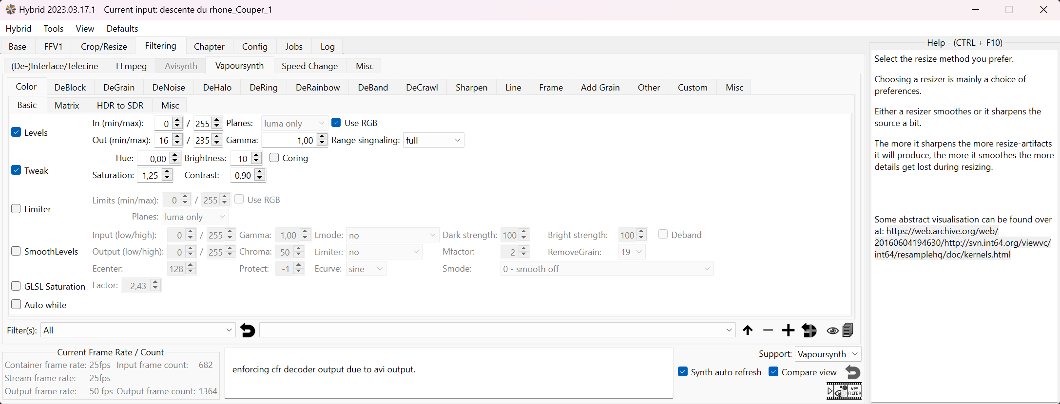

Hallo, ssbroly, thanks for your detailed workflow for Hybrid. I followed exactly all steps, but Hybrid converts only 1-2 frames. With default settings however, it works. Could you help here please?
Hello, 1 to 2 images? In fact I recently discovered that you can export to PNG with Hybrid, if you’re talking about export. It’s the same quality as the ffv1 almost pixel-perfect after comparison. But the image sequences open with everything, including vegas pro. :wink:
Thank you for a quick answer. I wanted to say that something is wrong with the settings or I do something wrong. I insert a clip that is 1 min long, but the output file lasts 0 second (has only 1-2 frames in it). Playing around with Hybrid I changed β€œvapourtsynth” to β€œavisynth” and it suddenly worked! But there is no option EZkeepgrain: 8. I hope I explained my problem clearly. Could you help please with this problem? Thank you very much in advance
in the second photo, ezkeepgrain is in the qtgmc settings
