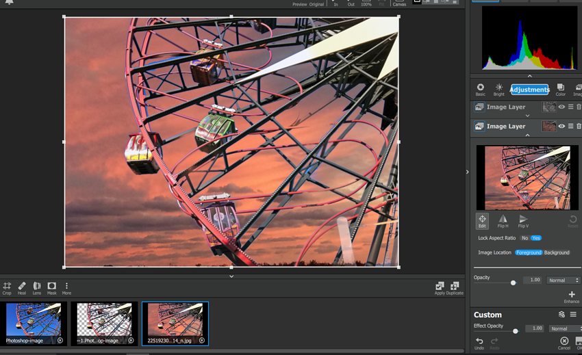

The easiest way is to upload the building picture and the sky picture to Studio. as Image layers. The sky being the background. The building image as the foreground. Use the masking brush on the building image and the sky will come up. The masking brush to the left will completely mask the area, to the right will bring up the original sky Reduce the brush radius and softness to cut around the buildings as close as possible. If you go too far you can reverse the process to bring it back and try again…If you need to refine it further use the Adjust to feather and/or extend the mask. Explaining this is difficult but maybe the image of what I’ve done will help.

Do you have Remask? If you do, use the Plug-in in Studio to delete the sky…Use the result as a foreground, sky as background. Quick Remask job…not the easiest subject to tackle…

Looking at the image you are trying to mask I don’t think there is any easy way other than masking using ReMask. Blow it right up to maximum to get those fiddly bits and use shift and click to create the straight lines. It will take some time. Until you are certain always save your mask in ReMask (bottom left menu).

Joe…Not clear, is this a Remask process result you’ve done? My example up above was a very quick render to bring out the transparency since I didn’t want to spend the time just to give an illustration, Certainly more time would have to be spent to get a better result. Those thin lines can get lost in the wash.

LOL…I found an image probably the same way…but as you can see…I didn’t pick up that thin wiring. If I were using an actual photo rather than a low resolution web image, I would expect they would be easier to pick up. Using the Color Range brush would probably be the way to go to clear out the small spaces.
Yes - Color Range is the best way. I can give it a shot if the OP doesn’t believe it can be done… I enjoy a challenge

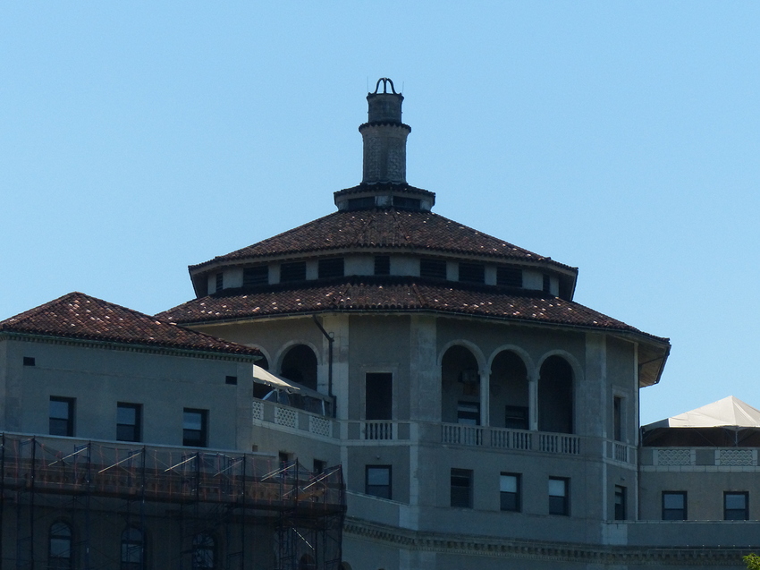

ok- i tried again with a building that was in one contiguous piece. i had a picture of a sky, and placed it in studio and did the same with the building. then i tried to mask- first i tried with the luminosity brushm, since the building was a light bright color. it seemed to mask it ok- but when i hit “done”, nolthing changed in the picture. Trying to make the original sky disappear, and it wont go.
