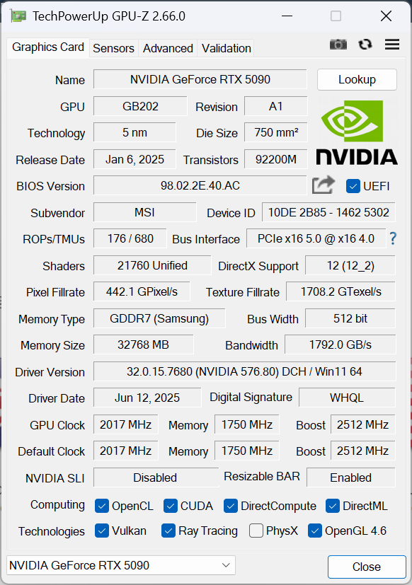

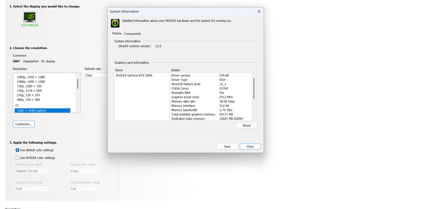

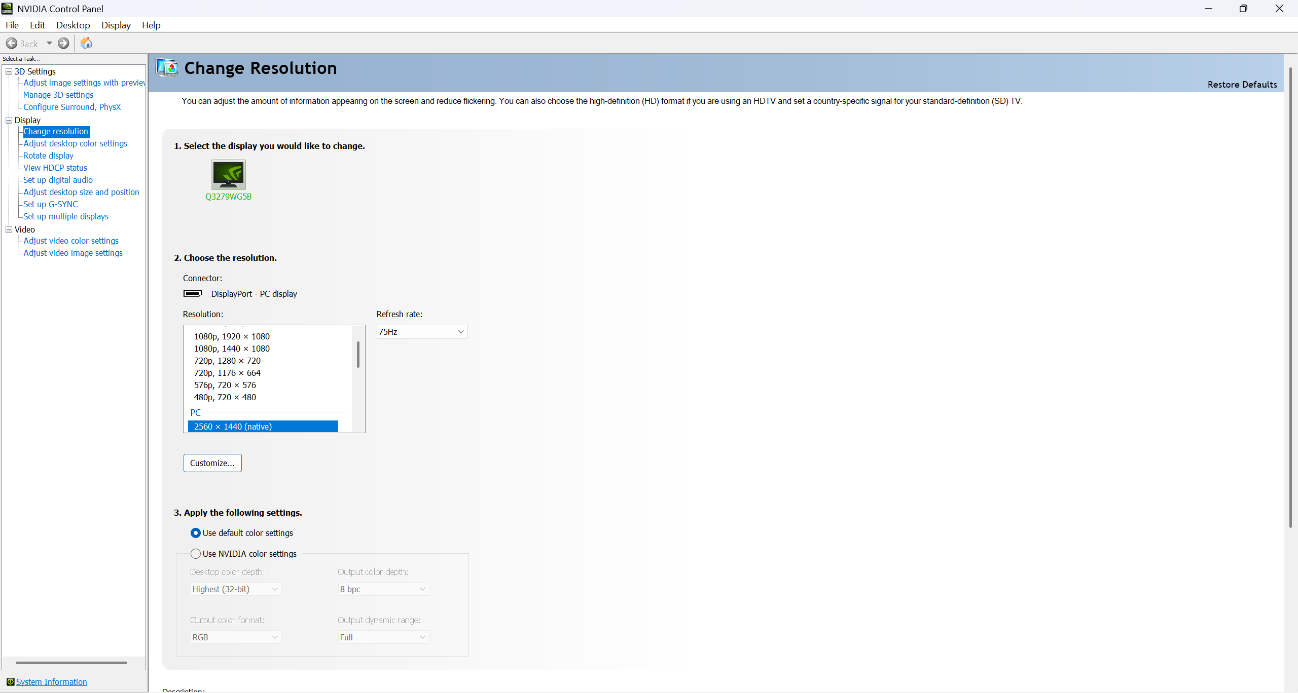

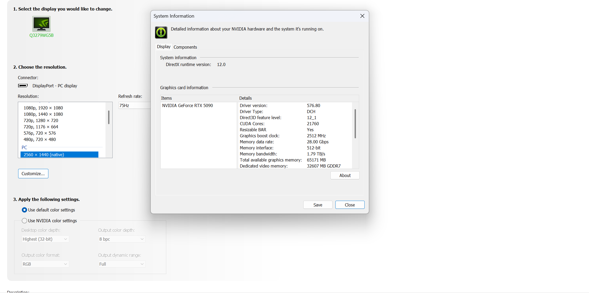

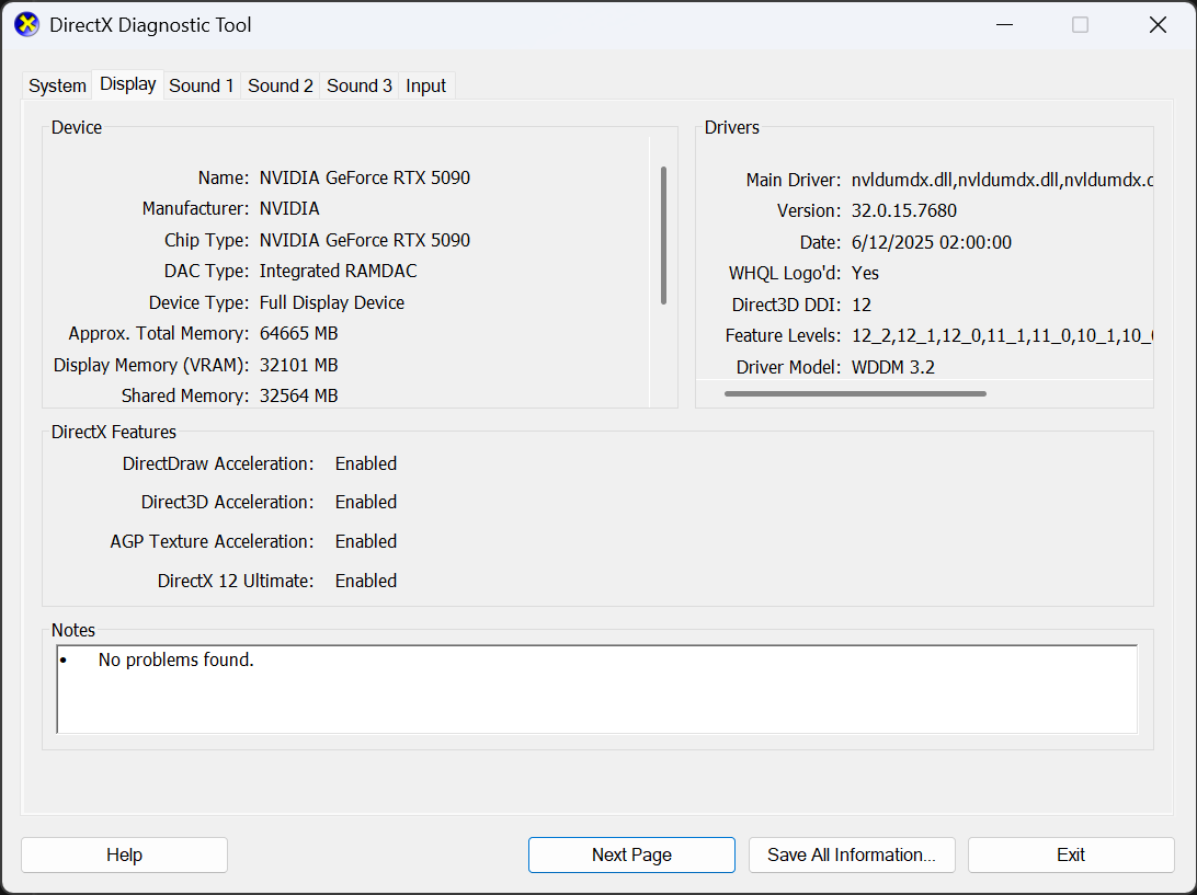

Hi all,
I just upgraded to an RTX 5090. I’ve updated the VBIOS and did a clean driver install using DDU.
I then reinstalled Gigapixel AI to force it to download the new TensorRT models for the Blackwell GPU, but it keeps grabbing the onnxruntime (ox.tz) models instead (see folder list ).
https://pastebin.com/hwV9EWWV
My GPU is in a B650 motherboard (PCIe 4.0), and I’ve made sure the iGPU on my Ryzen 7950X is disabled. I’m guessing Photo AI and Video AI will do the same thing.
I’m attaching logs, DxDiag, and NVIDIA driver info.
Topaz Gigapixel AIcrashpad+logs.zip (8,8 KB)
Can anyone explain why this is happening?
Fixed issue, manually added 1200 to config files. Now it downloading correct tensorrt models and working blazing fast.
nice de-bugging! and thanks for letting us know!
Yes, but unfortunately, not all models are available for Blackwell. I was looking at the model scheme and the downloads, and noticed that while models like HQ and Standard are on the server, gmpv2-13 and others are not. As end-users, we’re left hoping that you will introduce full support for Blackwell soon. :slight_smile:
https://models.topazlabs.com/v1/ggnv2-v3-fp32-128x128-2x-rt1200-10800-rt.tz2

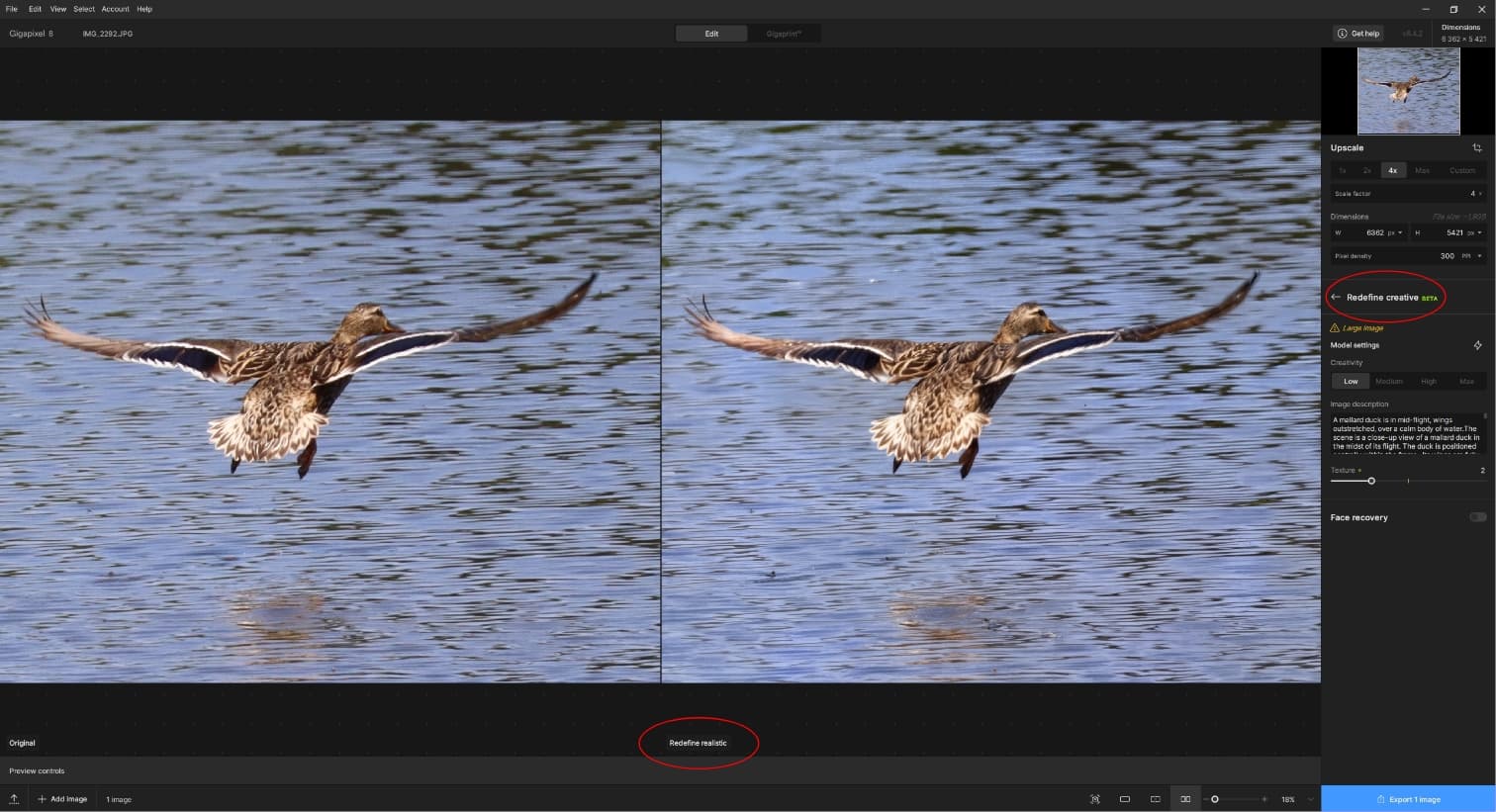

In the next version, it would be appropriate to correct the persistent contradiction about the type of method used – see the text content in the red-bordered ellipses in the attached image.
Version 8.4.2:
Windows 10 Pro, up-to-date.

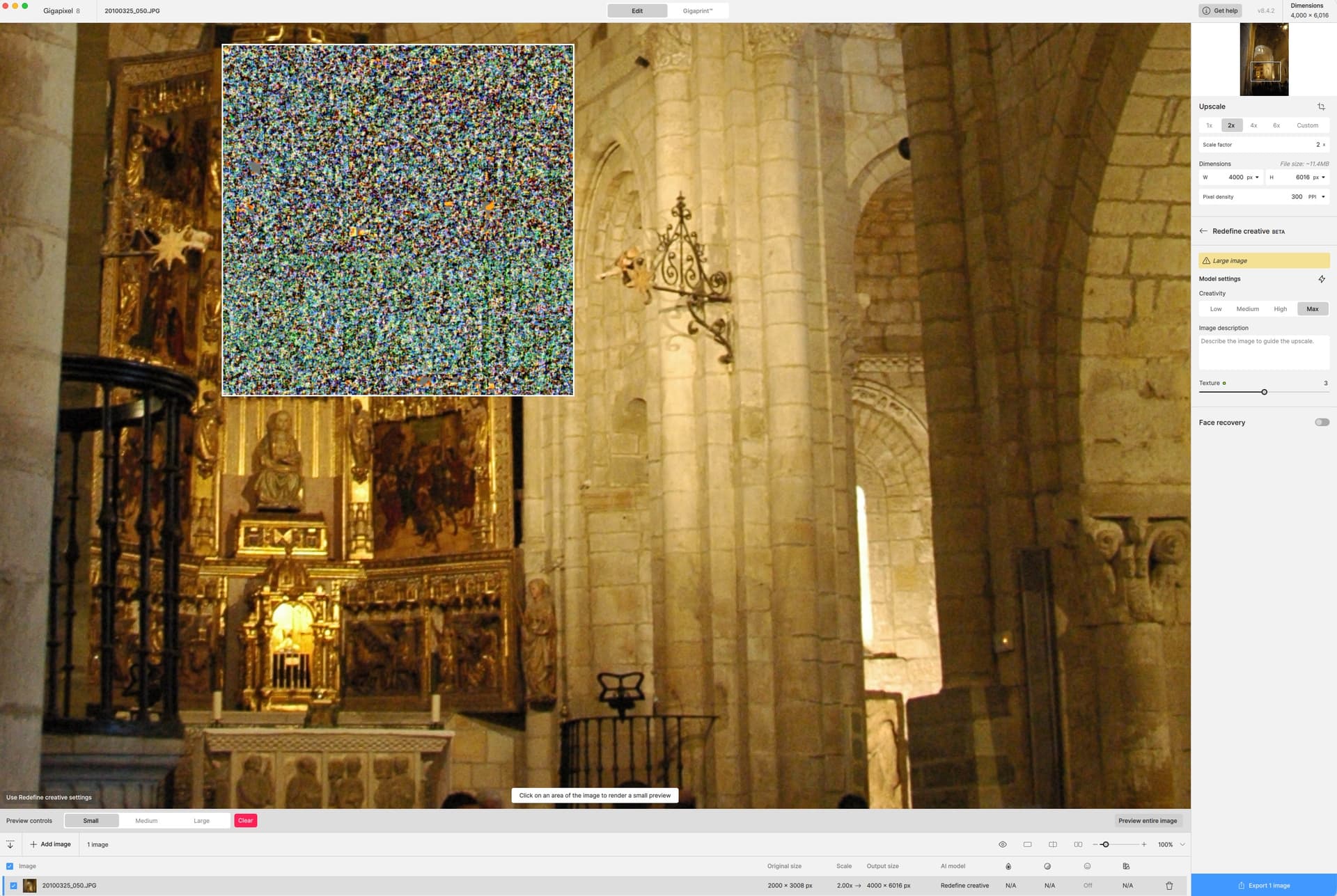

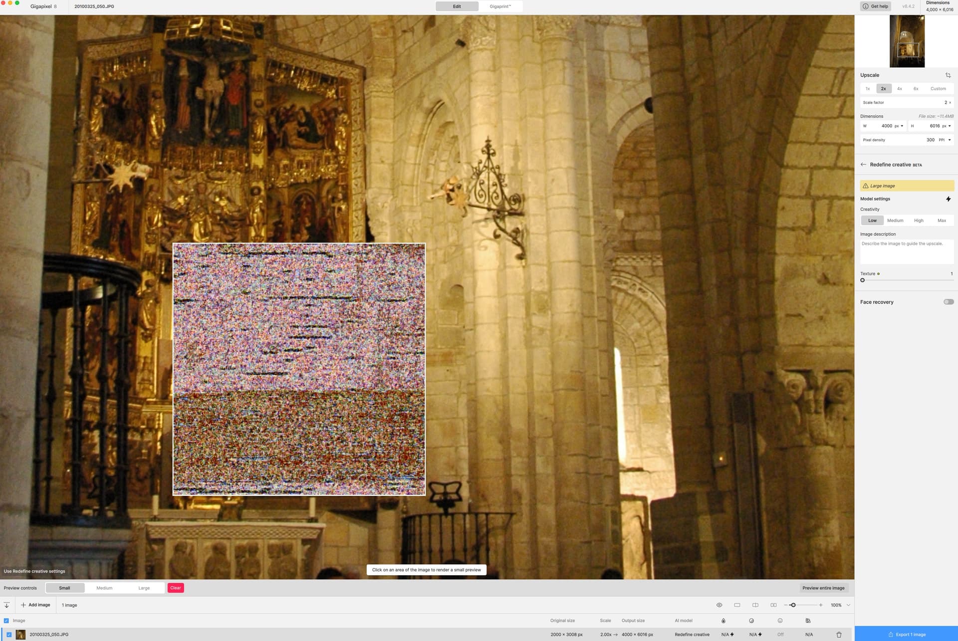

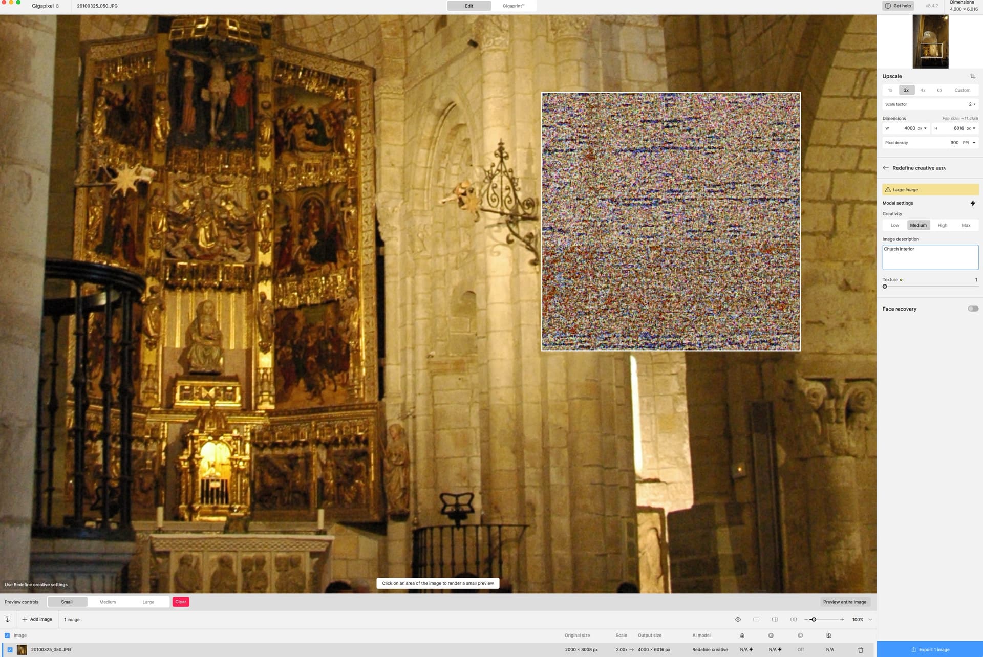

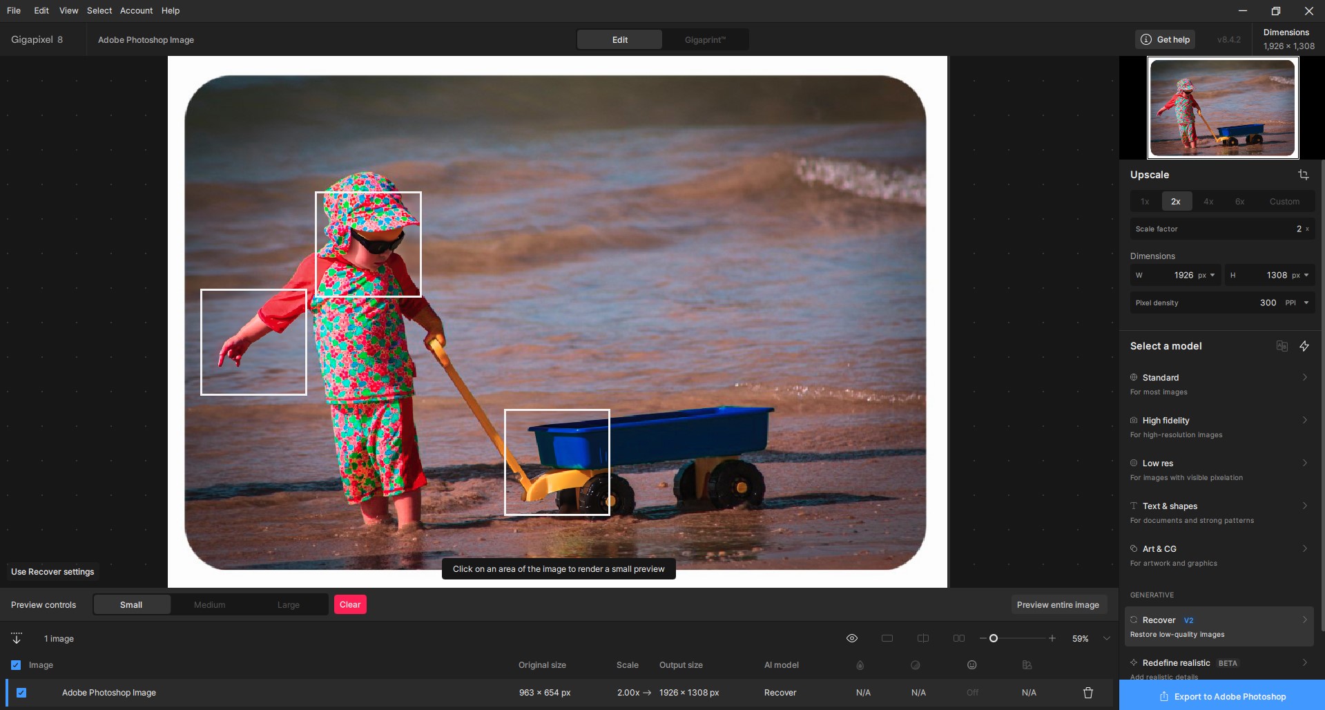

Still broken on Apple M3 (Macbook Air). Tried different Creativity and Texture levels.
Has anyone tested this on M4 (Max)? I’m thinking of getting Mac Studio. If it’s also broken on M4 then probably going to cancel Gigapixel and just keep Photo and Video.

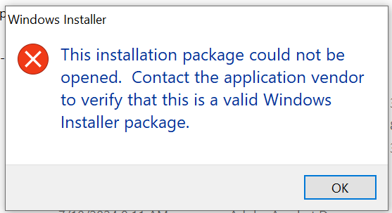

Apparently this was a download error, and a second attempt corrected the problem. Never mind!
As far as I know from many previous forum post. It only happens to M3 based system. M1,M2 and M4 doesn’t have this issue. Just M3 users.

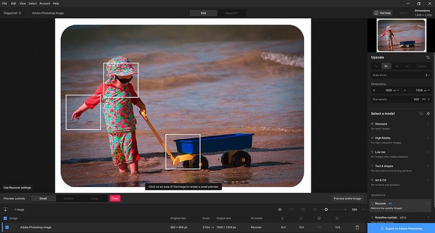

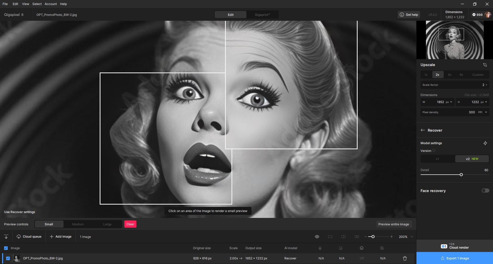

Thx for the update, Esther!

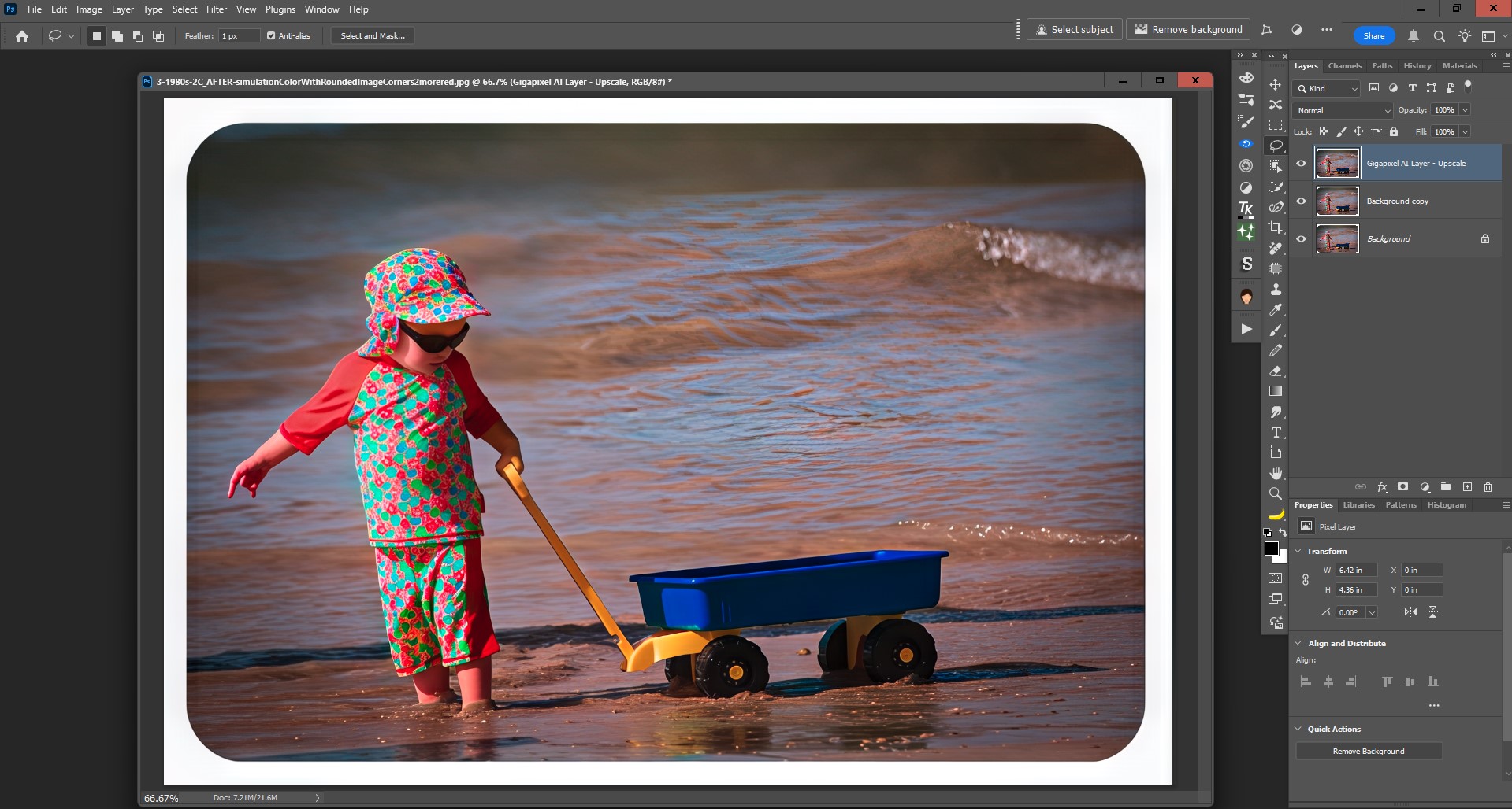

2 mins. to install. Launched okay standalone (didn’t test Ps plugin). Tried Recover.
Ps Plugin launched too (File > Automate). Also Recover (2x). Saved to Ps layer stack in just over 1 min.

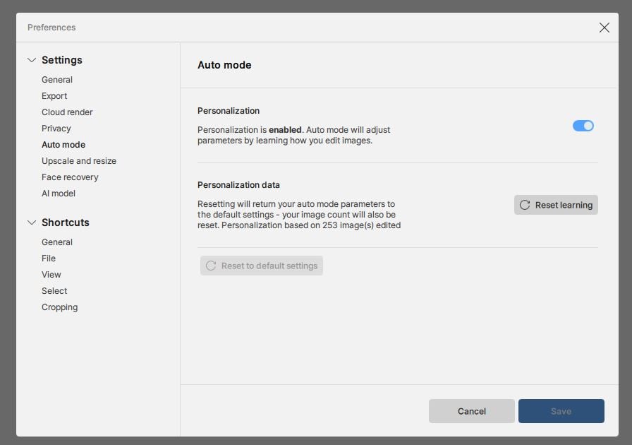

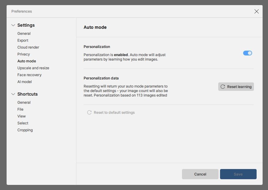

My first post was actually referring to the Auto mode setting for “Personalization” which says it will “learn how you edit images” and adjust parameters based on what you have done previously.
for my latest GPAI v8.4.2 release it says it’s using data from 113 previous images:
and for my current beta GPAI v8.4.0.2b it’s using previous data from 253 images
What is interesting is that it accumulates previous data when you upgrade to a new version but sometimes it drops quite a lot of data, because I have done way more images than the current numbers - possibly because the model options change and older learnt data isn’t relevant?
You can also reset previous data - which I have not tried.
For Personalization data - quite some time ago I asked Topaz to add options to include model settings OR to exclude them from “learnt data” because I don’t want experimental (extreme settings) to distort my “average” preferred setting - no apparent action from Topaz ?
I have also noticed that if you click the Thunderbolt icon and activate Auto mode, the render result seems to be subtly different from rendering without it clicked but using exactly the same individual settings … Of course it’s possible that I’m just seeing a small random difference between consecutive renders but I think it’s a systematic difference - and if I just try exactly repeated renders they look the same to me ?
