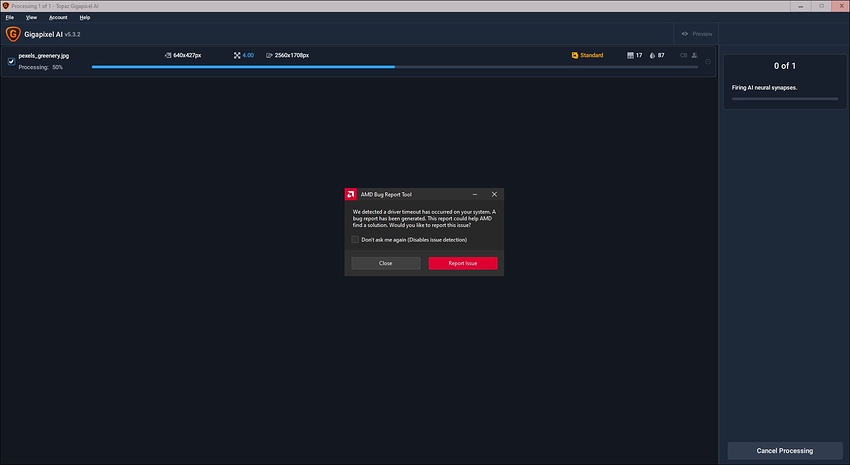

Gigapixel v5.3.2
@taylor.bishop
  • Win 10 Pro 64-bit PC. GAI Standalone & Ps 2021 Plugin for this version.
  • AMD Radeon Processor - see snip below for details.
  • Updated to most up-to-date Radeon driver in past 2-3 days, Taylor.

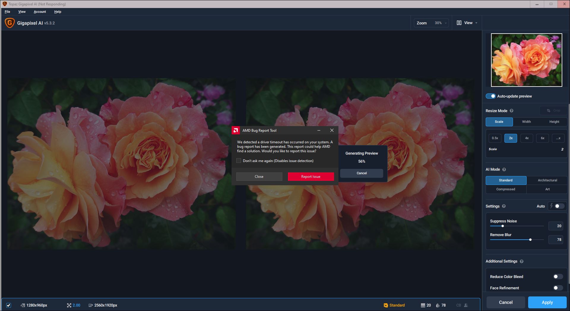

  • Experiencing GAI crash and AMD “Bug” msg box every single time I try to use GAI since AMD driver upgrade.
  • I have tried using GAI with GPU and OpenVino both = On. And, with GPU = On & OpenVino = Off. Same thing happens.
  • I’d never ever gotten this AMD error/“bug” message before this…
2020-12-16-14-40-10-Main.txt (94.4 KB) 2020-12-16-14-40-10-QML.txt (38.7 KB)

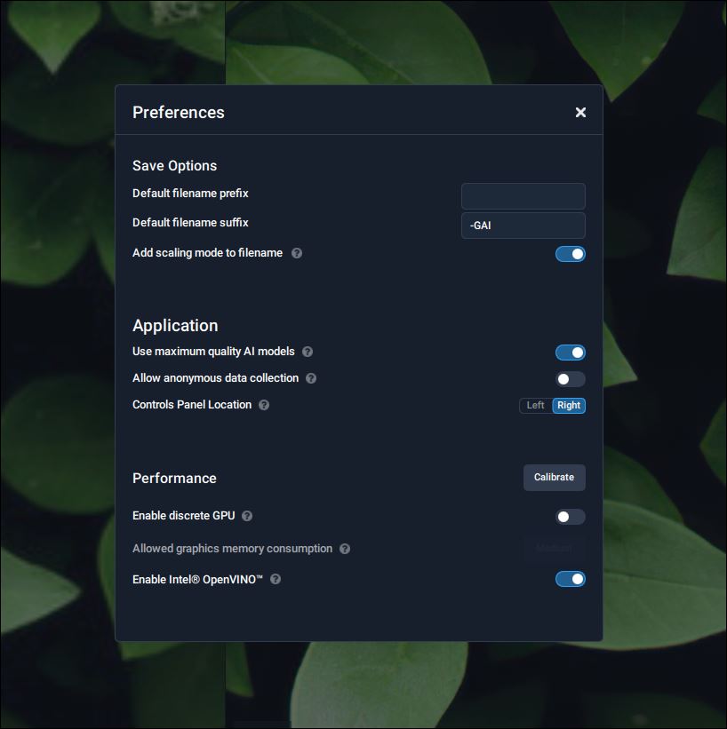

UPDATE @ 3:10pm (PST):
  • I just ran a Calibrate (using the GAI standalone vers,). It changed my Prefs to GPU = Off, OpenVino = On. With GPU off I didn’t get any crashing events. I tried a couple times. Hopefully the logs above will help figure out why GPU crashes post AMD Radeon driver update & didn’t prior to that using the same GAI rel.
  • Here are the current Prefs:
    Fotomaker_GAI532-Calibration-TurnedGPUOff%2COpenVinoON
  • With GPU turned off, so not crashing, Standalone vers processes relatively quickly. Plugin (Ps 2021) still lags and processes only in 7% increment hops.

For TDRs try doing a clean reinstall of the drivers and Adrenalin …
https://www.amd.com/en/support/kb/faq/gpu-800

Okay, I created a recovery pt., but then decided to do another set of runs b4 going thru the hassle of the driver, etc. reinstall
Here’s what happened (using this rel. on Win 10, standalone vers only):
GPU = On, OpenVino = On Resource Util = Medium GAI crashed/AMD Bug Msg Gen’d
GPU = On, OpenVino = Off Ditto Ditto
GPU = On, OpenVino = Off Resource Util = High Ditto
GPU = On, OpenVino = Off Resource Util = Low Image processed 15-20 mins.
(avg GPU % util varied from 60-100% throughout that run)
GPU = Off, OpenVino = On N/A Image processed faster than GPU
but still not fast.
I’m just going to leave the GAI prefs set to CPU and OpenVino & not mess around w/driver re-install based on the test/perf results. Typically the processing runs in the GAI Ps plugin are slower than the standalone. And I only work with the plugin b/c my entire image processing workflow is in Ps - I don’t want to be hopping in & out of misc external programs…
