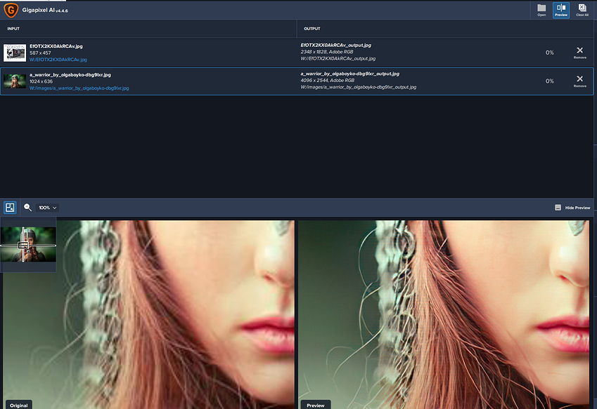

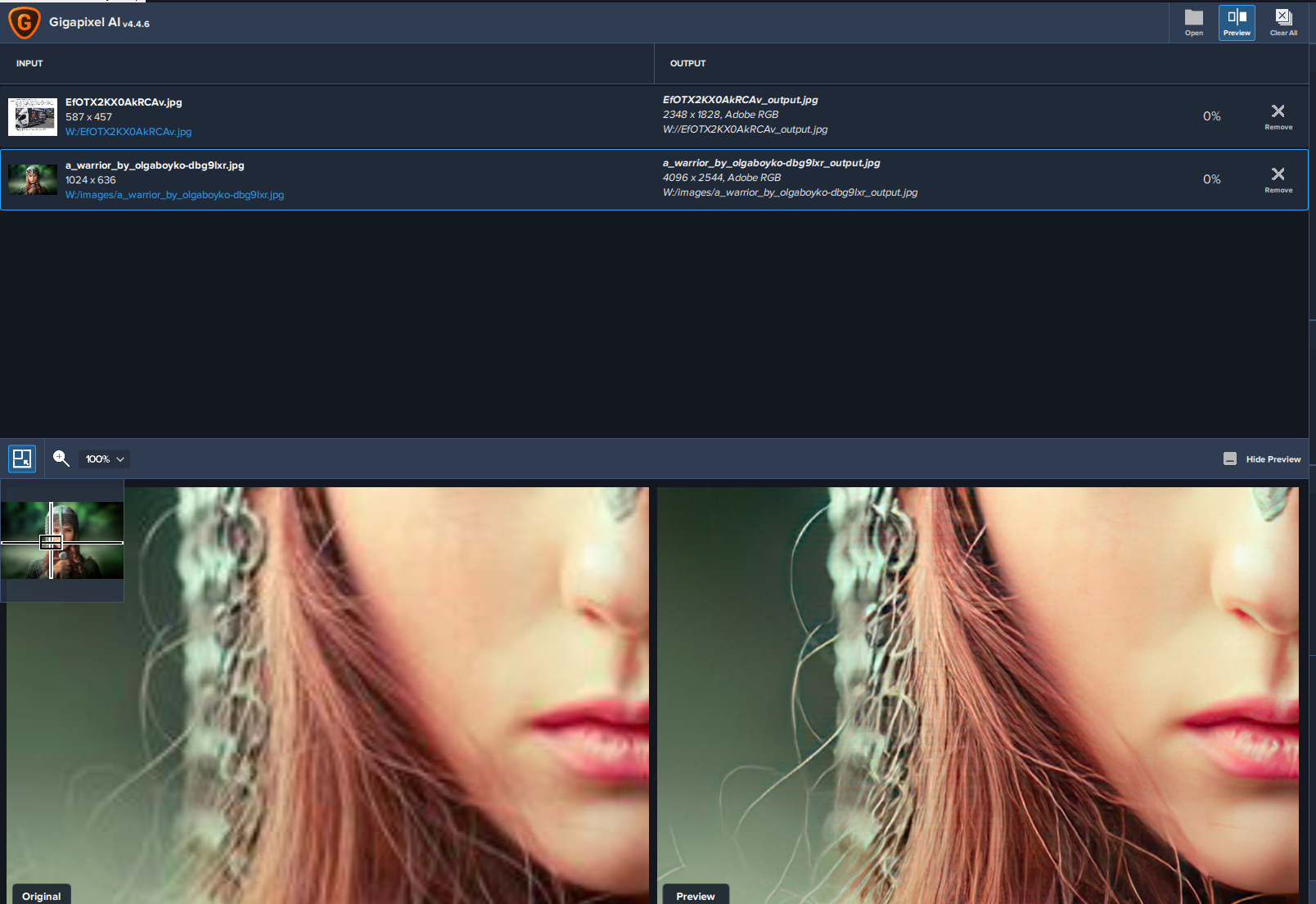

Hi, I have the same GAI GPU horizontal lines as mikmod1 on hair when up-scaling. CPU works fine although 200% slower then the 2080TI. To bulk fix GAI GPU upscale horizontal lines, I have to used Denoiser which adds additional processing time.

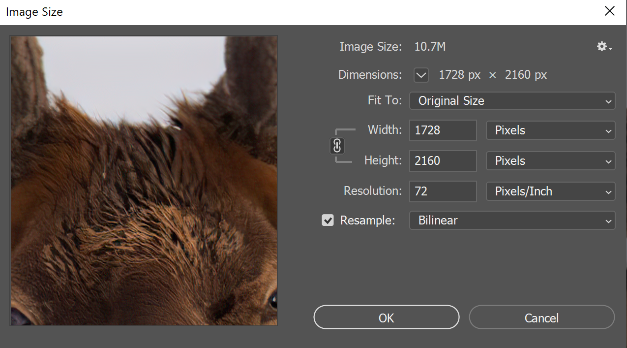

The output of the gigapixel plugin in photoshop cc 2020 is the wrong size.
I set height to 2160 pix and everything looks right, but going back to photoshop
the picture has a different height.
If I change the setting and go back to it, I can get it to work,
Could you upload the image this happens with here?

You mentioned (or one of the devs did) that GAI uses OpenGL (yup, this, not OpenCL) to calculate stuff, could it be some shortcuts made specifically for GPU calculations (could they be less precise?) or OGL specifications quirks?
Edit: GAI 4.4.6 also has that bug, if it helps with digging in search for a cause:

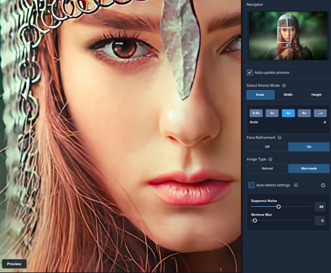

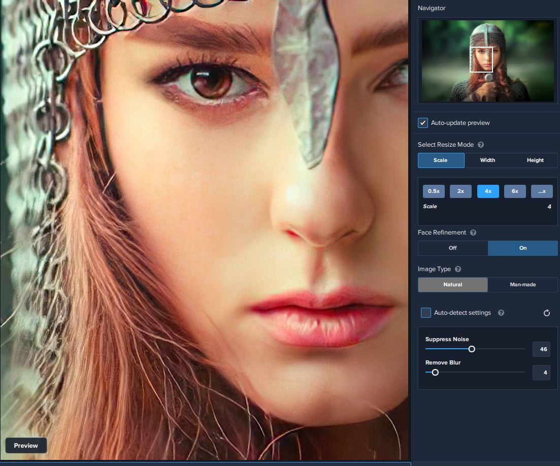

I’m on a win 10 PC v2004 with a Radeon 5600 XT GPU. I also get the lines but only with Max Q = on and Natural mode. With Max Q off + Natural or Max Q On + Man Made there are no lines. Examples below at 4X.
Max Q on + Natural. see lines
Max Q On + Man Made No Lines
Max Q off + Natural No Lines

Got the image - could you tell me what height it gets set to in Photoshop after processing? I’m unable to replicate this issue unfortunately. When setting it to 2160px in Gigapixel and saving it to return to Photoshop, this is the result for me:
