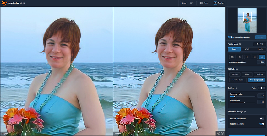

Gigapixel 4x 4x Crop: (Face Refinement OFF):
Gigapixel 4x 4x Crop: (Face Refinement ON):

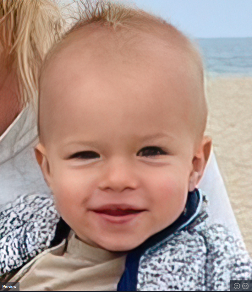

Faces are only one part of the photo and thins kind of photos are in database since everyone uploads this photos now. But if you look at the shirt and pattern on the blue shirt, looks very problematic. Now try to use the same program with landscape and high frequency details of trees and grass? Or try it on less easy to find images, such as paintings with patterns or brush strokes. Try line art. Try hair details. Try fur. Try many scenarios. The front facing classical phone shot of someones face is the more frequently uploaded image online, do to smartphone photography. So naturally that is easiest to train. But the other stuff is important too, especially for professional work. So is privacy.
I donât know if it can be processed locally but for such good results a cloud based system would be acceptable. I suspect it is using cloud based AI at present. I donât think the shirt is problematic considering the starting point. Below is a clip using Gigapixel 6X enlargement starting from the whole original picture instead of just the babyâs face. It did a reasonable job but still soft.
I agree that other pictures need to be looked at but peopleâs faces are usually the weak point in Gigapixel. There could be a way of using Remini for faces (there is a button for face refinement now) while other parts of the photo use the present GP AI.
