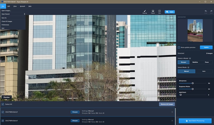

I am still having a bit of an issue getting my head around this… very confused. I think Sharpen AI batch processing is not working as I think it should… It definitely is behaving differently than DeNoise batch processing.
In short, when I select multiple images in LR, no matter which “what to edit” option I select, the same thing happens: When I click “Start Bach Processing” in Sharpen AI, it does not take me back to LR when it completes, but creates a new file. Then, I have to close the program “X”, and the file back in LR does not have the sharpening applied (no sharpening is applied no matter what Edit option I select when I invoke Sharpen AI).
What am I doing wrong?
BTW, if I just select one RAW for Sharpen AI, it works fine… takes me back to LR automatically, does not create a second TIFF, and the sharpening is applied to the TIFF in LR… all good. It appears I am doing something really wrong with batch processing.

  • I edit the RAW (it creates a TIFF copy), then a second TIFF when “Start Batch Processing” , or
  • I edit original TIFF (the output from DeNoise)… same, it then creates a new TIFF when “Start Batch Processing”
DeNoise does not work this way at all… when I click “Start Batch Processing”, it send me automatically back to LR and the de-noise edits are present in the TIFF… Good!

Yes you are right, Sharpen AI doesn’t open in “plugin” mode as DeNoise AI does. It should act in the same way as DeNoise does.
Please raise a support request at the main website, the link is:
@amy.mae could look at this
Thanx… I submitted a ticket.
