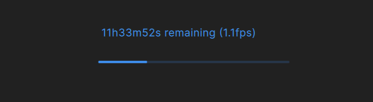

FPS estimate and Remaining Time inaccurate for NYX XL model
10 hr 57min 5s render time for 4min 19s of video at 59.94 fps.
The program is quoting a speed of 1.2 fps however, basic math says otherwise:
259 seconds of video x 59.94 fps = 15,524 frames.
15,524 / 39420 seconds (total render time) = .394 fps
Screenshot 2025-12-18 115019
Windows 11 Topaz video v1.0.4
