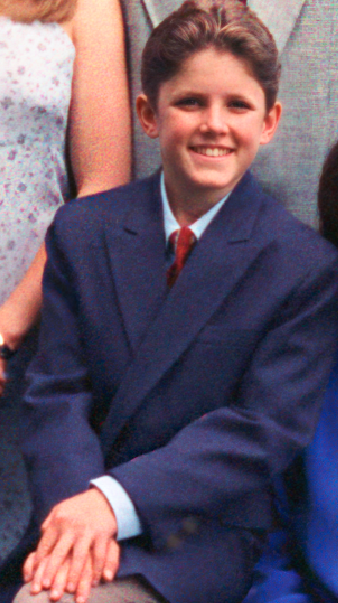

In my trials I can see some dust and scratches (white specs and lines) fixed, some others ignored, and some inappropriately accentuated. The tool within the module to stroke additional spots/lines doesn’t seem to result in additional repairs; my trying is ignored. Example attached (4380x3200 pixels). The interface to submit here seems to have reduced it to 850x620.

I can see a little bit of dust and scratch repairs, but even with stroking a few additional spots within the tool I don’t see as much improved as I would expect.
As blurry as my original is, the face and hair improvements are amazingly good. Thanks, TopazLabs!
@rberke - Thanks, as this is the first release of this tool, make sure to send the original and current results you get, with the list of what you wish the tool would do, to support@topazlabs.com and we can relay to the development team to help make the tool better over time! For this file, I would crop out the white thick edge and solely focus on the picture part, the outside edge would take a lot of manual work to restore, in another program such as Photoshop.

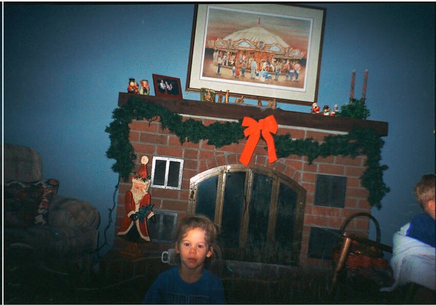

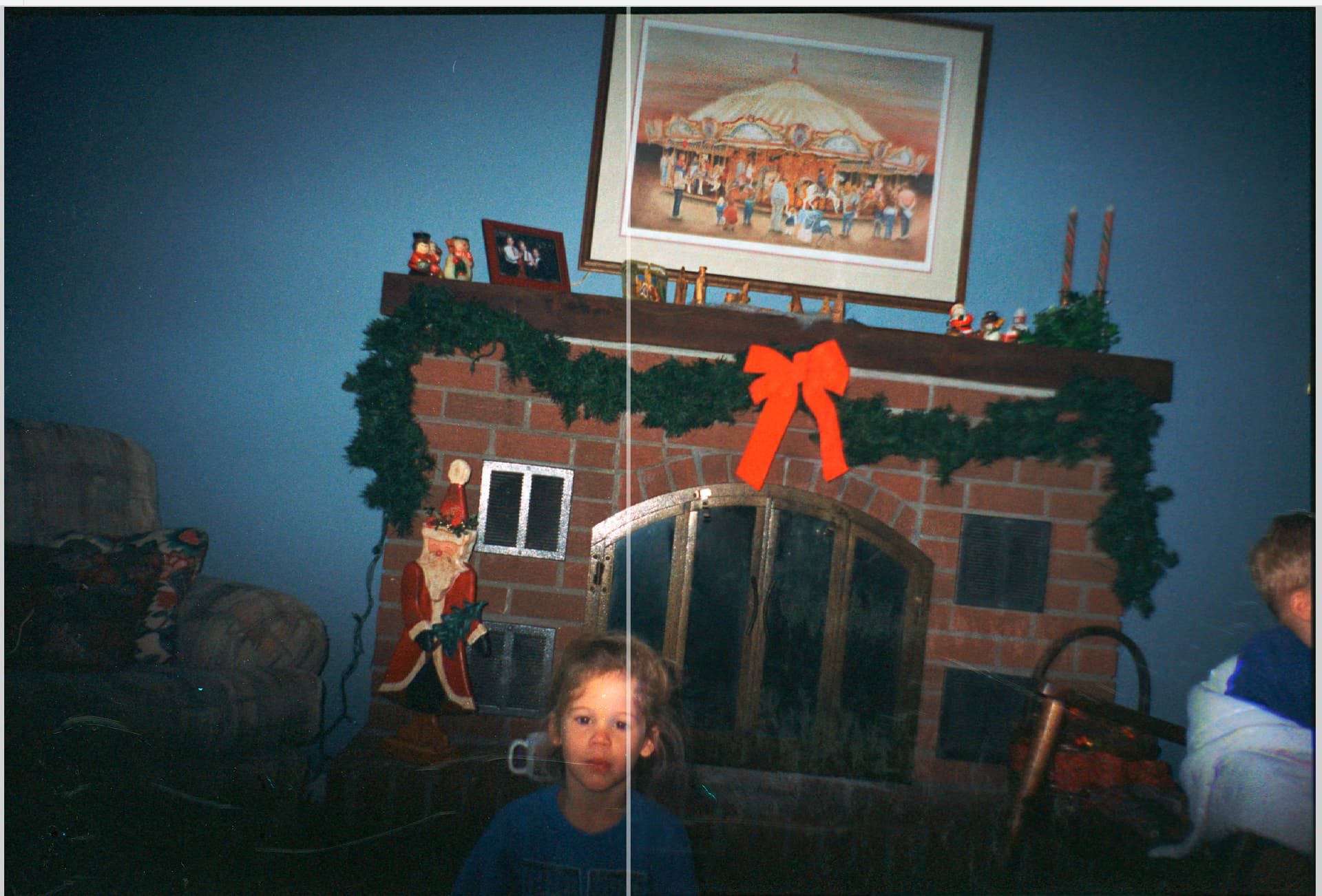

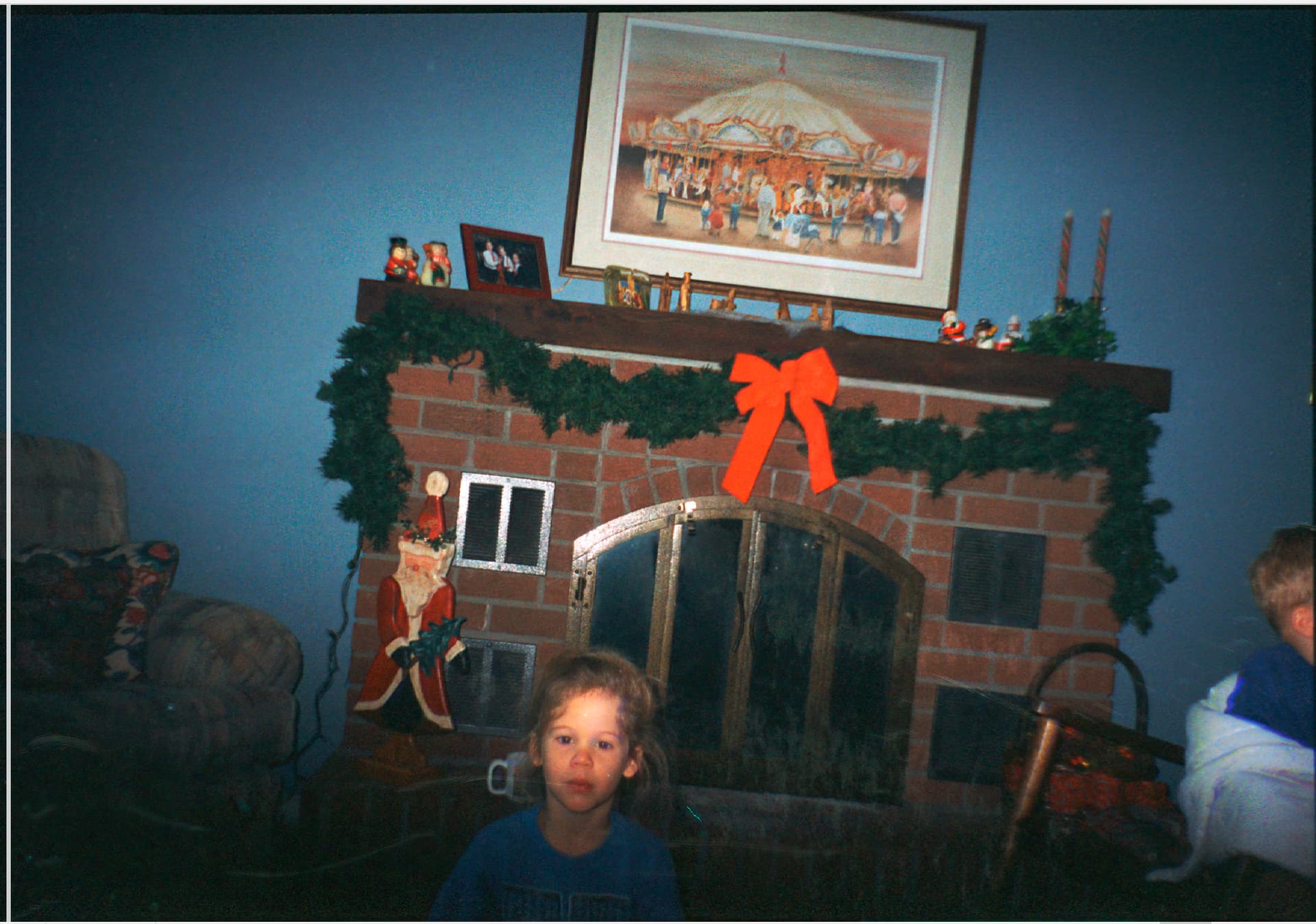

    I’ve attached a photo to see what I"m on about. Also I’d be willing to donate some of my old photographic negatives that I’ve scanned to help train the AI better.

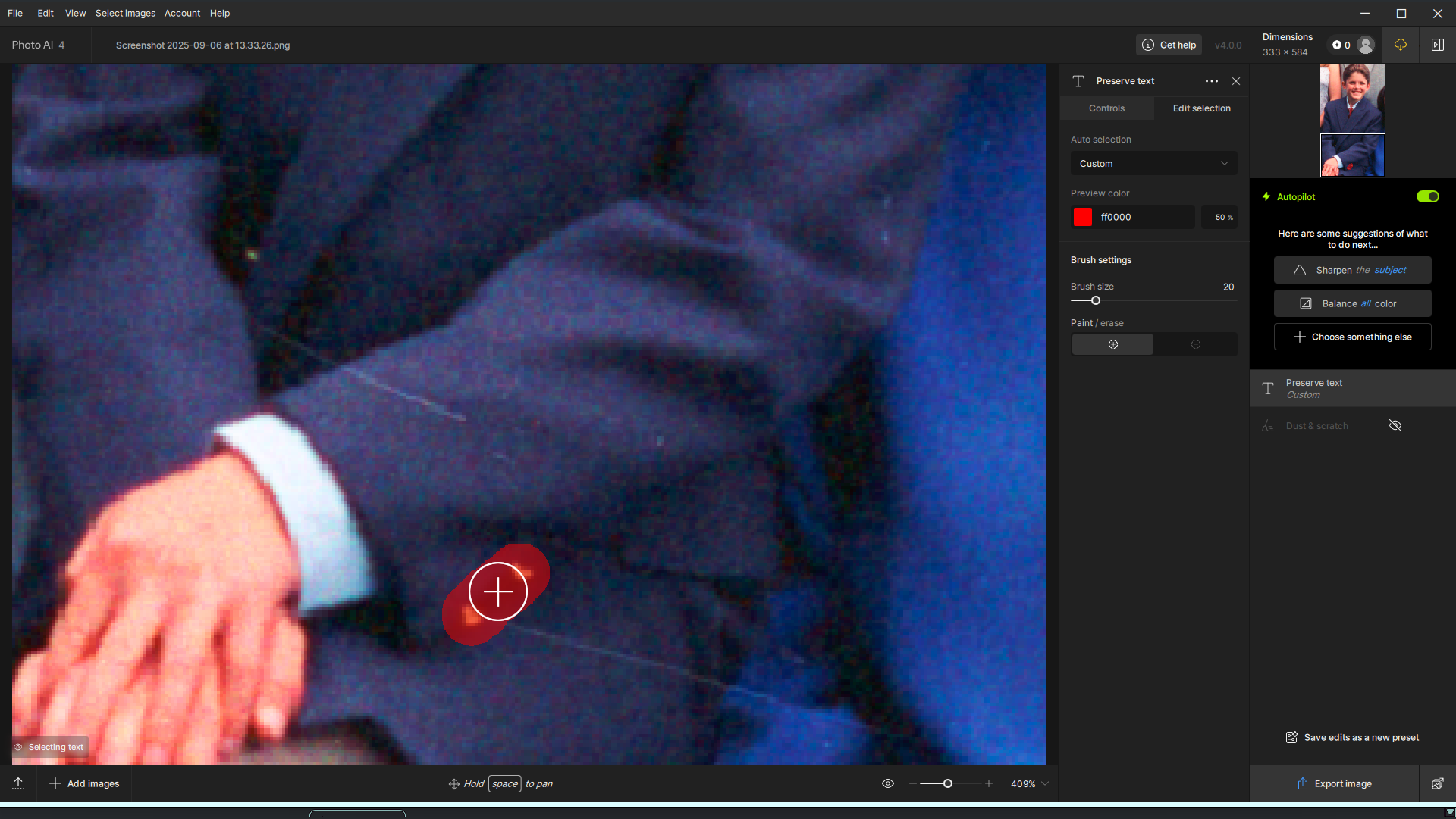

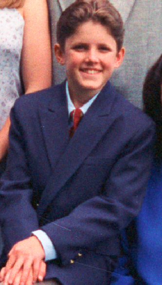

So just wanted to report an error and a potential workaround. I ended up using dust and scratches, but it blurred some buttons on a shirt. I’ve included the before and after. It would be nice if there was an ‘undo’ button ie after the dust and scratch removal, there was a way to select an area and it removes the dust and scratches. I’ve included the logs.

Hello Musterion87
There is a simple workaround for your problem at present, that is in affect an undo button of sorts.
First run Dust and Scratch as per normal. Then disable the Dust and Scratch by clicking on the Eye icon. Then select Preserve Text, Custom and paint in a mask as shown in the picture below. Then re-enable Dust and Scratch and the buttons reappear.
Regards Robert.
