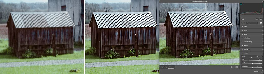

I’ve just tried out Superfocus BETA on this image (scanned from 35mm slides taken in the 1970s) It’s great, we’ve created some realistic focus here but still too “plasticy” for the archiving purposes I need it for. So my “fix” is to take the image into Photoshops Camera RAW filter and add grain there- see attachment. It’s by way of tricking/soothing the eye into believing this was a photo of the age, and the added grain gives it a sense of authenticity. I recognize some people think grain is noise that needs to be eliminated but it also harmonizes the image when there is artificial or noticeable smoothing and sharpening so I feel it would be worthy feature to Photo AI. I would want more control, for instance to dial back the effect in highlights and shadows and concentrate the effect mainly in the mid tones.
