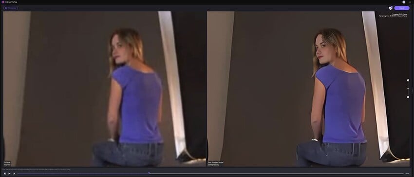

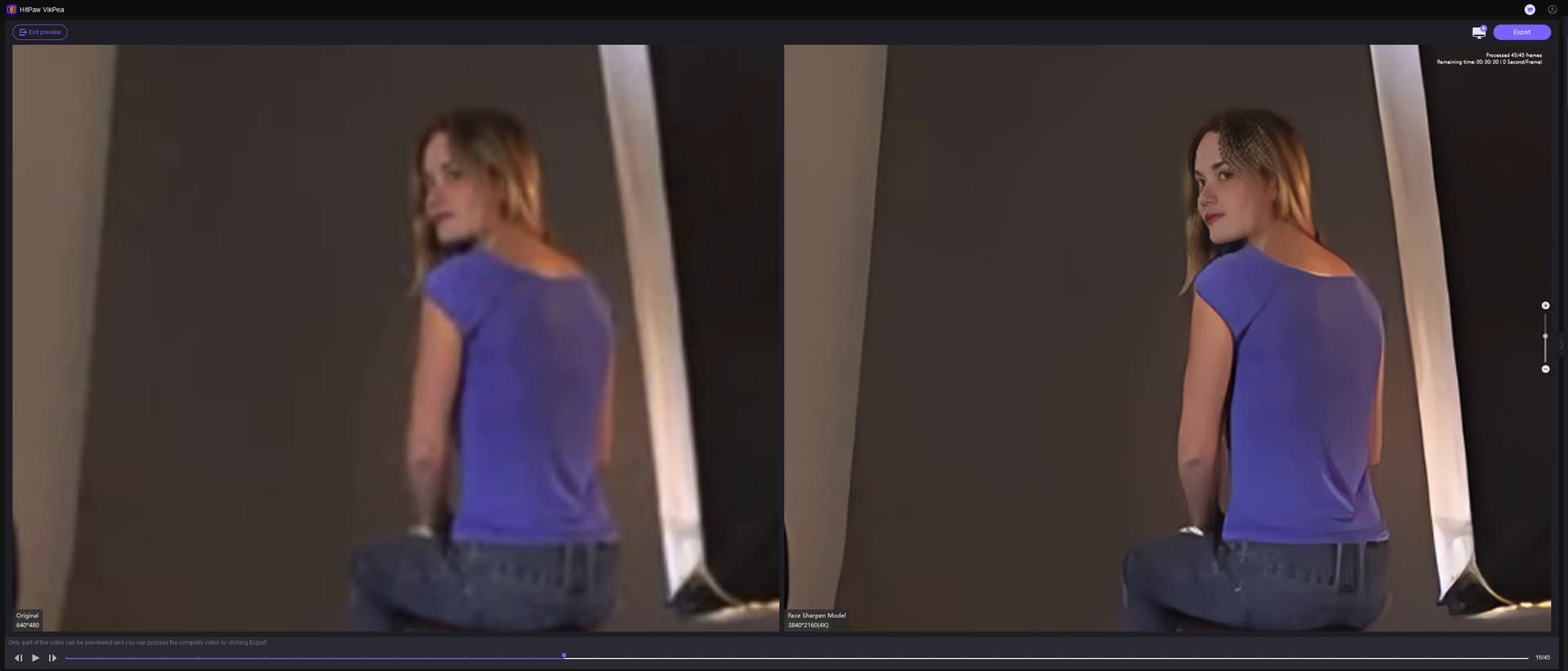

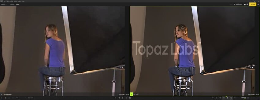

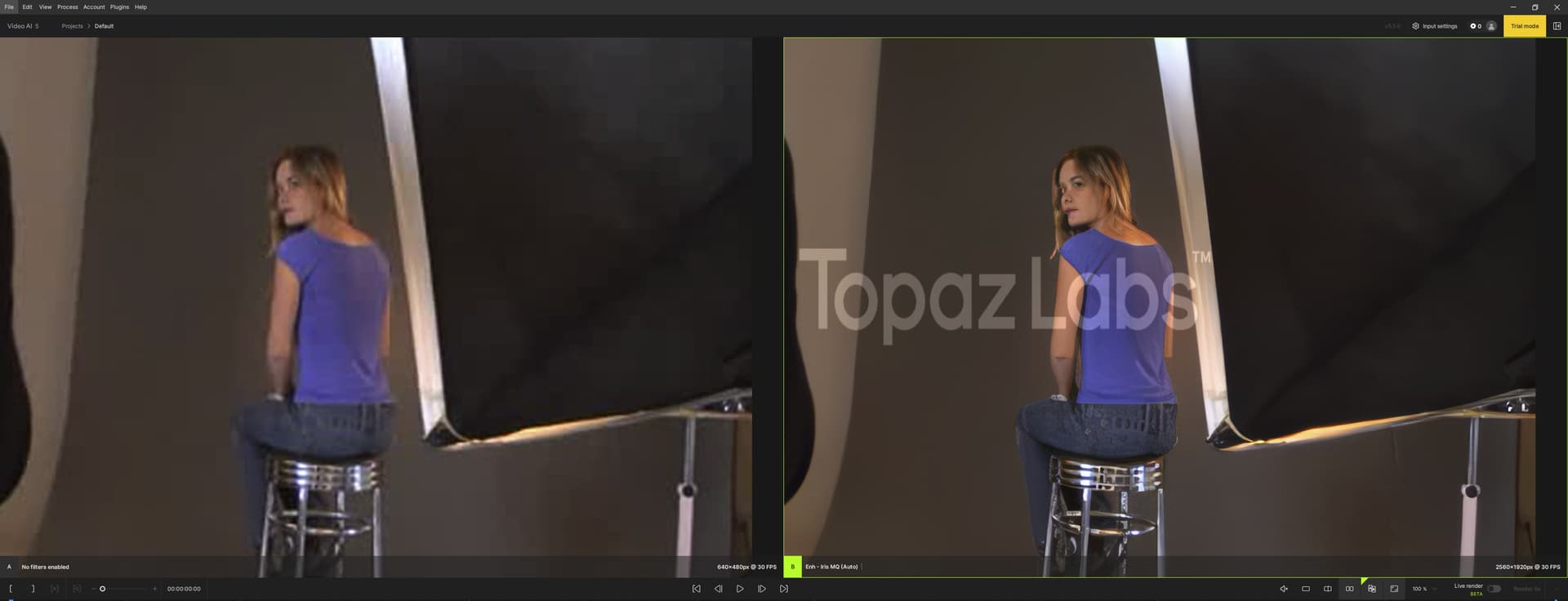

I second this. Topaz needs to catch up to other upscalers like AVCLabs or Hitpaw Video Enhancer in the face upscaling model ASAP! When I compare them side by side that can upscale the faces beautifully while Topaz Iris is distorting the faces into a crazy level. When I run AVCLabs or Hitpaw Video Enhancer first and then only Topaz Video AI after the faces stay beautifully rendered and even improved inTopaz Video AI Iris. It blows my mind how this is not a TOP priority and how Topaz can be this much behind when it comes to faces
Hi Sir!
Can you show screen? and is those two other better than Topaz new Rhea model?
/Topaz 4 user.
Hello Sir, I took some screenshots for comparison.
Of course I don’t say the other solutions are perfect by any means but I think it is clear as day that Topaz is behind in the face upscaling department:
Thank you! AVC is pretty cool here. If iris fails i often run Gaia with some grain, it doesn’t play too many tricks.
